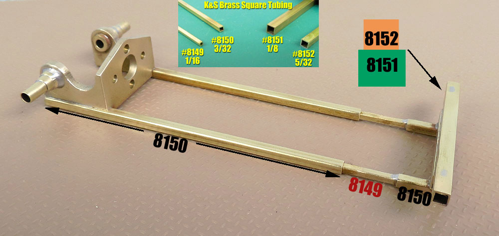

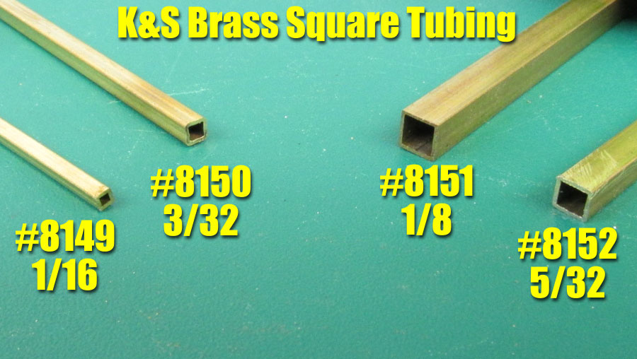

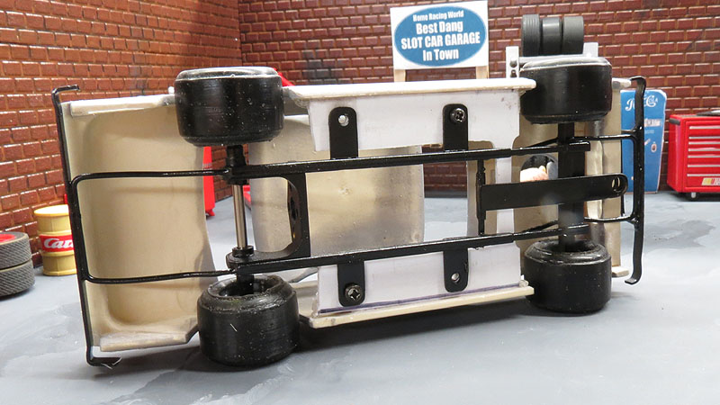

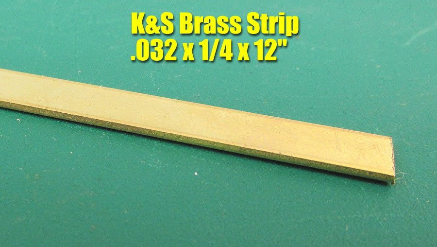

I use the square tubing for my frame rails and to create an adjustable chassis.

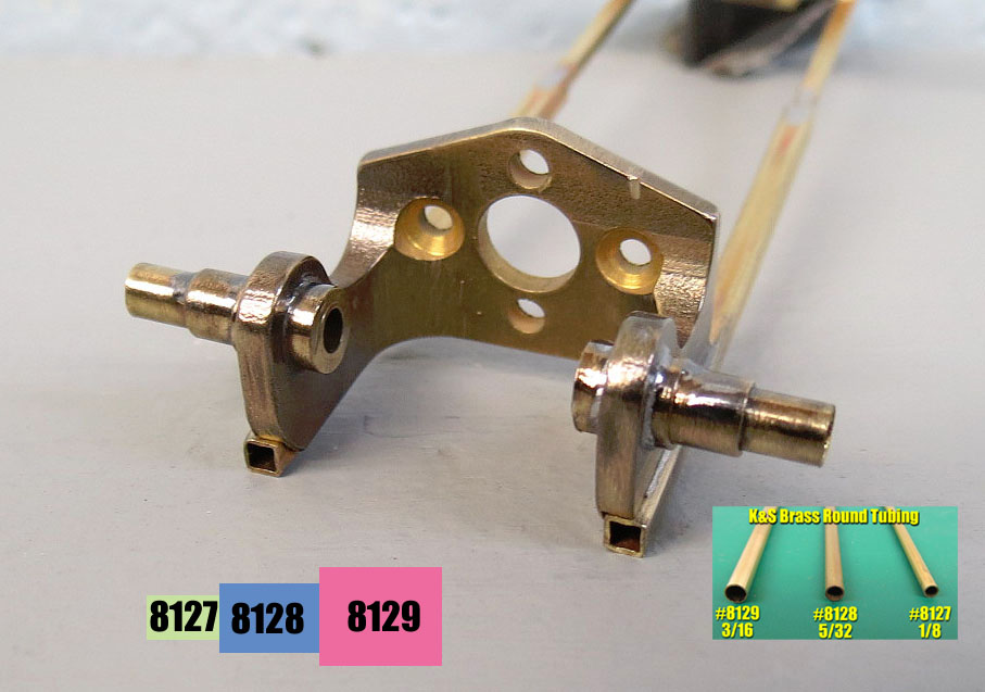

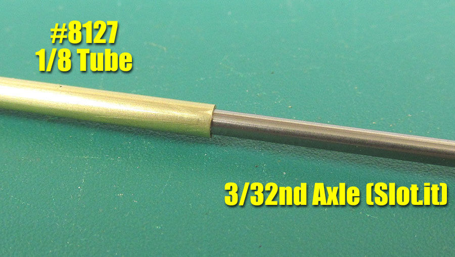

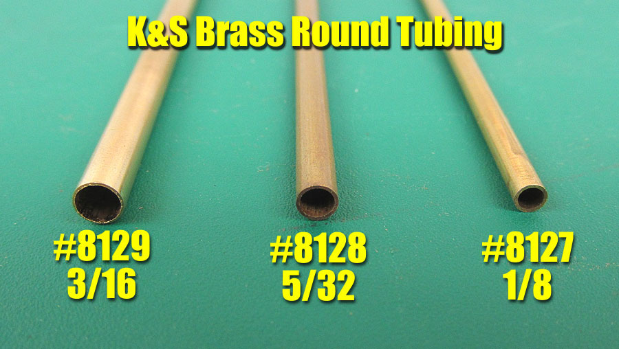

Instead of bushings I use a "Tri-Tube"method for my front and rear axles. They slip into each other with the last tube being cut to the length I want to set the side to side distance.
I use this strip to fabricate my guide tongue and body mounts.
Example of the Tri-Tube method.

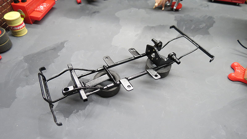

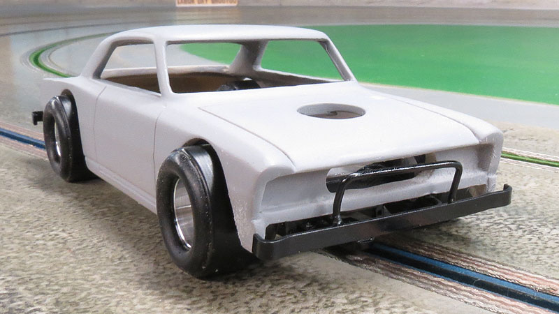

Various Stages Of Build
Chassis finished.
Wheels and Tires Used.
Chassis fully completed.

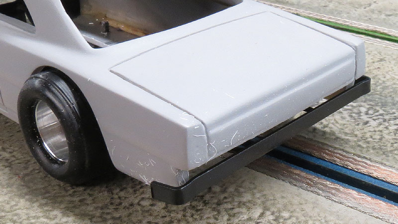

Model was finished with Krylon for paint and SLIXX decals from assorted sheets. I used Pledge Floor Care (Future) for the clear coat.
The boss in the shop thinks it will be good enough to race.
This is a great kit. Although I used it for an entirely different purpose, it's great to have one more model to create a oval racer from.
