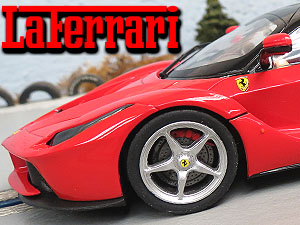

Overall fit and finish is about as good as it gets. The shine on this car is one I wish all of my models had and is clean and even throughout.

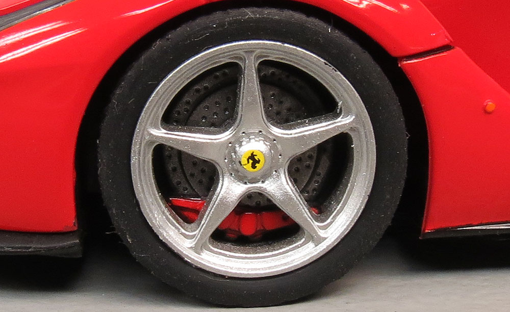

The detail level is pretty impressive for a street car. I showed it to several people and comments about the looks, especially the visible engine detail, were very positive. I think it is impressive because we need to remember that the price point on this model is around $35.00. Carrera puts more into the detail level than I am seeing in other brands that cost a lot more.
Although the tread pattern is nice to see it won't mean much to those who actually want to race it. Still I have to give credit where it is due for the extra effort. The visible brake rotor and caliper detail always makes a slot car look better and it is very pronounced on this one.

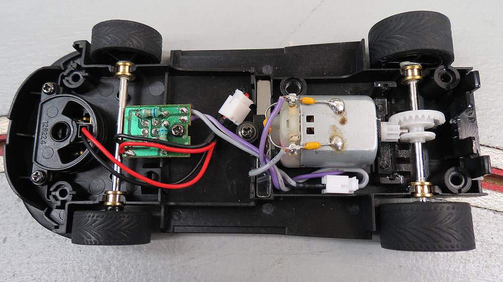

Removing the 4 screws that mounts the body we see standard Carrera components. The polarity (direction) switch, E200 motor with 9 tooth pinion that drives the 27 tooth crown gear and dual bar magnet system.

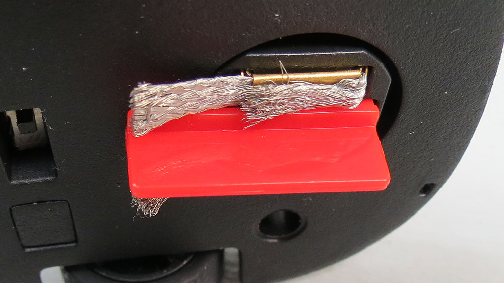

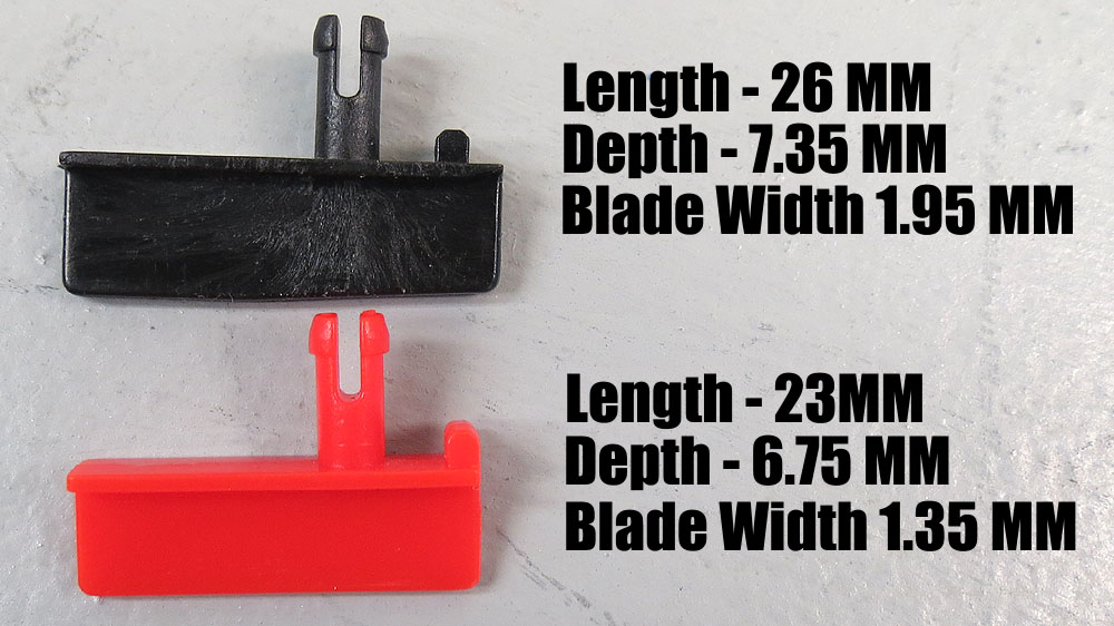

But the REAL added plus is the new guide blade. This blade is designed so the car can be quickly changed to be compatible with other track systems. This has been a source of complaints in years past for some and now Carrera has delivered.
This just adds even more value. Carrera deserves credit for starting to include these in newer releases. Again you might not think this is a big deal, but I do. Veteran enthusiasts always wonder if our slot car makers actually listen to us. Well here is proof that one certainly does.
The guide blade can be pulled out and the new blade installed easily. A pair of needle nose pliers are your best choice to accomplish this.
These new blades should be in all new models. The latest Porsche has it as well.

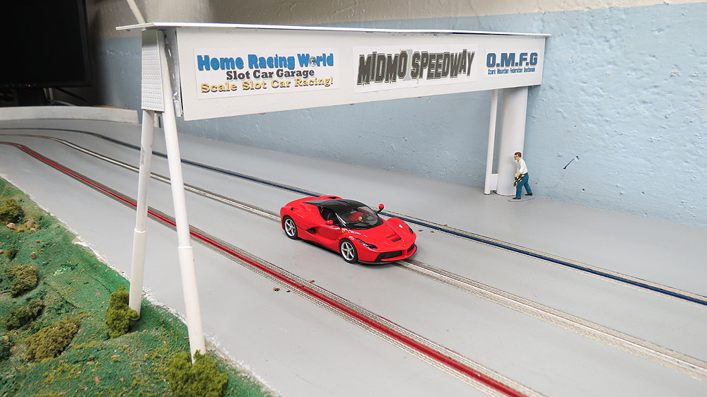

Operation of this car was very pleasing right from the box, even on our wood track. I had a friend over to give it a try and he could not believe the car ran as good as it did with no modifications. There was only a slight chatter in the corners, otherwise this car told us we had a great platform to tune with.
Newcomers and plastic track owners should enjoy it as well. Carrera models that have these dual magnets really hug the track and provide some fast action.
