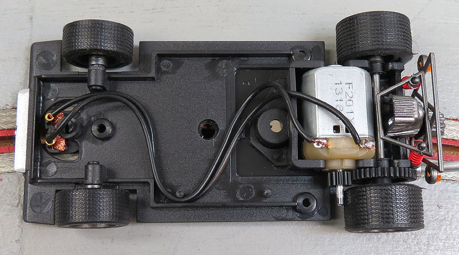

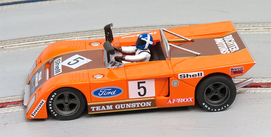

Testing this car ended up being a welcome surprise. It ran a lot smoother than expected and that told me we have a good car that will only get better with just a little tuning.

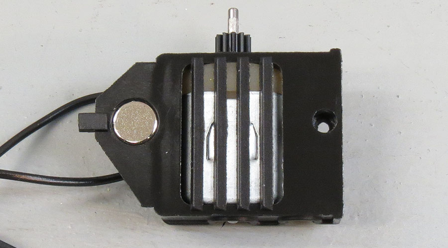

On plastic track, the button magnet really pins it down but not it's not excessive. The only problem with this thick button magnet is that when you push it too hard and it does finally let go? It goes. Most times HARD. Remember that mirror I talked about? I think you get the idea.
But magnet or non-magnet, this car is FUN. Fun to look at, fun to race, fun to tune. Always has been, always will be.

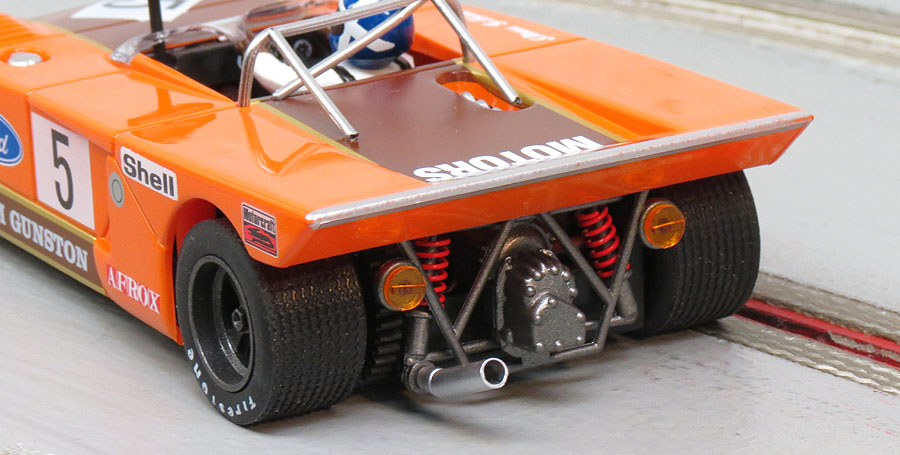

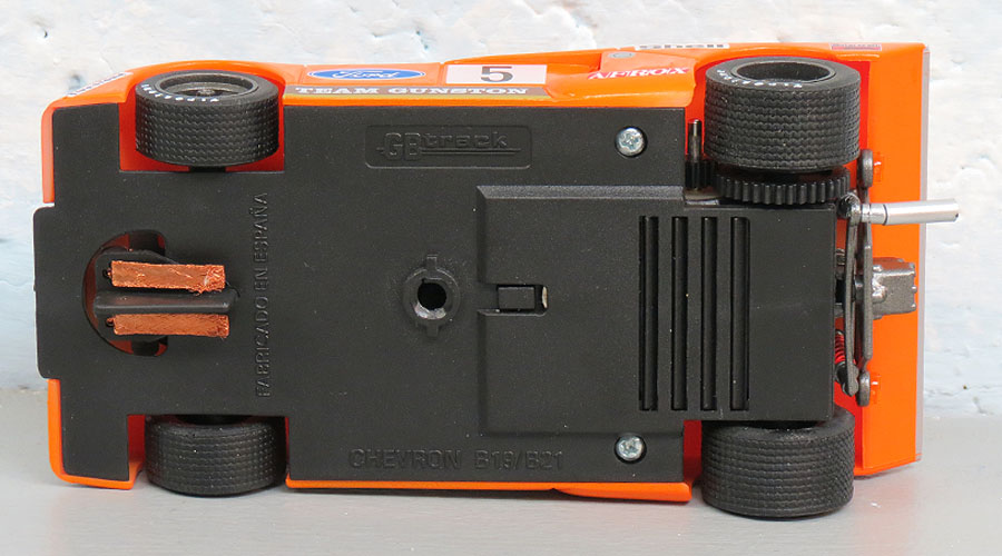

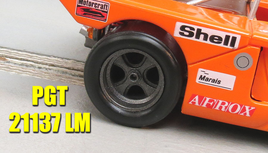

And tuning this car today is a LOT easier. Back in 2001 we didn't have all the parts available like we do now, especially in the tire department. I installed the new Paul Gage PGT-21137 LM tire and it fit perfectly. You might need to lightly sand the inside sidewall to clear the chassis, but that is no issue.
You could go with a lower profile tire using the PGT - 20137 LM if you wanted to start out lower. However, I like the 21 size tires. In the photo you can just see the raised lip of the tire, this is perfect as I can now sand/profile the tire to my liking without losing the diameter I want.
