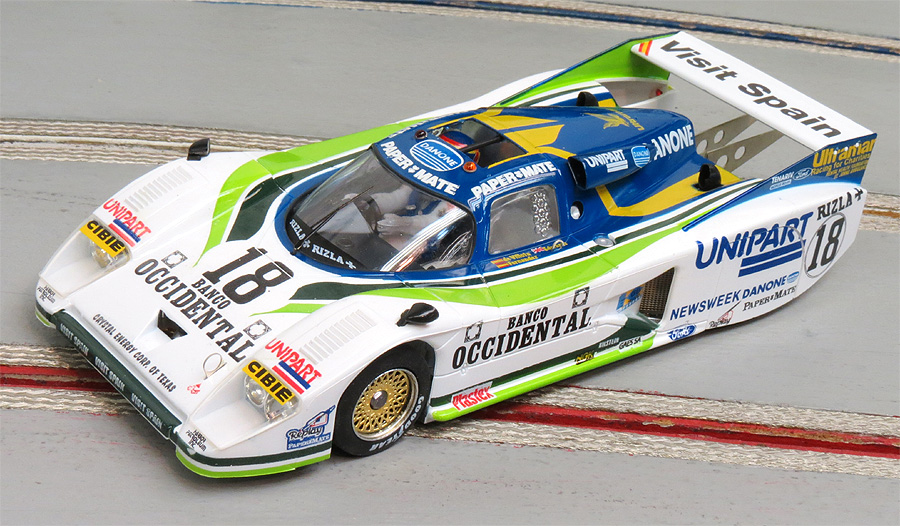

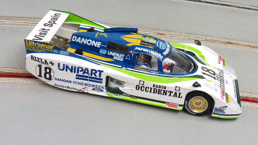

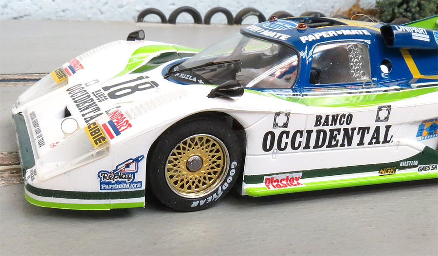

Today SRC brings it back in 1/32nd scale. And on the outside I think they did a very good job of capturing it in our scale.
Paint work is acceptable and has a nice enough finished look overall. Plenty of detail level to enjoy that should please most of you. They are not afraid of using etched metal as the rear wing, air inlets, and even the wheel inserts utilize it.

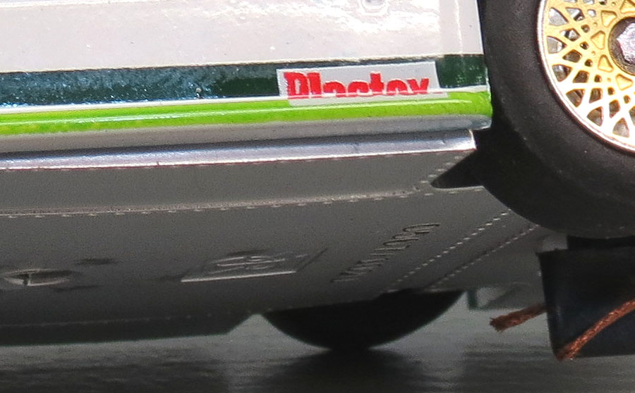

But one of the first things I noticed was that the chassis did not seem to fit the body very well. You can clearly see a slight bend in it and this is not going to please many of you. I accept that some flaws will be present on models such as this, but most times I expect them to be concentrated in the running gear department. However, most collectors who are buying it to sit it on a shelf or to re-sell it later on will not be very concerned. Of course the question really is: Does it matter to you?

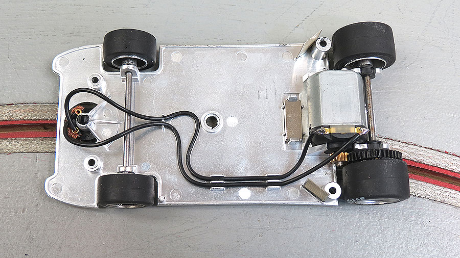

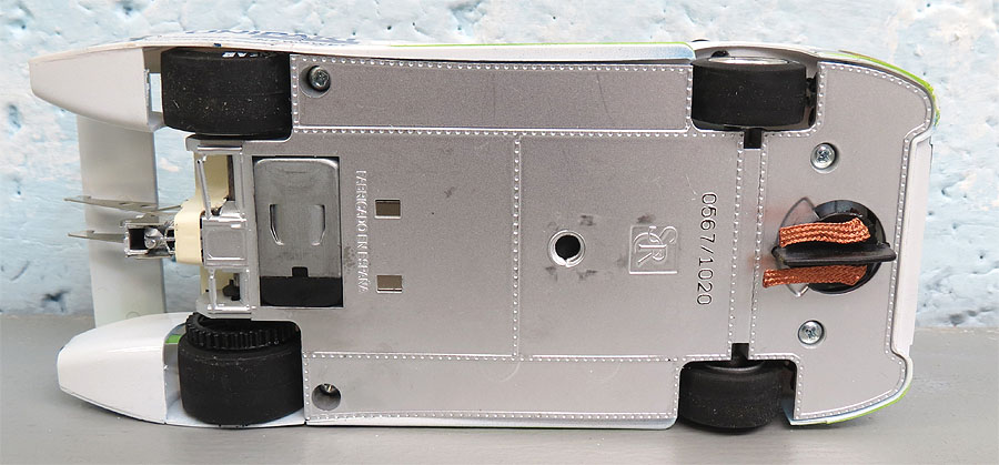

Looking underneath I found no surprises. The car is sidewinder configuration with a smaller bar magnet mounted just in front of the motor.

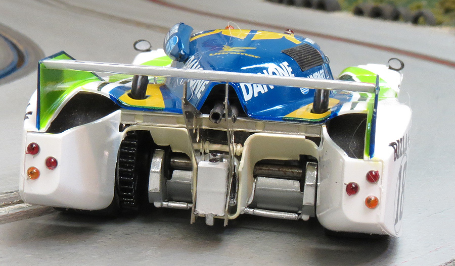

Removing the 4 screws that mount the body to the chassis we get the closer view. Very basic and simple. The motor has an 11 tooth pinion that turns a 36 tooth spur gear. There is excess free-play in the rear axle that is going to cause rubbing issues I am certain and will have to be addressed.

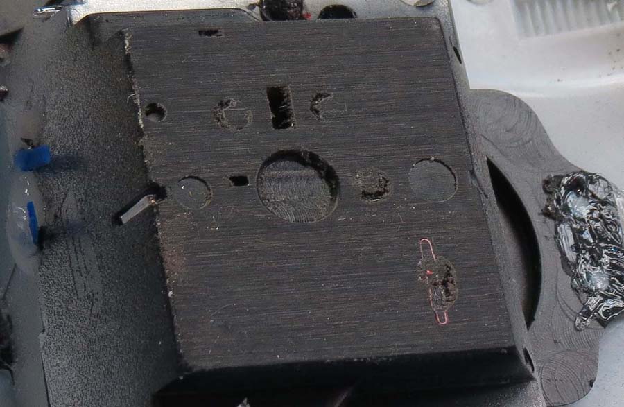

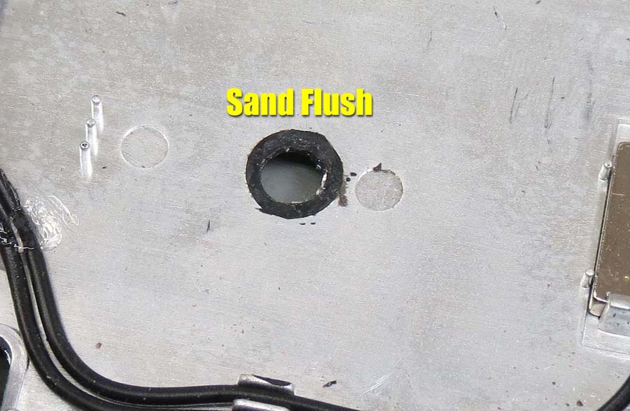

Initial testing of the model was not very good. The binding in the chassis really created a loud and overall unpleasant sound from the gears as well as some of the tire to fender skirt rubbing I mentioned. So while I had the body off, I looked to see what was causing it. It appeared that the bottom of the interior is rubbing the mounting hole. I quickly sanded this flush as shown above.
I also noticed a fair amount of flash molding from the interior bottom. I removed the interior by grinding the post-melt mounts away and then sanded the entire bottom to clean it up.

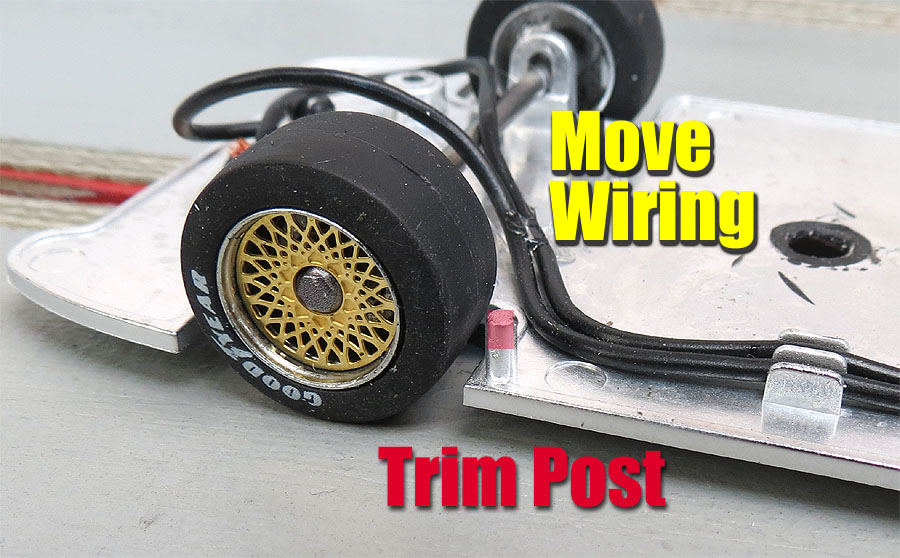

Test fitting revealed the wires were still interfering as well as a lone post on the left side. There is no good reason that I can think of to have this post. It hits the bottom of the interior and causes the chassis to bend. I trimmed it down as shown above. I also routed the wires away to the left. This finally allowed to body to fit the chassis cleanly.

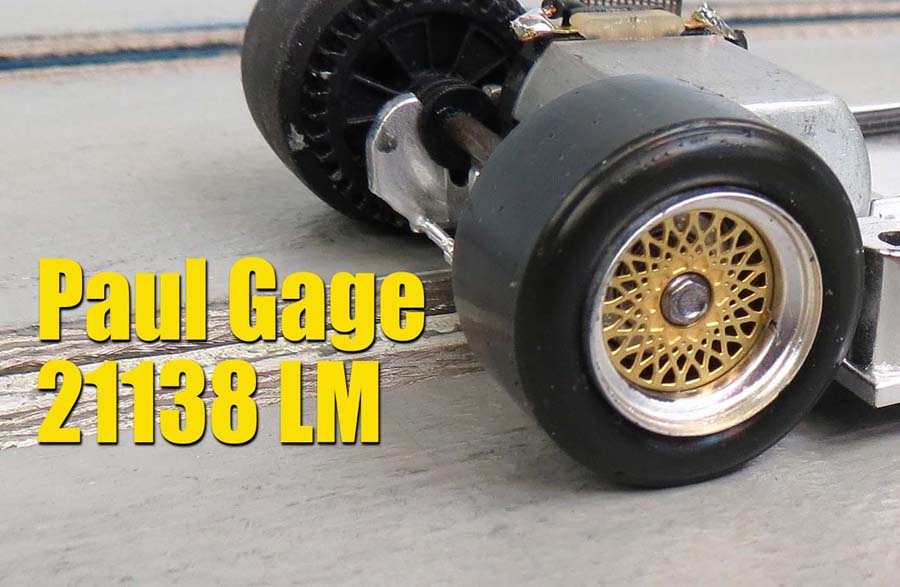

Finally I test fit some Paul Gage tires. 21138 LM is the tire for this model and they fit perfectly. You will need some sanding but just changing them goes a long way in performance as the stock tires are hard and not really suited for non-magnet racing.
