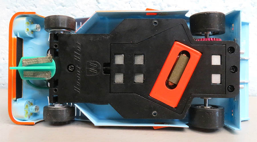

2 screws mount the body to the chassis, one in front and one in the rear. Once removed we get down to business. You can see this is an anglewinder configuration with a floating pod design.
One of the first things that might grab your attention when you open up this model is the amount of magnets included. Anyone racing with magnets should be very happy. Although I do not race with them, I find it pleasing to see this many included. This allows those who do more tuning options without added expense. The magnets are not the strongest ones on the market though, so the downforce isn't as strong as you might think. But rest assured they will accomplish the mission. Another item worth highlighting is these magnets sit very loose in the pockets. If you race non-mag on wood you will want to lose them and use lead instead. Leaving them as is will result in a very annoying rattling sound.

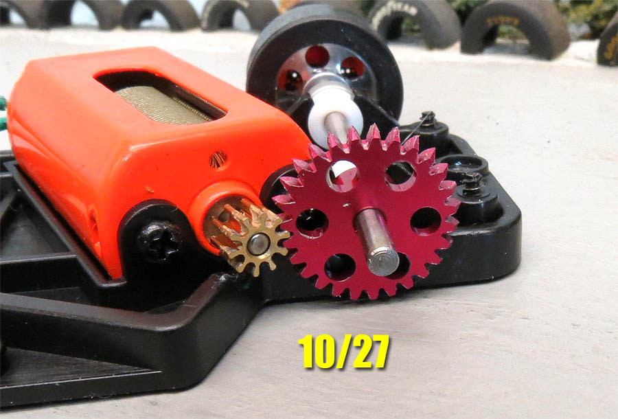

The motor in this car is called the "Hurricane" and is rated at 27,000 RPMs @14.8 volts. I tested the motor using a laser checker and it runs around 22,000 @ 12 volts. Much more than I will need for our smaller track. But that is fine as I change motors in a lot of cars to suit my taste.
One rather odd decision on Avant Slot's part was to use nylon bushings instead of brass/bronze. The axle to bushing fit is fair but there is still some slight free play and at the high speeds this model is designed for you will want to replace them with better fitting machined brass. It could be a cost cutting measure but if so, I feel this was the wrong area. All this technology in the chassis, wheels, and gears is only going to deliver so much if the bushings are causing vibration.
Gearing is 10/27 and the mesh is pretty smooth for out of the box. The motor is held in place with 2 screws and this does the job well enough.

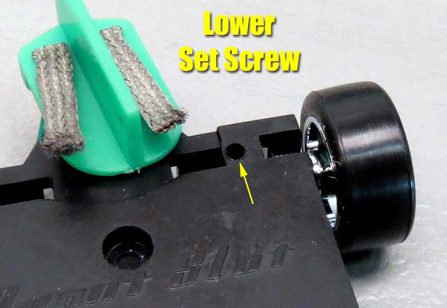

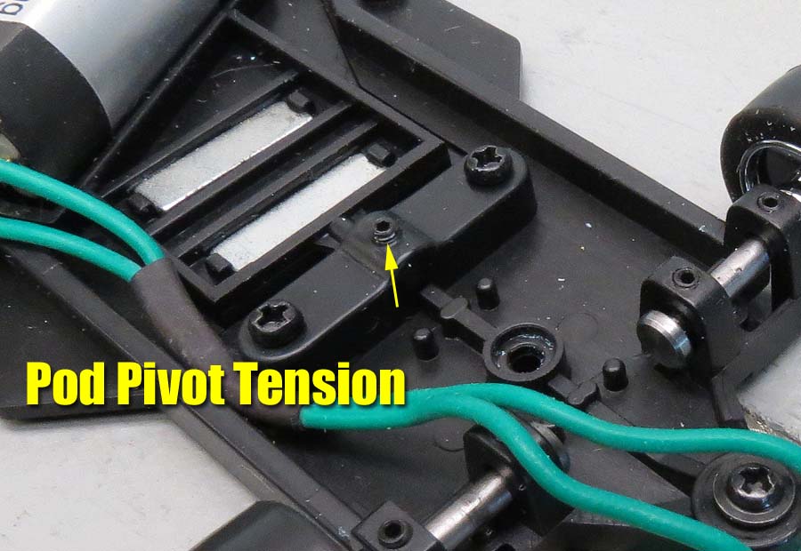

Up front we see the first set screw that controls the front movement of the pod. Pretty self-explanatory. Again, the guide that comes with the car tells you all about it. Adjusting this and the 2 rear pod screws allows you to set the desired float of the pod. The only drawback to this pod design to some is that you must have the body off to adjust this screw. I simply adjusted it to allow minimal play and that is usually good enough for our smoother track surface.
While you are up front, take the time to tighten the screw for the guide. It comes very loose in stock form. I like the screw type design and makes it easy for you to add guide shims if needed.

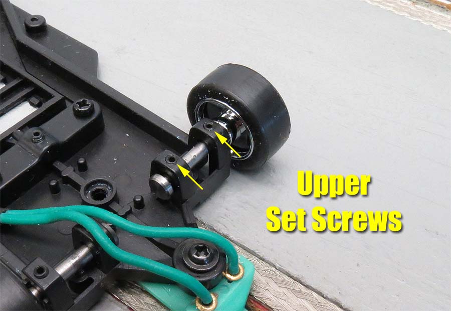

The front stub axle design is unique and either you will like it or you won't. I felt it was easy enough to set the height but some enthusiasts do not agree. There is also a slight amount of side to side free-play that you may not care for. Eliminating it isn't difficult if you do not try removing the wheel. I tried to remove the wheel from this axle but however it is secured, it would not budge. I could have kept trying but I did not want to break the wheel.
I used small SCC plastic shims that were snipped with side cutters and pressed over the axle.

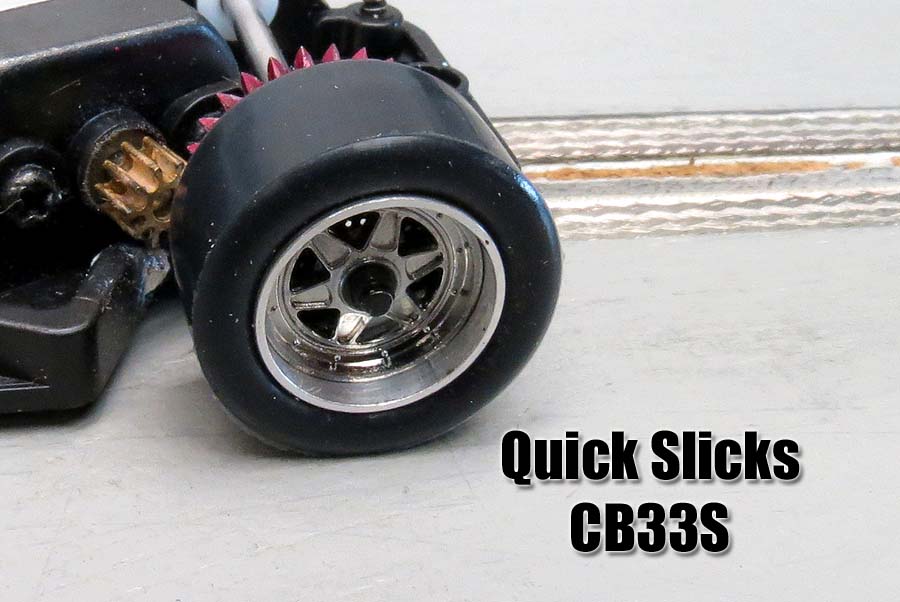

Tire Options:
The wheel is a standard 15x8 sized wheel and many different sizes are made to fit it. You choose the width and diameter that best suits your needs. The following are the tires I tested that closely match the original size.
