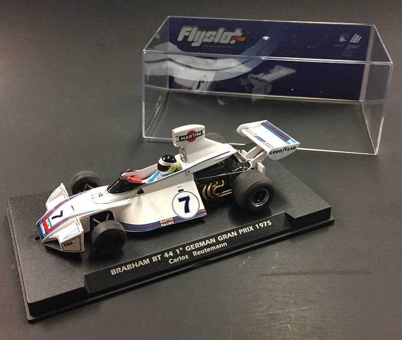

The car comes in the familiar Flyslot (Fly from here on out) plastic display case with a printed identification card as well as a printed base.  I noticed no issues with the car on the base and it was securely fastened with the normal plastic screw.  There are no extra parts that come with the car in comparison to other brands that often do in this price range.

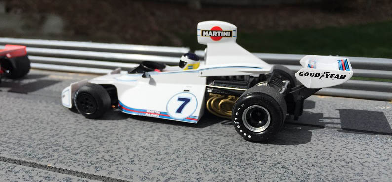

Once off the base, the car looks really good.  While there have been early reports of poor finishes, air boxes installed crookedly, and spots in the paint, my car exhibited none of those issues.   The paint is cleanly applied with almost no orange peel of any kind.  The tampo is also really nice and crisp.  With the Martini livery, there are obviously a large number of stripes and these are all very good with only one small spot on the air box where I can tell the pad on the tampo moved slightly.  I have to admit, I was worried after the early reports but after receiving my car, I’m very satisfied with the fit and finish.

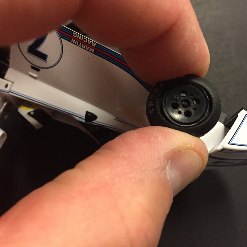

The tires look appropriately sized to the 1:1 car however here’s where my first complaint and my first issue appear:  The rear tires have no Goodyear logo on them as the released photos show while the front tires do.  Not a performance issue, but I noticed it right off the bat. The potential issue I discovered is with the front tires – they are loose on the front wheels as if they are slightly larger than they should be.  The picture shows me squeezing the tire to show how much extra play it has.

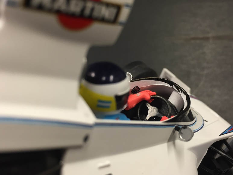

Looking into the cockpit I notice that the driver figure is well detailed with not only Reutemann’s Argentinean flag being represented, but his driver’s suit is also nicely printed and includes a separate racing harness belt.
Here is where a few more cosmetic “Nits” appear: while the outside of the tinted Plexiglas windshield at the front of the cockpit is painted perfectly, the inside was completely missed and there are no printed gauges. Additionally, the air box opening is not painted inside and detracts from the overall effect of that monster snorkel over Reutemann’s head.  Those are both easy fixes, but it would have been nice if they had done these properly.

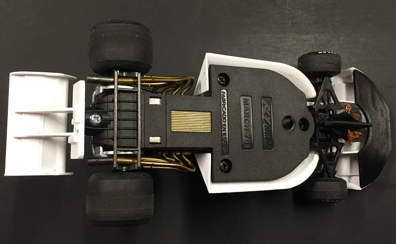

Flipping the car over, Fly fans should rejoice as they have used their very good March 761 chassis under the BT44.  I have a good number of the March cars and they all drive very well on wood with almost no tuning except for urethane tires.  The chassis is held in place with 4 screws and is extremely easy to pull apart (unlike the recent Scalextric F1 cars) for tuners.  The chassis features steering front wheels that move with the guide flag and operate 100% better than the old HRRS McLarens if anyone remembers those.
The motor is the standard FF slim can rated around 19,000 RPM.   I say "around” because I can’t find any good data on what they are really using.  It puts power to the track via a plastic gear set with a 9/27 gear ratio. The motor and exhaust detail is well executed, but as with all Fly March cars, it does have the large “transaxle” looking doghouse that covers the rear gear.  It is hard to hide such a thing on an open-motored car, but to my eyes it looks ok and does not detract too much from the model to me.  One cosmetic issue at the rear of the car is that the struts to the rear wing as well as the radiators are all painted white – they should be black according to every photo of the car I have ever seen.  A very easy fix, but it should have been easy for Fly to realize that the car would look better and more prototypical had they simply done so at the factory.

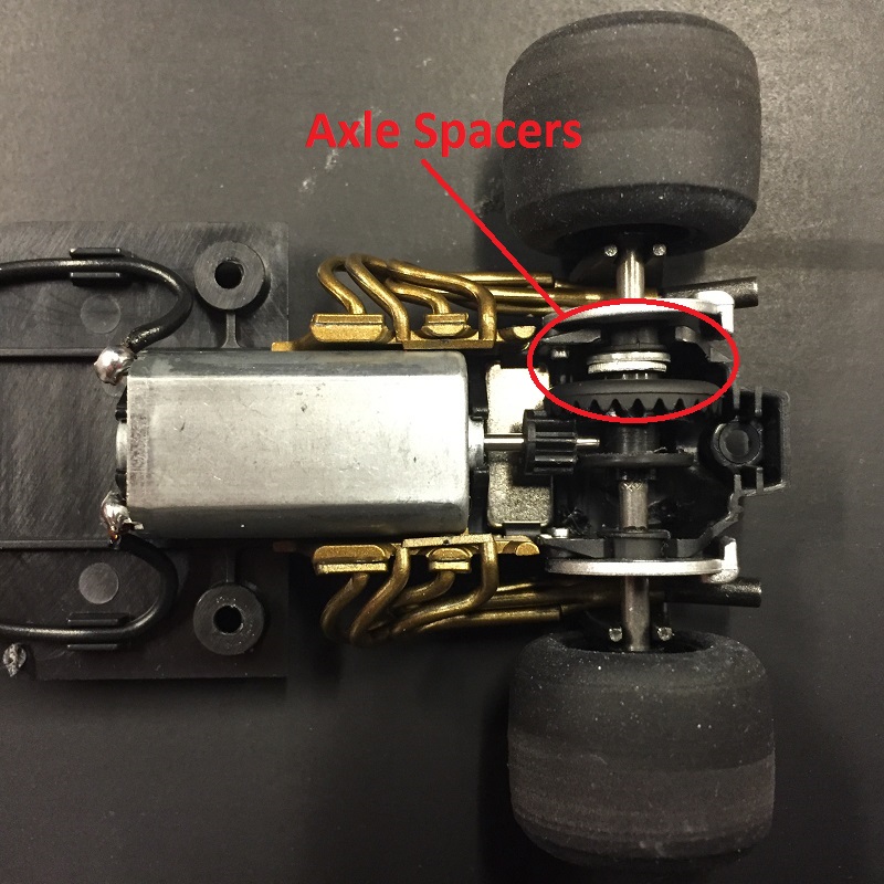

One note here: several early reports of this car mentioned severe side-to-side play in the rear axle.  My car had none out of the box.  When I opened the car up it was easy to figure out why.  Two metal spacers had been installed that took all slop out of the rear end.  For a car that was released last month, that is a pretty fast quality modification that probably saved them from a ton of returns and angry customers storming the Flyslot offices in Spain with pitchforks in hand.
