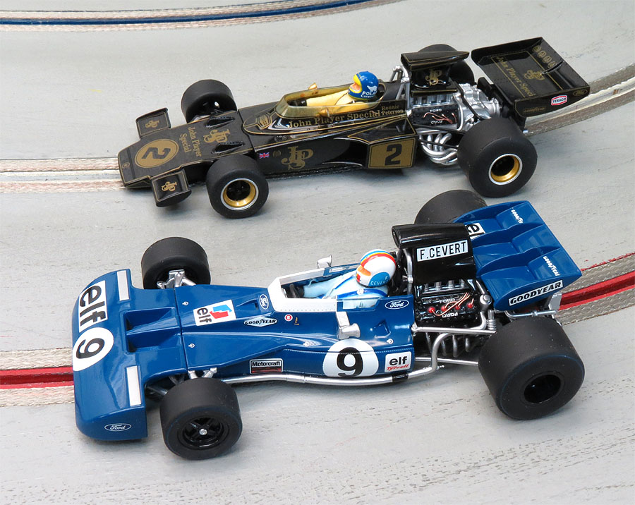

A fine example is the 2 new models before you. Having the previous boxed edition with nearly identical cars could not stop me from having them.
The detail level and overall scale appeal receives high marks from me. Are they perfect? No. Are they close enough for me? YES. What about you?
The scale compromises made for the crown gears do not bother me in the least. Helmet & wheel appearance as well. It does bother others. I respect that and will not try to argue the point. They are what they are. I will say that the whole time we have raced them, we never stopped and put them away because we felt these issues were that important. Like any model we have reviewed, YOU make the call.

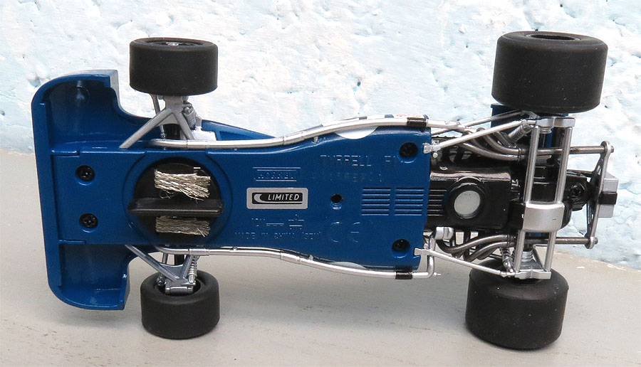

The undersides are pretty bare in regards to detail or revealing anything mechanical. The screws you see that assist in holding them together are nothing short of fickle. Removing them is only the first step in trying to wrestle these cars apart. For SOME enthusiasts it is easy. I am not one of them.

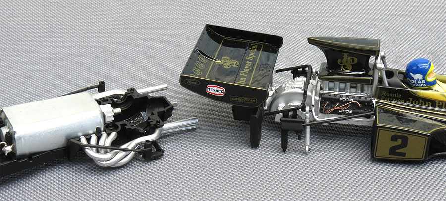

Taking apart this Lotus may seem to be easy. It isn't. The previous model had either glue or clearcoat sealing the suspension assembly and more damage occurred. This one still takes a steady hand and care when prying it apart.

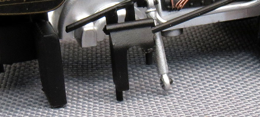

You might notice the lower shock mount on this side broke away. Not a serious issue as it will go back together and you would never see it. You could glue it back if you just had to.
Although the car tested fine out of the box, I noticed the pinion was a little further away from full gear mesh of the crown than I liked. If you take it apart and see that yours is this way, just use a small flat tip and push the pinion back a little further.

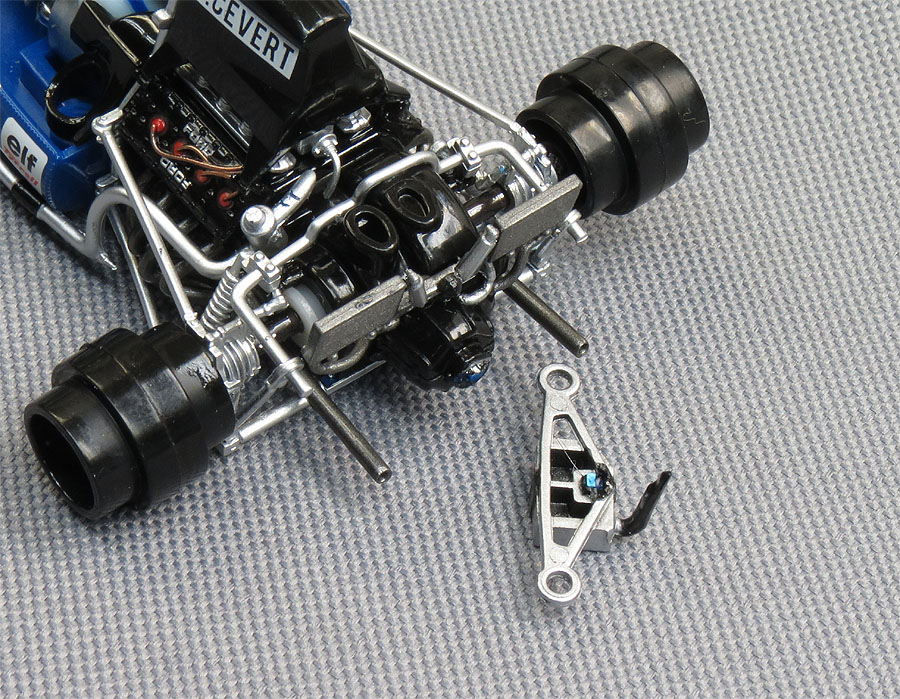

The Tyrrell is the more cantankerous of the two. Aside from flexing the exhaust braces, the biggest hurdle is the suspension mounts on the axle. As you see above, regardless if it is adhesive, clearcoat, or wet paint, this area took damage. Prying them apart only lead to the tabs breaking flush. They can be easily repaired by sanding them flush and once installed, you can glue them.
The rear oil cooler tank/exhaust support bracket is also very difficult. I used a small flat tip screw driver and had to pry on each side until it broke free. And break is the word. You can see that the glue did not loosen and the small tab broke. That's ok though, I will glue it back when finished.

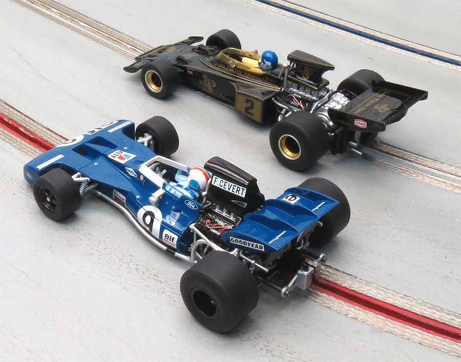

As you saw in the first video, these models run pretty well without a motor change. That is when you turn down the power. Many veteran enthusiasts have adjustable power of some sort and likely more advanced controllers. These can be significant investments and my reason for it is the ability to adjust the racing environment for the models. Given that we have invested in these items, makes sense to me to use them.
Our Setups
1. Power adjusted to 10 1/2 Volts
2. Paul Gage Tires Added
3. Sheet Lead Added
4. Difalco Controllers Dialed In.
Both models had Paul Gage urethanes installed. Either size will fit the wheel. The wheel rib is a touch over 6mm but the 22166FF fits just fine as the tires are designed to stretch a little and still perform.
