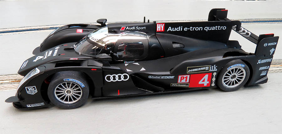

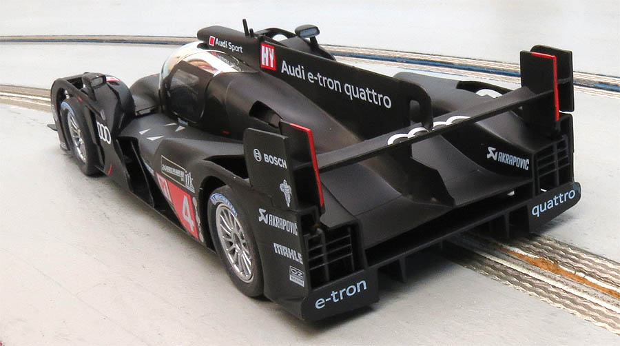

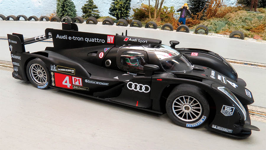

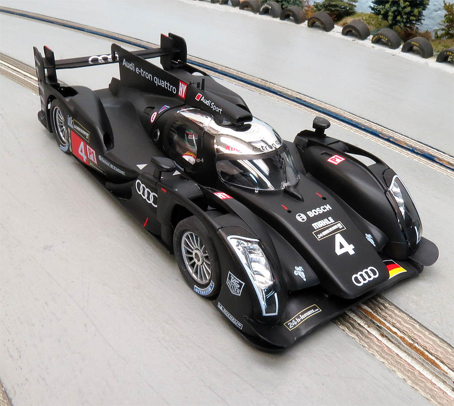

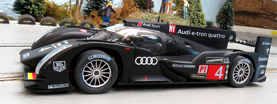

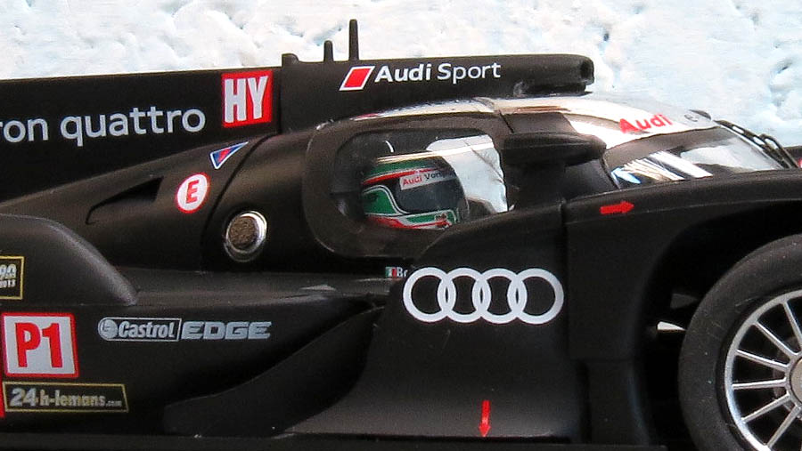

The body of this car is well done as you would expect from Slot.it. Excellent finish and very well detailed. In case you thought this was the previous model, think again.
Maurizio: The body is completely new, representing the 2013 version of the Audi r18 e-tron. Between 2011 and 2012 Audi has completely redesigned their R18: front lights, body shape, tail, pretty much everything is different. For us, chassis apart, it's a completely different model.
As usual only you can decide if Slot.it made a car well enough to suit your taste. For me it is more than enough.

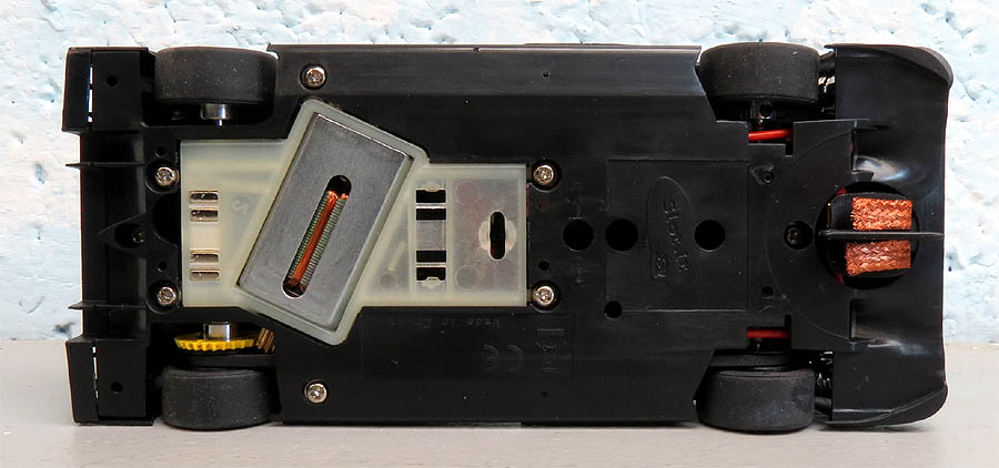

Looking underneath we get a glance at the heart of this beast. Standard Flat-6 motor anglewinder configuration is a familiar sight but that is just the beginning.
After removing the 2 screws (one front, one rear) we finally get inside.

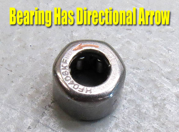

I'll let Maurizio explain the concept: To my knowledge,previous 4WD systems applied to slot cars never tried any serious attempt to solve the equation of providing extra traction, without affecting cornering. What we've done is a system that can only provide 'positive' torque, that is, as soon as for whatever reason the front shaft tries to spin slower than the wheel (for example, inside wheel during cornering, or under braking), i.e. each time a braking torque is applied to the shaft, the wheel can spin freely. Exactly like in a standard bike: you can only apply 'positive' torque, to move forward; if you try to pedal backwards, there's no effect.So whenever the rear wheels brake free (even during wheel-spin on straight acceleration),torque is transferred to the front.
Basically this means the front wheels can only turn forward. They will lock up if you try to turn them backwards (reverse).

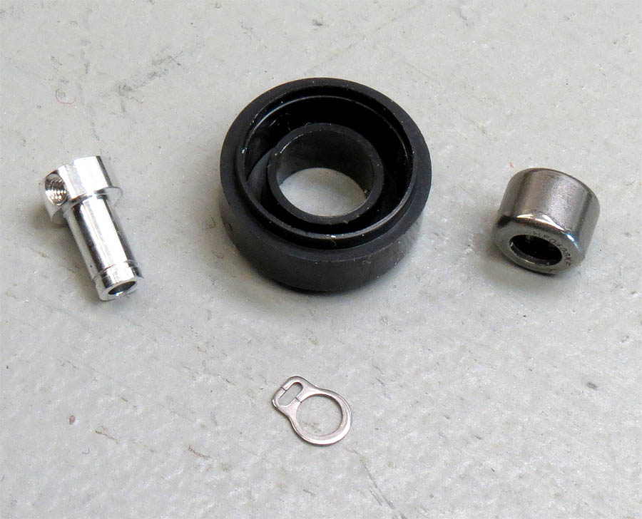

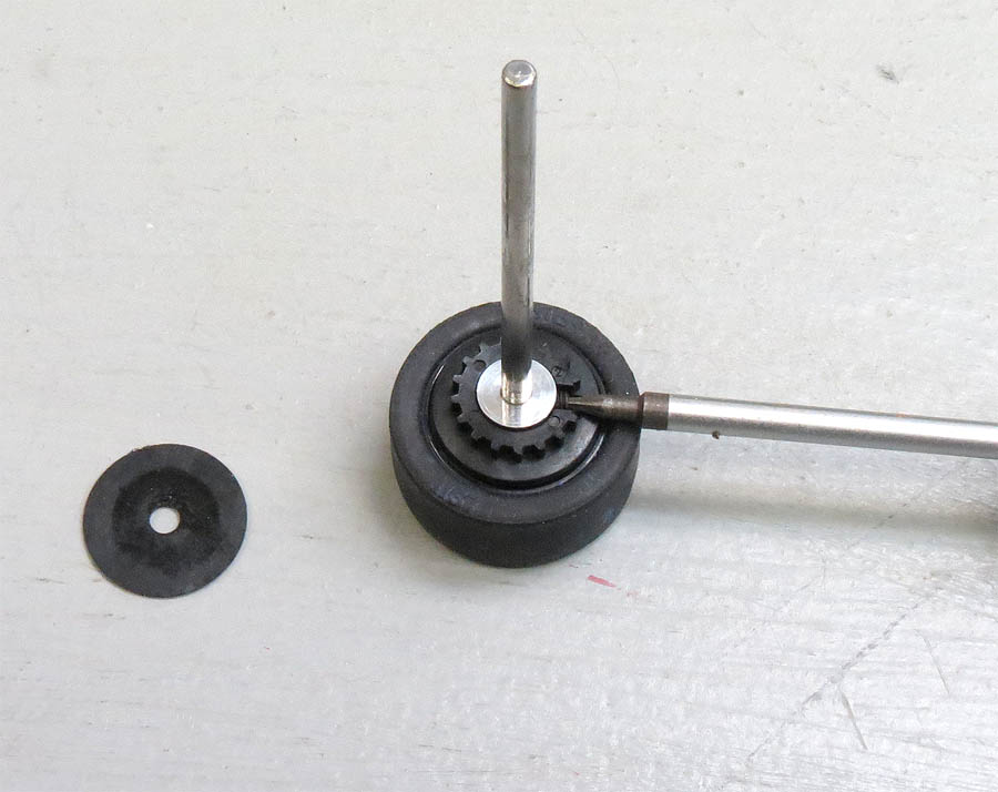

You must remove the set screw to remove gear.
The bearing is a tight fit inside the wheel. Use a small wooden dowel rod to tap it out.
You WILL NEED the smaller SEEGAR Snap Ring Pliers for best results.
There are spare rings under the case as well as spare pulleys and guards.
I did bend my ring too far and needed to replace it, so be careful when removing.
The bearings do have an engraved arrow to indicate direction.

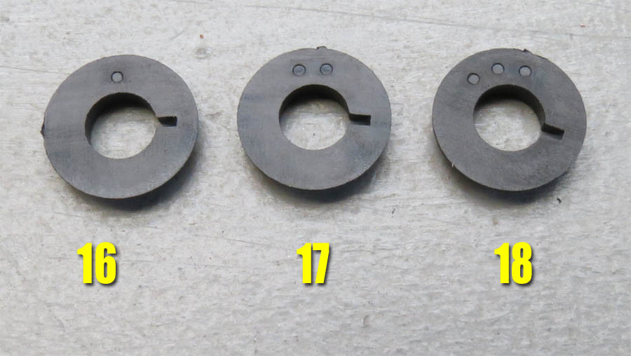

Pulley tooth count is identified by the number of dots on the backside.
