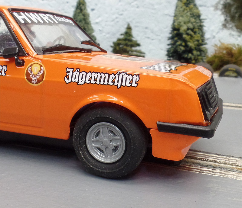

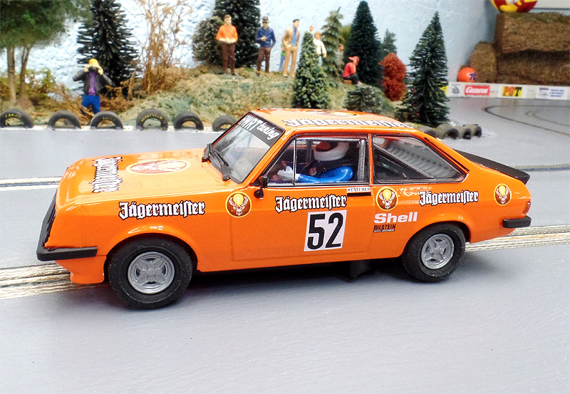

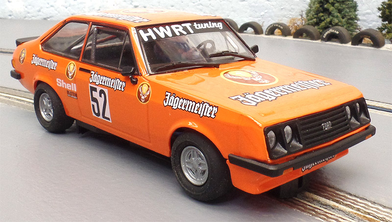

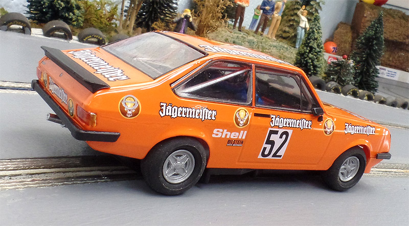

Overall the model is nicely done. The markings are actually VERY well done and opaque. The clear coat that seals it is clean and no shortage of gloss.
Detail level is more than acceptable for me. Half tray or not, it has a well detailed driver figure, roll bars, fire bottle and even seat belts.

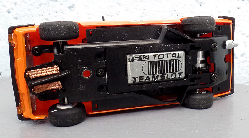

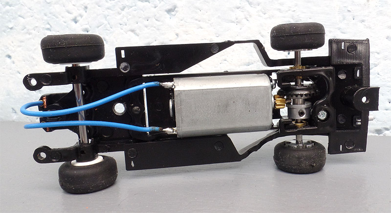

The more interesting aspect of this model is the chassis and running gear. It has a full pod system employed with fully adjustable front axle system if you install M2 set screws. The gears seem very durable and have acceptable mesh qualities for right out of the box.
I personally admired the chassis as it seems a simple approach. It's also a non-magnet car that might turn away some of you, but I applaud the choice.

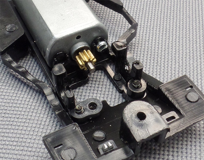

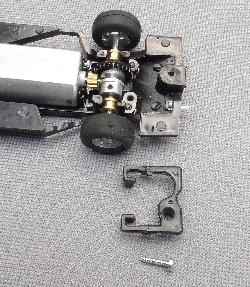

The rear axle is held in place with a somewhat odd bracket that can be a bit of a challenge to remove and install. Do NOT over tighten the mount screw as it will bind the assembly.

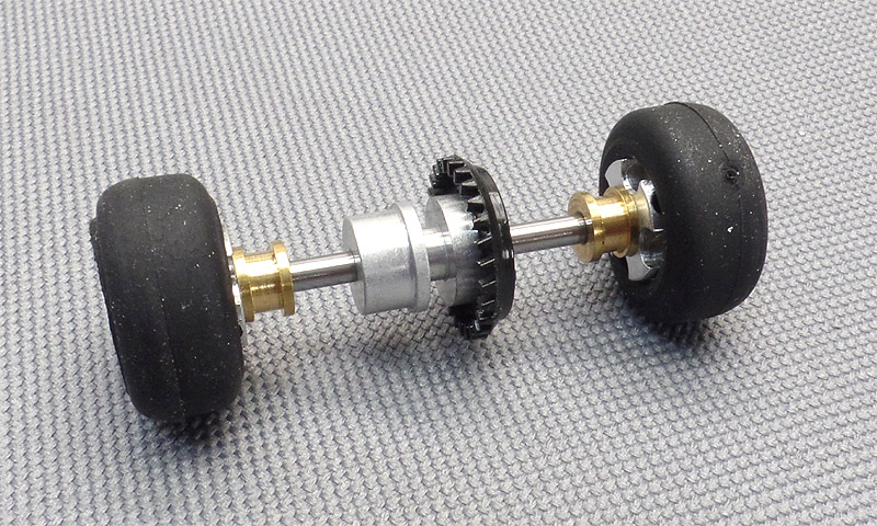

The rear axle and gear and good quality. Bushing to axle fit is very precise with little if no free-play.
There is one screw securing the motor and it IS needed. I like this. Instead of the cradle having a more traditional "snap" fit approach, the motor rests easily in the mount. I like this as the snap design lends itself to cracking and more often than not, just increases the difficulty of removal/installation.

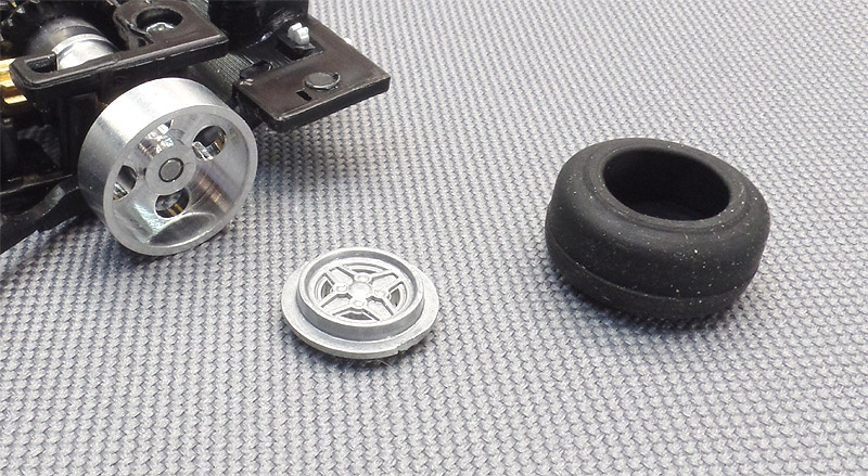

The rear wheels are aluminum and very round and true. The design will be odd to some of you as it does not have the rib design we are more accustomed to. The tire slides over the wheel and actually acts as the seal for the insert. So when removing them, be careful. Your insert will drop out easily. The tires grip well enough but they WILL need sanding. Very heavy mold lines down the center will need sanding to get them true.

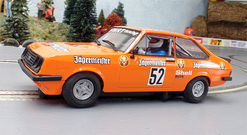

Overall I am pleased with the model. Most of the appeal for myself is under the hood, however the sight of this paint job makes it one of the best looking Escorts I have ever had in this scale.
It has a lot going for it mechanically speaking. Even if the car itself does not appeal to you, you have to give credit where it is due. Acceptable scale detail, excellent paint finish, quality drivetrain, and adjustable pod chassis.
