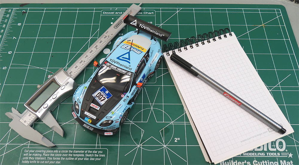

Data At A Glance
Length- 145.88 mm (With Wing)
Width - 61.25 mm (At widest section of rear fenders)
Height - 38.40 mm
Wheelbase - 83.50 mm
Total Weight - 100 grams

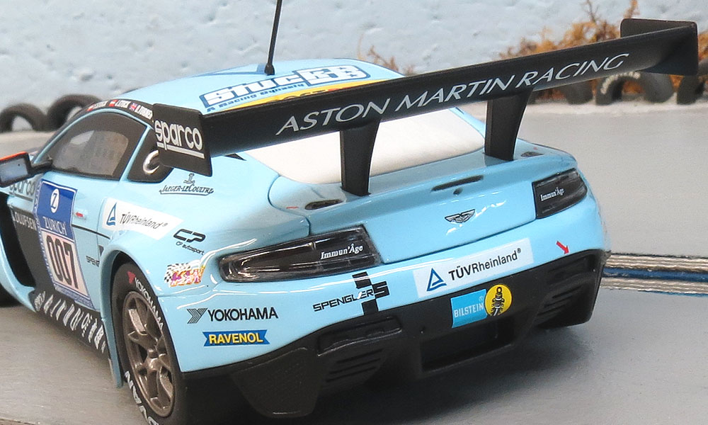

The rear wing supports are solid, which I feel is a smart move. Having fragile supports would just lead to breaking under hard racing conditions which is what the car is designed for. Does it detract from the appeal? For me? Not a chance. What about you?

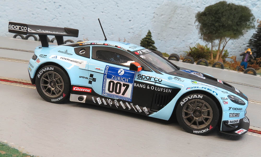

So I feel Carrera's effort here is very well done. There are always fine scale enthusiasts who will nitpick any model released in our hobby. I usually ignore most of it as nothing is ever perfect. If a slot car manufacturer produces a model that is very close in appearance to the prototype so that there is no mistaking it, that is usually good enough for me.

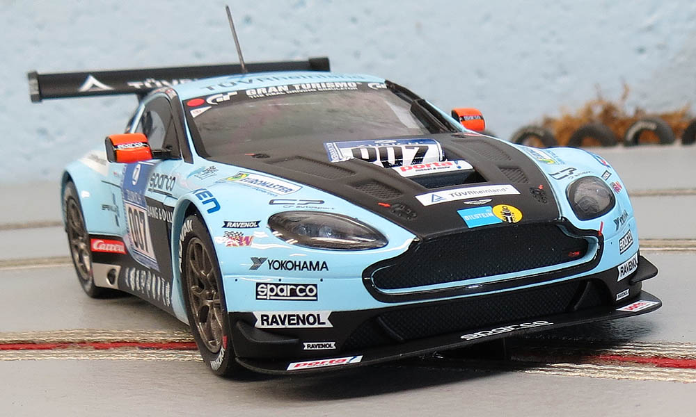

I feel Carrera accomplished that and then some. Overall fit and finish is as good as it gets with excellent color and clean, crisp markings.
Wheels and tires are executed well enough for me. They seem round and true although you can tell that some sanding will be needed to get them just right.

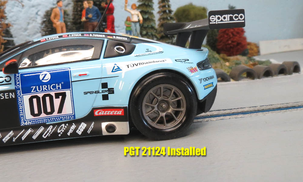

I prefer using Urethane over silicones so I choose Paul Gage. The part# 21124 HERE fits the wheel nicely. Also the part# 21125. The inner rib of the wheel is 4.63mm so either the "4" or "5" designation shall work. That is the nice thing about these tires as they stretch to fit a wide variety of wheels. Then a little sanding is easily enough accomplished to get them true. You need to do some sanding, but that is what you have to do for any tire change/tuning.

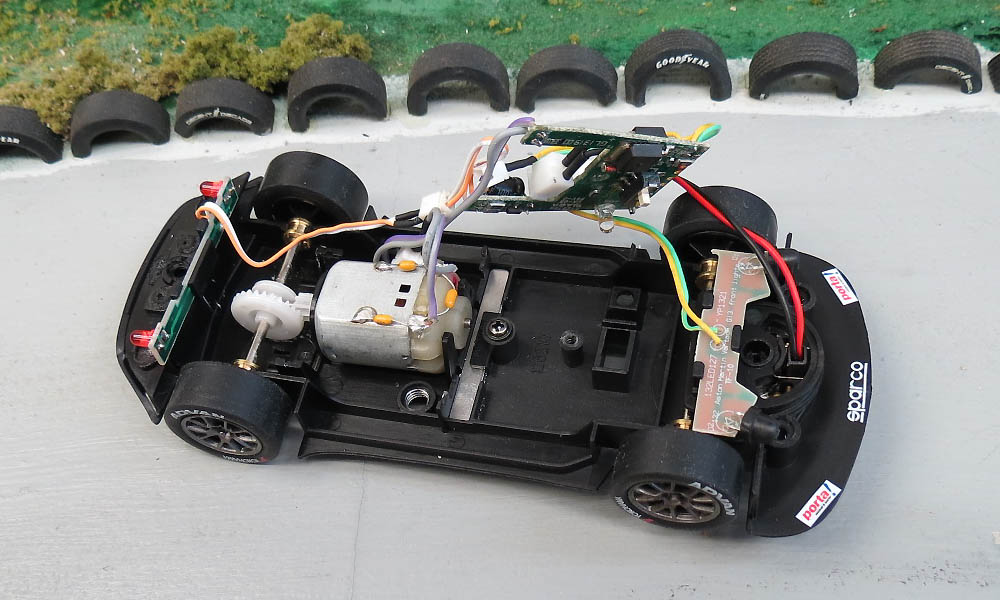

Looking underneath we see a basic chassis design with inline configuration.
Newcomers need to note the polarity switch. This allows you to change direction of the car easily.
*NOTE* This acts as a polarity switch on analog tracks only. If you have a digital track, the switch simply changes the car from digital to analog and does NOT change the direction.
You can see the rear bar magnet and there is another magnet located in the center of the car. This only works while on a analog track though.
Removing the 3 screws that mount the body to the chassis we see the inner workings of the model. Digital chip and light boards, all with quick disconnects are present as expected. Gearing is standard with a 9 tooth pinion and 27 tooth crown gear that meshes smoothly. Crown gear is straight with no signs of wobble and wheels seemed very straight under testing. The motor is the standard E200 motor which I like just fine.
I like the chassis design Carrera uses as they are similar from car to car. For example, to see how to remove and adjust the magnets CLICK HERE for our BMW DTM review. It is the same for this model so I will not waste time repeating it here.
