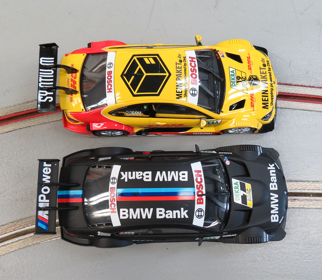

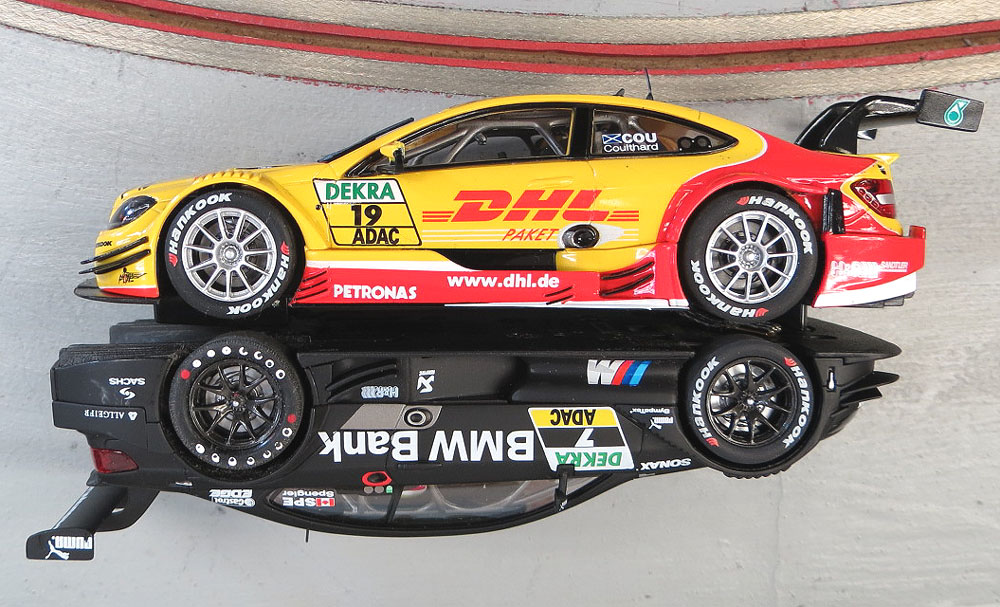

Length- 151 mm (bumper to bumper 156 with wing)
Width - 61.50 mm (At widest section of rear fenders)
Height - 36.60 mm
Wheelbase - 85.70 mm
Total Weight - 100 grams
* Spare mirrors are located in the back of the case *

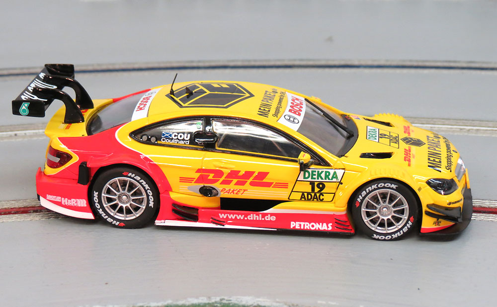

When I look at prototype photos of this car I cannot help but commend Carrera on this effort. To my eyes they look as good as you could ask for in our hobby.
Paint, markings, and gloss coat are all very well done. We sometimes take for granted how these cars look today, but looking back just 10 years ago makes me really appreciate what I see in front of me.

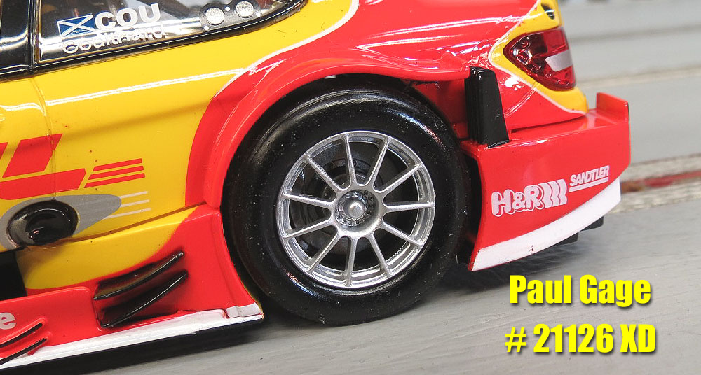

Wheels and tires look well enough and seem very round and true.
As with other cars from Carrera, aftermarket tires are easily enough applied. Paul Gage makes our favorite tire blend and the #21126 XD fit is as good as you can ask for.
As with almost any tire, some sanding will be needed to get it just right. These do not take much work and soon it was ready for action.

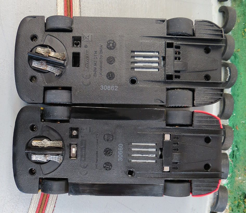

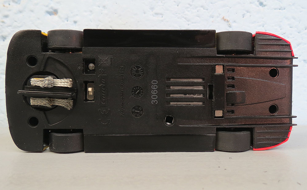

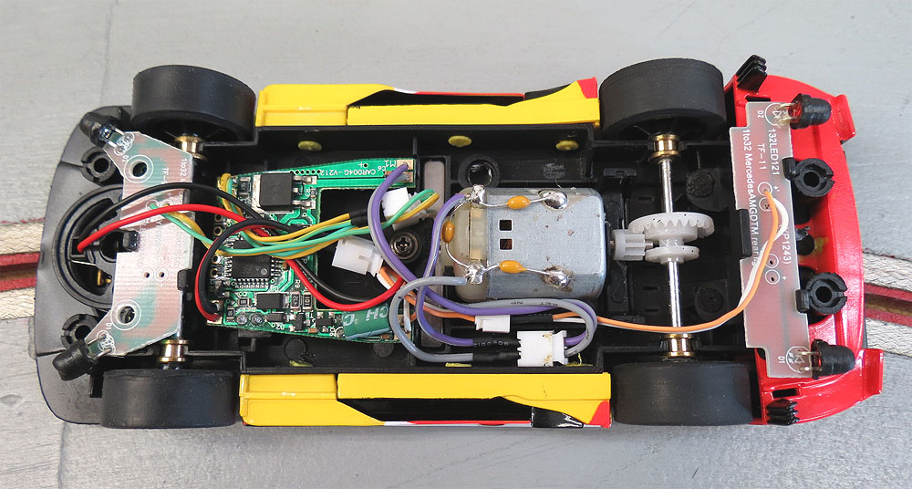

This chassis is very close to the BMW. In fact if you double check the data at the top, almost identical. 4 screws mount the body to the chassis. After removal we see a few differences such as body moldings applied to the chassis. But overall very similar. Standard E200 motor in the inline configuration with a 9 tooth pinion that mates with the 27 tooth crown gear.
The dual magnets are here with shims for you to adjust to your liking. They are the same as our BMW shown here so I will not waste time repeating it here.

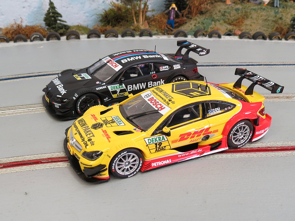

But out of the box the lap times were the same as the BMW with an average of 4.1 seconds. Things are looking good to me as I WANT these cars to be close competitors.
And comparing it to the BMW is only natural as that is the series it will run in.
My friend Tom and I raced these and we had some great action. The driver was the difference like it should be and we had quite the battle. We may not be experts on the DTM series but we think we know a good slot car when we race it and this is easily one of them.
It is not everyday we get exactly what we want, especially in our hobby. In this case though we DID. I wanted this car to be a close rival in scale as it is in the 1:1 world and that is what Carrera delivered. You might think that this is no surprise, but we see mismatched models in the same series, from the same manufacturer too often. And at much higher prices too.
