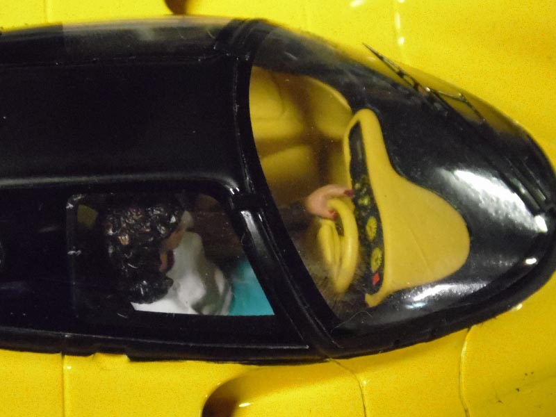

Now, before we panic and run off to buy another Scalextric, we should take a moment to remind ourselves why we bought this LMM car in the first place – the outstanding detail. The bodywork is beautifully executed, with a lustrous yellow paint job, black canopy, and flawless clear-coat. The lovely young lady in the driver’s seat shows her details nicely, right down to her painted fingernails. Painted brake calipers, mounted on fixed hubs so they don’t rotate with the wheel, peek through the spokes of the wheels. For a road car, she has spectacular on-track presence, and it’s this presence that brings LMM fans back time and time again in spite of the numerous flaws in the chassis and running gear.

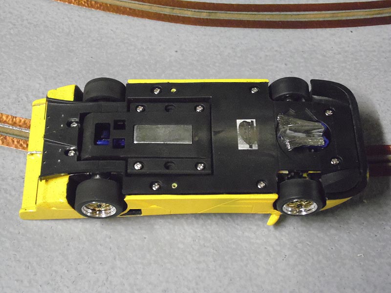

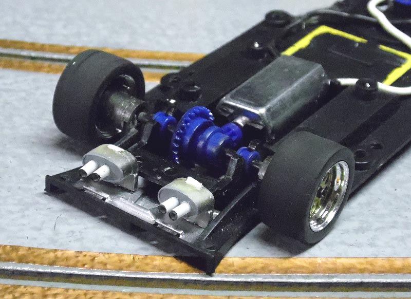

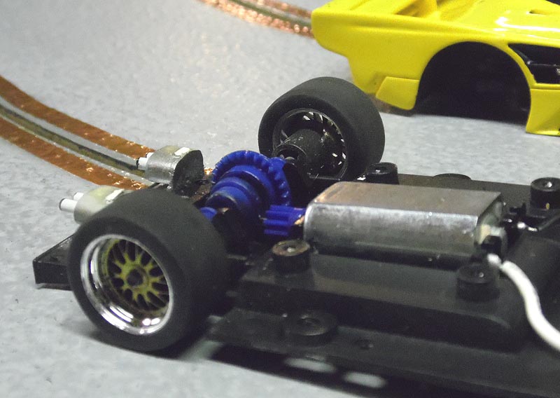

Honestly, as bad as it all sounds, it’s not all doom and gloom. The chassis and body were both surprisingly straight (a bit unusual for LMM), and there are a few things you can do to improve the car tremendously. First, get the thinnest sheet of styrene you can find. Cut two tabs the length of the guide flag. Glue them to the sides of the flag, making sure that they extend an eighth of an inch beyond the bottom of the guide flag. This leaves a nice gap down the center of the guide, which can be filled with 2-part epoxy. When the epoxy cures, trim and/or sand so it doesn’t bottom out in the slot. You will have a guide flag that sits properly in the slot without popping out at the slightest provocation.

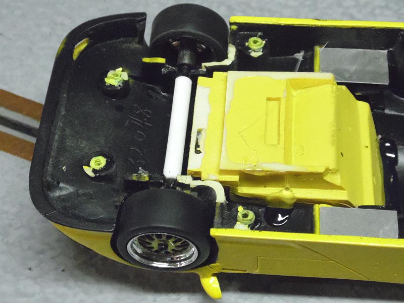

The other critical item involves setting the front axle at the correct ride height. This needs to be perfect – there’s just no room for the front axle to flop around, or the front tires will bind on the bodywork. With no axle stops built into the chassis, a chassis-based solution would be problematic at best. Rather than mucking about with the chassis, you’ll be better off securing the front axle to the body. A piece of 7/32” styrene tubing can be placed over the axle, then fitted to the body. Once the wheels are in the correct location, secure the tubing with hot glue.

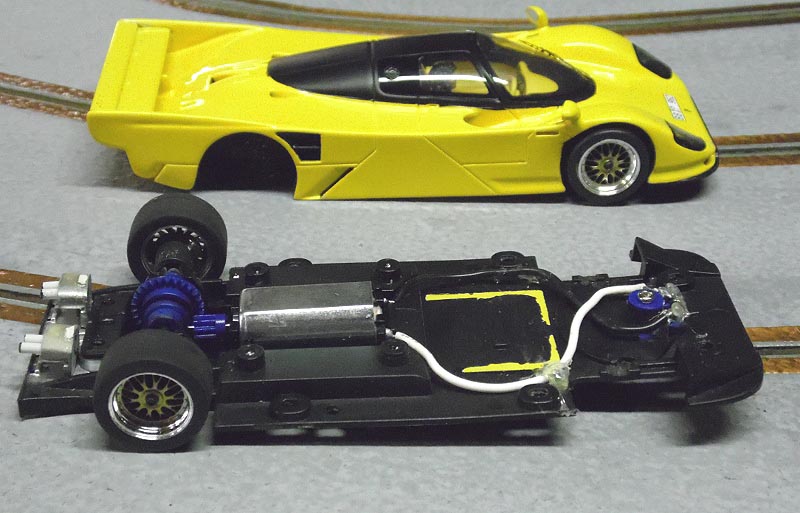

Wait, there are three more things you’ll want to do. First, in the pictures, do you see where the wet paint stuck to the chassis (picture above, upper right-hand corner)? This turns out to be very helpful, because it tells us where we should route the lead wires. By gluing the lead wires outside this yellow box, we keep the wires from getting pinched by the interior. Second, grind off the lower side of the interior’s forward edge. This gives the lead wires somewhere to sit so they don’t push upward on the body. Third, the back of the inner fender wells need to go. Grind them down a bit with a Dremel, so the wires won’t get pinched. Now the front end will sit properly when you button it all up again.

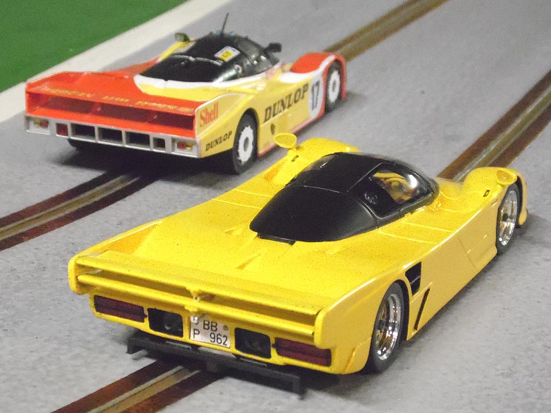

Once reassembled it was back to the track, where the Dauer 962 immediately raised some eyebrows with smooth acceleration, comfortable braking, and competent handling. Granted, the magnet remained snug in its magnet pocket aft of the motor. Even so, the drive on plastic may remind you more of the big boys, with more punch out of a corner than a Carrera, and with handling (and sound) similar to a Ninco with a mid-mounted magnet. While not the fastest magnet car we’ve ever seen, it was reasonably quick and quite fun – not nailed to the track, but solid enough to give the driver confidence. It was so nice, would a magnet-ectomy be in order?
Of course it was. So, the magnet came out, and the on-track battle with the Slot.It Porsche began. To be fair, the LMM’s lane was a tick or two faster than the GT1’s lane, but seeing any LMM car pacing a smooth-running Slot.It is a little unusual, for sure. When I finally got around to loosening the motor pod, the Dauer Porsche gained another 0.2 seconds per lap, and from that point on, the Slot.It would only see the 962’s taillights.
