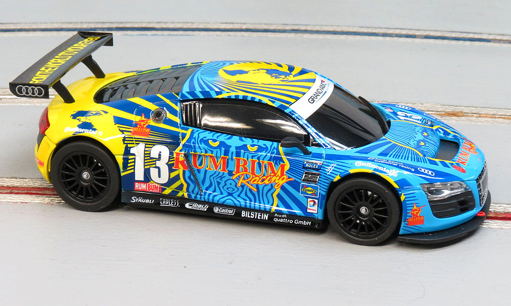

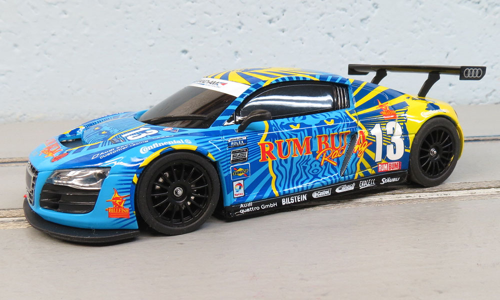

My first impressions were very positive. Although I prefer a full interior in this scale, the tinted glass effect is acceptable to my eyes. Of course this is a matter of personal taste so only you can decide.

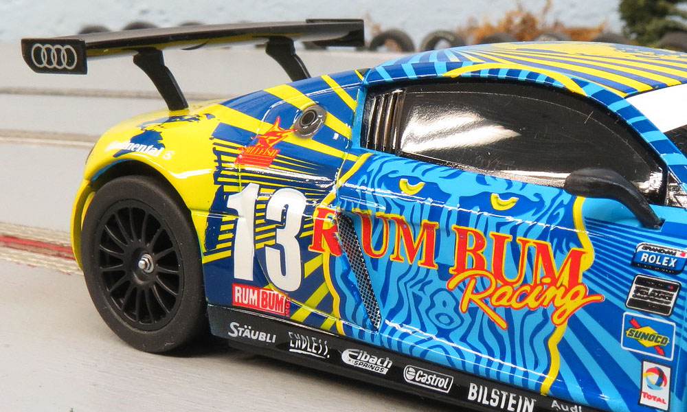

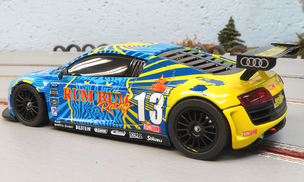

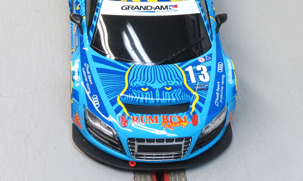

It was the effort in the paint department that impressed me. This is a very intricate livery to reproduce and NINCO really did an excellent job. Colors are crisp and clean with a high gloss shine throughout.
As I looked around the model I have to say I was happy. So far it gives me a good first impression and you know what they say about that.

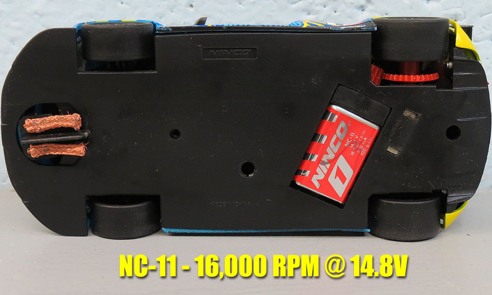

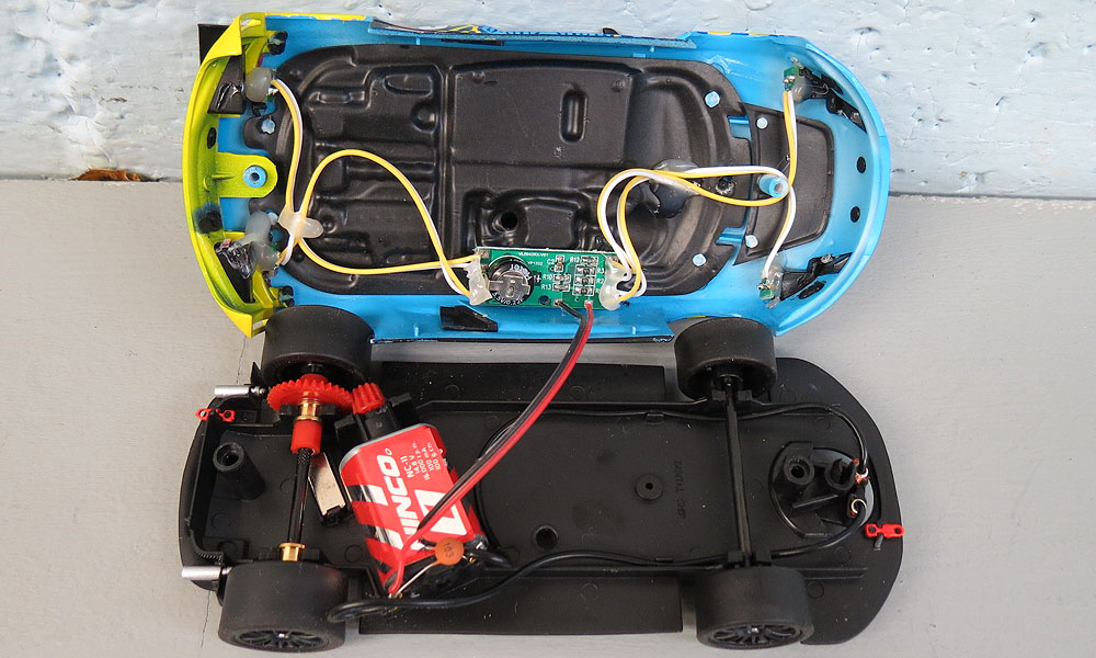

Turning the model over we see the second change. The NC-11 is now mounted in the anglewinder configuration. The magnet location is suitable for most and keeps it pinned down pretty well.
One screw up front and one in the rear hold the body to the chassis. The front screw is hidden by the guide but is easy enough to remove. Inside we see the NINCO light kit installed. It appears to be the same light kit you can buy off the shelf and that is a good thing. I have used these kits in the past and they are durable and very bright. Some models have been going for many years without any issues. Here is A QUICK LOOK AT THE LIGHT KIT.
The motor is geared with a 12 tooth pinion that turns the 32 tooth spur gear. As you can see the rest of the model is as basic as it gets. The hole up front does allow a digital chip to be easily installed. I see the use of a light weight interior but it is only there to block any light from the kit. There is no driver head nor any markings.

The first few laps were what I expected. A little gear noise as usual but nothing some break-in time won't help cure. As far AS POWER is concerned I like this motor. It is a mild power plant that gives you plenty of speed but mild enough so that younger/beginner drivers can quickly begin learning to drive. This is the intended audience for this series so I give NINCO high marks for staying with this motor. It is easily changed however. The motor has the adaptors installed and the chassis is designed for you to drop in a larger motor. Any NC-5 type or other brand will snap in. The only issue I found is that the motor sits loose in the chassis and has a rocking effect under power. A quick bead of hot glue easily cures this.

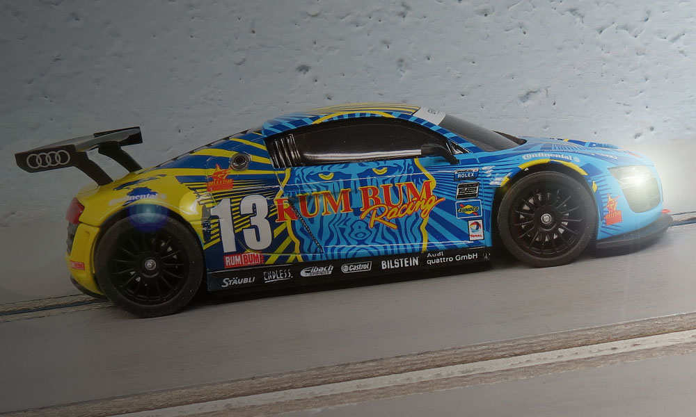

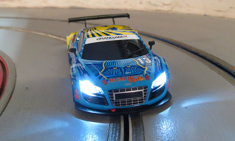

The lights work very well.

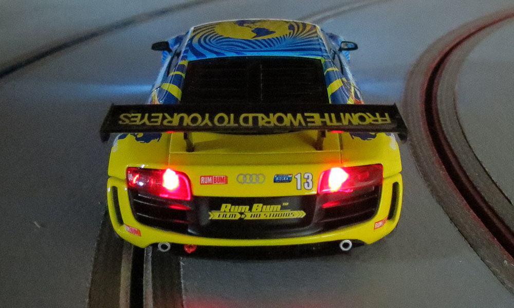

Brake lights activate when you let off the throttle.
The lights work very well and it is a sight to see. Very bright fronts and the working brake lights add to the appeal. I suppose it is just my own personal taste, but when a car has lights it just increases the scale realism.
