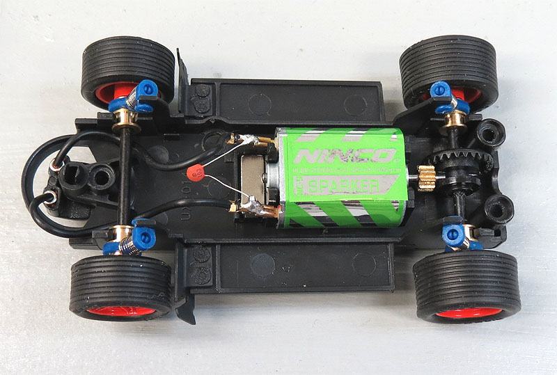

Turning the model over we this new car equipped with the NC9-Sparker motor. To steal a line from that famous movie, "NINCO is like a box of chocolates: You never know what you are going to get." We have stopped trying to make sense of NINCO's motor program and just accept that they will install anything they see fit.
In this case I am actually optimistic. Normally they (NINCO) install motors that have too much power for the model in question, at least for scale enthusiasts. Rated at 20,000 RPM at 14.8 volts, this motor is a nice power combination for our smaller track. Enthusiasts that we know from our forums have also relayed positive comments on the fun this motor delivers.
There is also a magnet installed right in front of the motor. Most scale purists will remove this of course, but it is good to see it here for those who like them.

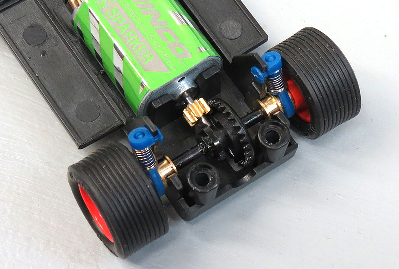

Once the body is removed we see that the suspension system is installed both front and rear. Do not get too excited though as the amount of travel is almost negligible. Yet it is present and perhaps it will please some enthusiasts.
The front has more travel than the rear. If you use the magnet then it really does not serve much of a purpose. Without a drop arm it won't really work on obstacles either. Only on the trucks does the suspension really do anything noticeable.
Up front NINCO uses their standard spring loaded guide. You can remove the spring easily if you like.
The motor has a 9 tooth pinion that turns a 27 tooth crown gear. Gear mesh seems smooth enough and will get better over time due to break-in.

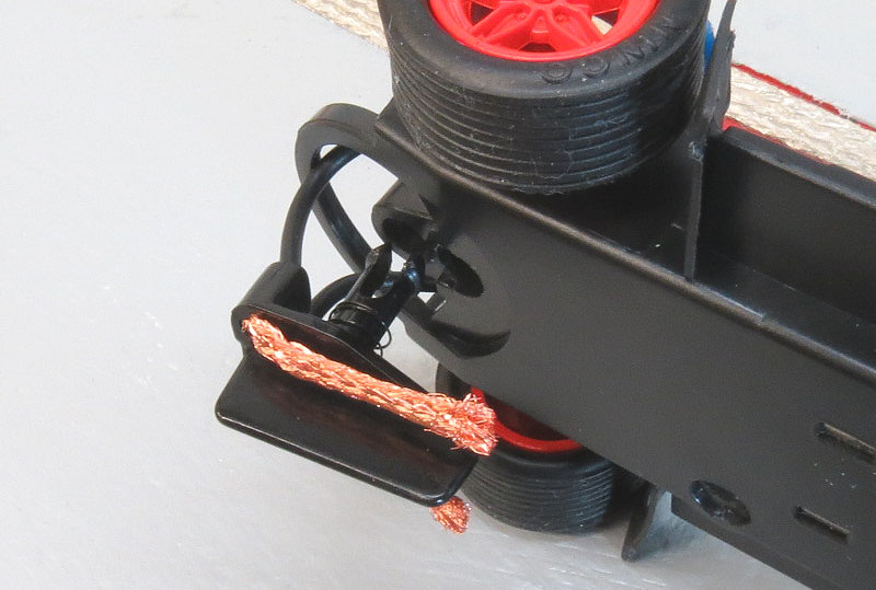

I did not like where the lead wires were under the axle. It just caused rubbing and that is not a good thing. I simply swapped them as shown above.
