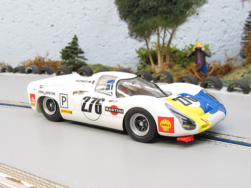

My model arrived safe and sound in it's attractive packaging. It has a soft plastic outer sleeve that surrounds the standard case.

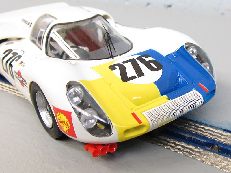

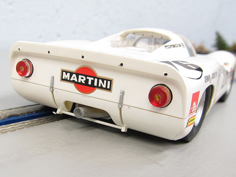

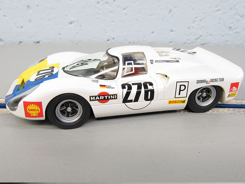

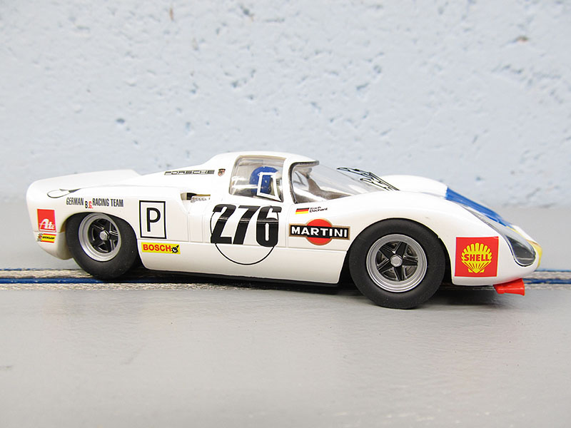

Overall the model looks fine. Fine scale enthusiasts will always find faults of course as nothing is perfect. Looking at prototype photos tell me they came very close, or rather close enough for me.
So as always only you can make the call. Is it good enough?
What little paint work there is seems fair. Nothing better or worse than we see from most any other brands. There is a little bleed through on the front number meatball and some very light masking issues. Does it remind some of you veteran enthusiasts of anything?
SRC is proud of that wiper blade. For me it really isn't that critical. Spanish makers seem to do things like this. Concentrate on something like a wiper blade instead of making sure the tires are on the wheels correctly or that they do not rub the body.

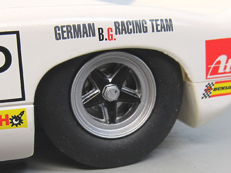

Which they do. As the photo in the box shows the left front tire was not even fully mounted. The rear tires either. SRC has stated they are aiming at the collector so it seems odd they cannot even mount a tire correctly on a car that the so-called target consumer will never remove. Quality control? Well, we all know how we feel about that. I will say that IF I were just a collector, I would be rather annoyed that the car looked this way inside the case. If you are a just a collector does it matter? Are you just tucking it away to sell a few years from now or is this a display model for your shelf?
Wheels look ok to me and do have some brake rotor detail that will please some of you.
Tires are rather a hard compound, but it really doesn't matter much to me. I swap stock tires out all the time.
The seam in the center? Same thing. I cannot imagine not buying a slot car because of that. A little sanding which you will HAVE to do, it's gone. Furthermore, most people that intend to race it will be changing tires anyway, so no reason to complain in my eyes.

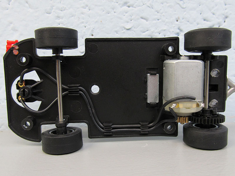

Underneath we see the sidewinder configuration and the bar magnet location.

Removing the 4 screws we see a very nice chassis. First thing I liked was the solid front axle. Although speed racers like the independent systems, I am a middle of the road sort of person (if you ever raced me , you know this!). Tuning a solid front axle is easy and can result in great performance. So I am pleased to see this.
I also like how tidy the wiring is. This makes things easier than before as I don't have to glue them in place.

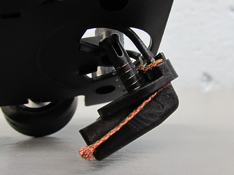

The front guide fits ok, with a spring loaded system. Most of you will remove the spring and when you do you will notice plenty of vertical free-play. You will likely shim this guide to the height you want, or replace it with a better after-market system.

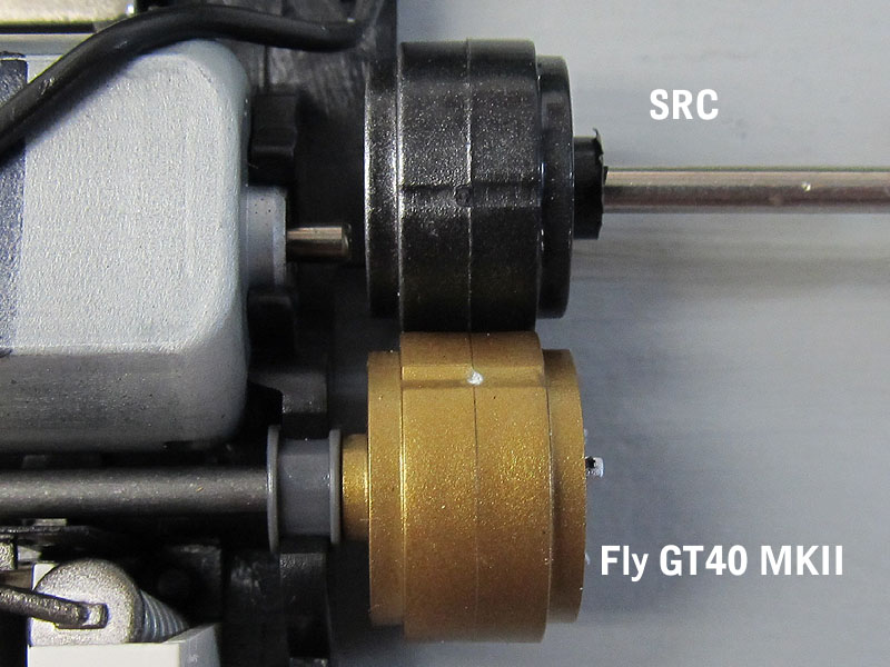

The rear wheels and tires should look familiar. They are the same wheels found on Fly GT40 MKII models (as an example). This means any after-market tires made to fit those wheels will work here. There is still some sanding to do to remove the ever present flash molding of course.
Rear axle bushings are loose in the chassis and will spin under load. I would advise using a little hot glue or clear silicone adhesive to snug them up.
You never know when you might want to replace all of this with higher quality running gear, so I cannot tell you to use any permanent adhesives like Super Glue.
Speaking of that, our 11 tooth brass pinion turns the 36 tooth spur gear. Gear mesh is not perfect, but it will smooth out with break-in.
The motor seems to be around 18,000 RPM. In other words it sounds and performs like a Fly motor. I cannot verify this of course, just going on overall feel.
Braking is decent as well as acceleration. It does feel a little "softer" than any other motor in the Fly line, but without hard data I am just guessing.
A smaller bar magnet is in place and should be enough for most of you.

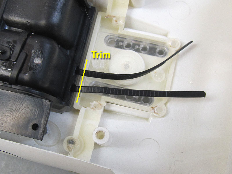

I noticed the body was not sitting true on the chassis. After removing it I noticed that SRC really wants our driver to be safe. These might be the longest seat belts in history. The issue was one of the bets was pinching between the body and top of the motor. I trimmed it away and things were just right.
