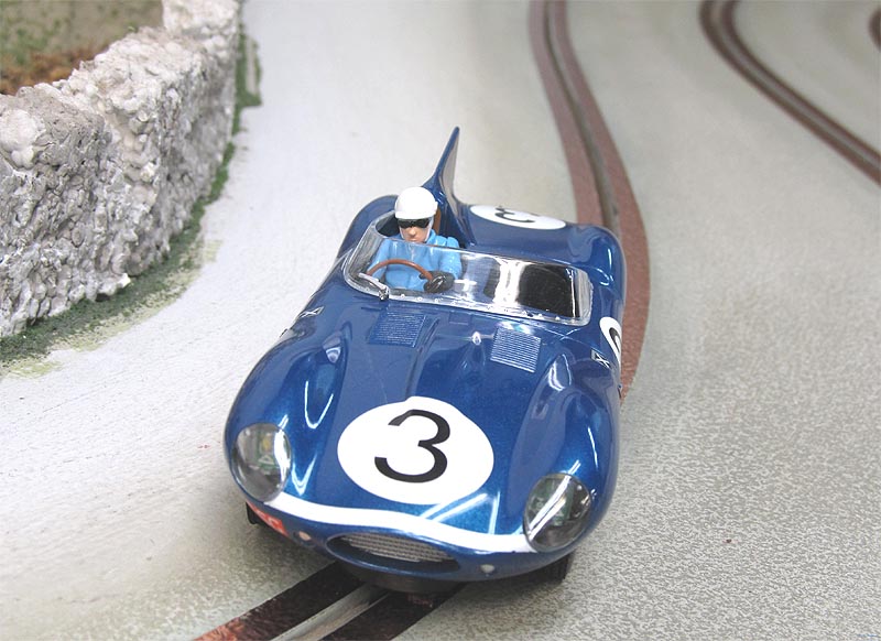

Before the car arrived here I had already heard many opinions about it. Most all of them were positive. This sort of surprised me because Scalextric seems to be inconsistent in achieving the overall body shape in scale, especially on some of the past efforts of classics.
But not on this model, at least not to my eyes. Nothing is ever perfect of course but overall I have to give Scalextric a thumbs up.
The fit and finish is also very well done. Scalextric is about as good as it gets in this department for a ready to race slot car. Because the bottom panels of the body are molded to the chassis, there is a distinct line you can see. I wish they would have designed it differently for not only looks, but for tuning. Yet, it is not that offensive and most of you will be pleased. The color is in question, it might not be the ideal shade. Photos vary of course but you have to make the call. This is one of those models that photos just do not do it the justice it deserves, especially my amateur attempts.

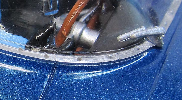

Rivet detail is here and adds more appeal for me.

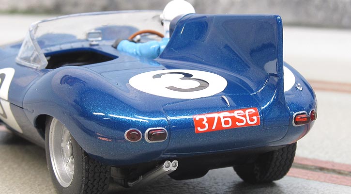

The shape of that "famous fin" is well done.

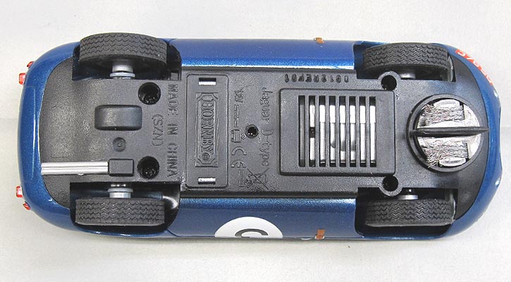

Looking underneath we a front motor configuration along with a standard bar magnet. Given the interior detail of the car a front motor and driveshaft was the logical choice. Yet, Scalextric provides a technical data sheet on all new releases and when you read it you can clearly see a mistake was made.

I like the stock Scalextric motor and it should give most of you more than enough speed. I have to warn those of you racing on the abrasive surfaces like NINCO, SCX and even classic Scalextric that even with this mid range motor, combining it along with the grip of the track and the heavy bar magnet means when this car even slightly breaks free, it is literally FREE.
Removing the magnet make things better in my opinion but with this track surface realistic drifting effects are not common. Tinkering with weights and tire compounds should deliver a model that satisfies though. As with any model it will just need a good owner to fine tune it. Regardless of my personal taste, the car passes our box stock test easily.

4 screws were easily removed to expose our chassis. You can see the lower part of the body is molded as part of the chassis. Of course you now get a closer look at our front motor configuration along with the bar magnet and wiring for the lights.
The wiring for the rear of the model caught my eye because it is VERY close to rubbing the crown gear. I tried to relocate it underneath but you would have to notch the body post a little to allow the wire to recess and the wire itself would need to be lengthened. No real issue as I just bent the wire to make sure it clears and I can go back and rewire it if need be.
Under load I inspected the chassis components and found no issues. Motor shaft spring and shaft showed no signs of wobble. The motor itself sits snugly with also no signs of rocking in the mounts. But I always hot glue my motors in place because over time they do begin to move. Finally the rear axle bushings were snug and there was no rotation inside the chassis.

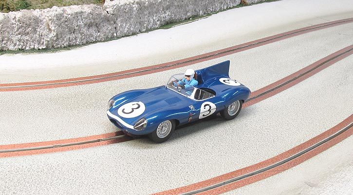

This track is where this model will call home and my first few laps had me smiling from ear to ear. Operation was pretty smooth right out of the box with NO wheel or tire sanding. This tells you a lot about the overall platform.
Aside from the obvious that we had adequately round wheels and tires, I noticed the front tires just barely touching the track. This is also a big factor in how well this model functions. With just a slight sanding the front end was riding just about perfect. Just sand the tires on the rear and swap them to the front.

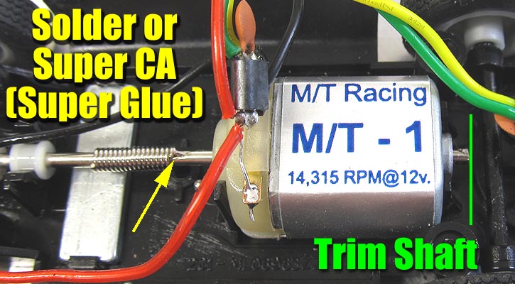

The motor here is not a bad one by any means but I will be changing it to the milder classic M/T-1 Racing motor so it will have the performance more to my liking. But as it is I can see many clubs just leaving it alone and enjoying it as it is.
Motor Swap
And with that said, I might as well share the quick change out. For our racing here, this model needs to have the right power to fit into our classic series. We are using the MT Racing series of motors on almost all of our classics and they have the perfect feel for us.
I trimmed the front shaft off and slipped on the spring assembly. Because the shaft is not knurled, you can either use a good brand of Super Glue (CA) or solder it. I like solder and it was very easy using a 60/40 blend solder. In just a few seconds it flowed into the spring and on the shaft. Done.
