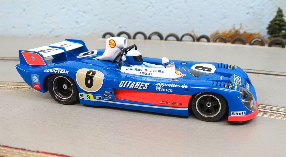

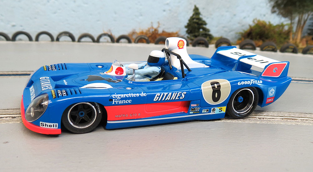

When the model arrived from Slot Car Corner I was impressed as usual. Overall fit and finish is about as good as it gets in our hobby.
My lack of skills with a camera cannot capture the correct shade of orange trim. You can refer to professional photos like the ones shown in the Slot.it press release to really get a quality look.

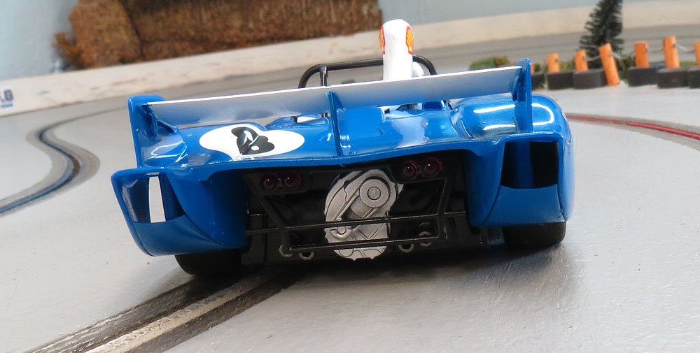

By first looking at the rear wheels you might think an insert is missing. It isn't. This is how the car looked. Not a perfect rendition but close enough for most.
I think the detail level is more than acceptable. As usual it is all about your own personal preferences.

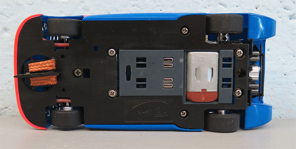

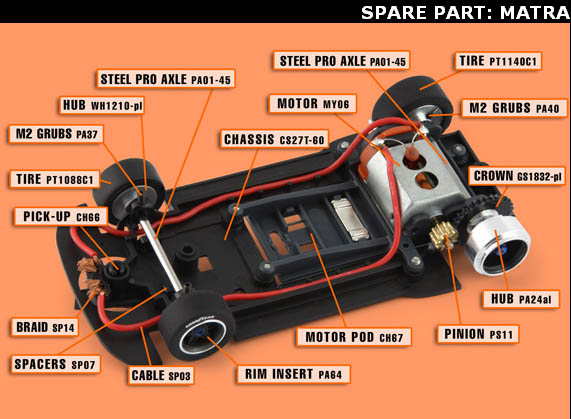

A quick look underneath reveals no surprises. Sidewinder configuration just like other classics in the series.

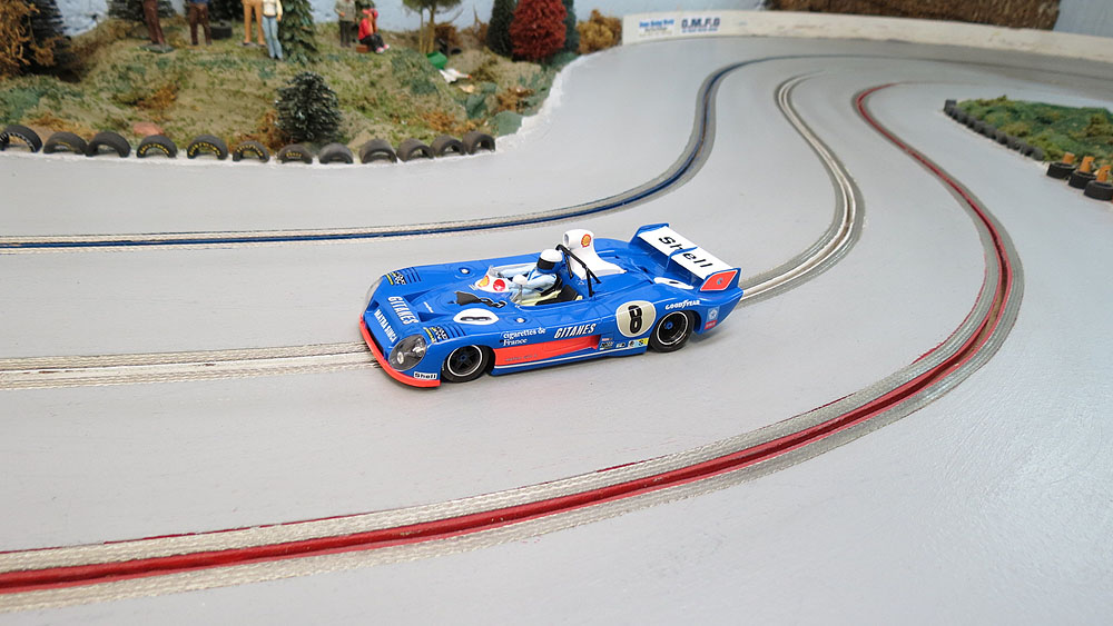

The model ran very well after I tightened the wheels in the rear. As a rule you should always check models like this that come equipped with set screw wheels and gears just to make sure they are tight. Although the stock tires worked well enough, Paul Gage after-market tires are our standard tire and a quick change was in order.

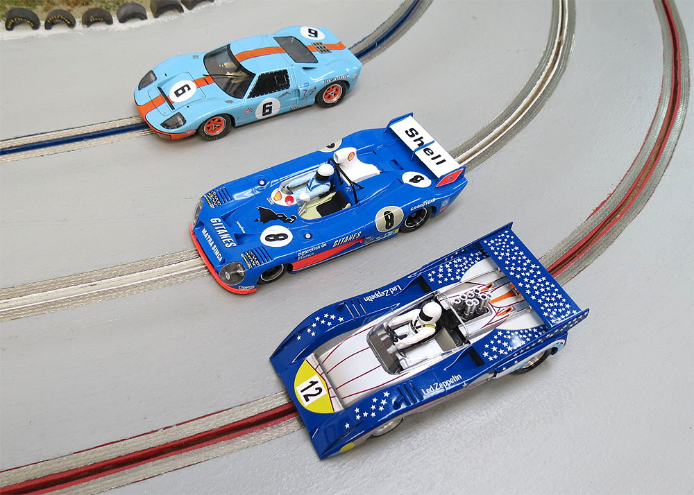

But not just for the Matra. ENTER THE COMPETITION!

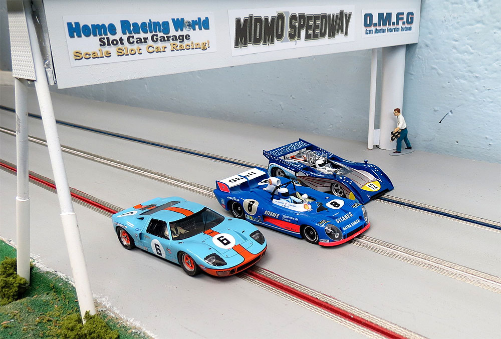

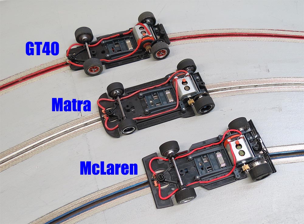

I chose two of the most popular classics we race here, the McLaren and GT40. Each of these models have not been tuned yet so they were perfect candidates.
Each chassis was went through to make sure the front axles was set at the correct height. I used the oval point screws Slot Car Corner carries and they work just fine. The MATRA comes with screws on top but not for the bottom.
Once this was set I installed Paul Gage XPG 20115 tires on each model. After installation they were trued on the Razor and then re-installed and tested.
Finally I backed off the pod & body screws slightly to allow float. Same amount for each car.No other modifications or weight has been done. My goal was to test each in basic stock format other than a tire change to see if there was an major advantage to either model.

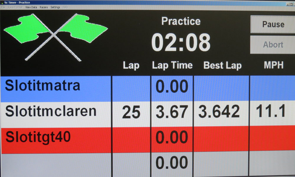

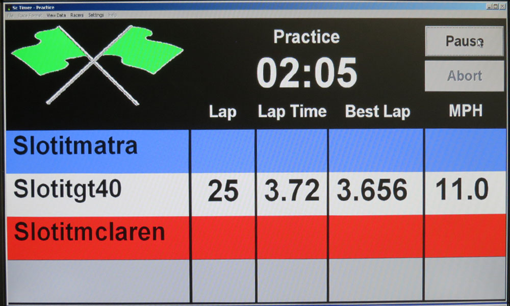

So with that said, time to get started. First up - GT40
Not bad. Smooth, but a little chatter in the corners.
Now the McLaren.
Very close, but just edging the GT40.

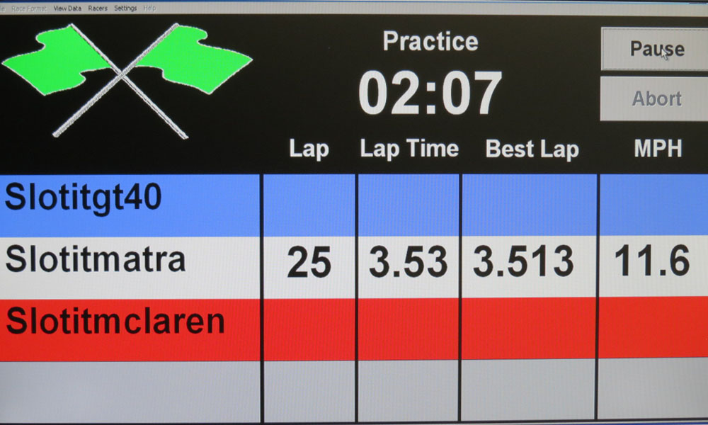

And finally our new contender.
Wow. This car just feels more planted all the way around. As you can see the McLaren and GT40 are really a toss up in terms of times. Just the slightest adjustment or better driver would take the podium. But with this car? This new one seems to have an edge overall.
