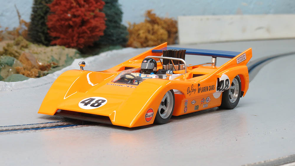

The most anticipated release from Slot.it has finally arrived. Most advanced enthusiasts already have them in hand and the feedback about it has been the buzz of the web. Here is my quick view of possibly the 2013 Slot Car of The Year winner.

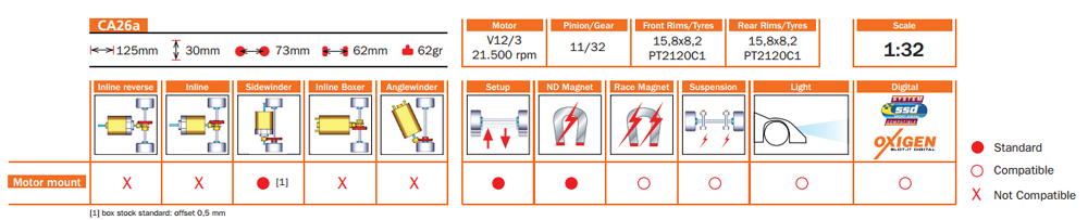

Quick Tech Data

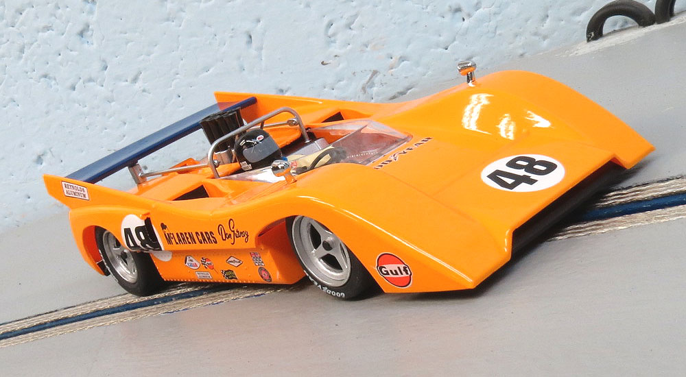

Now for the nitpicking department. Is is a little low? Possibly. The static appearance of the car looks a little low. Some have commented that the vertical fins are "missing" from the front fenders as is the the famous "Gurney hump" in the roll bar. Yet these items were added later in the season and not particular to this car in the 1970 race it is modeled after.
The wheels in the rear could be a little wider as well and the wheel inserts could be set deeper. But given the sidewinder configuration, this is about as wide as it gets. That is fine by me but you may not like it. You could sand the inside of the inserts or even remove material from the hub center to set the insert in deeper. I won't bother but there options for those that want to.
I understand from a racers viewpoint the decisions made. The model is intended to be raced in the "Classic" series by Slot.it and that means sidewinder configuration using the wheels and tires they already have that will fit. For me, I would rather have the car as close to compatible as possible for the series intended.
Paint and markings are as good as it gets. My model simply shows no flaws in these departments. Color appears to be correct and markings are very crisp and clean.

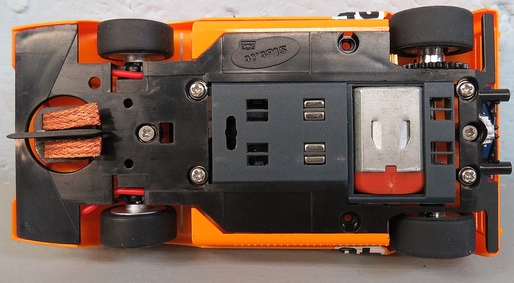

As we look underneath there are no surprises. As stated, it is the standard sidewinder configuration as it should be for this series.

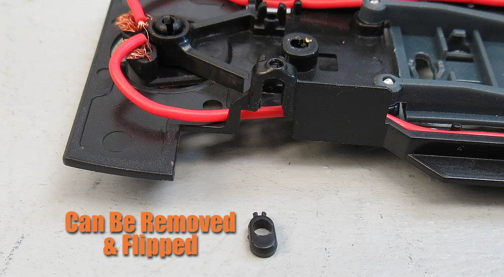

1 - The front wheels/tires: Due to the very low M8D body shape and wheel clearance, are shipped in a 'low' position so not to interfere with the body itself. If tires are replaced with very skinny unit (e.g. Slot.it PT19) then the front plastic bushing can be turned upside down or removed, to move the front wheels to a higher position, lowering the car's stance on the track.

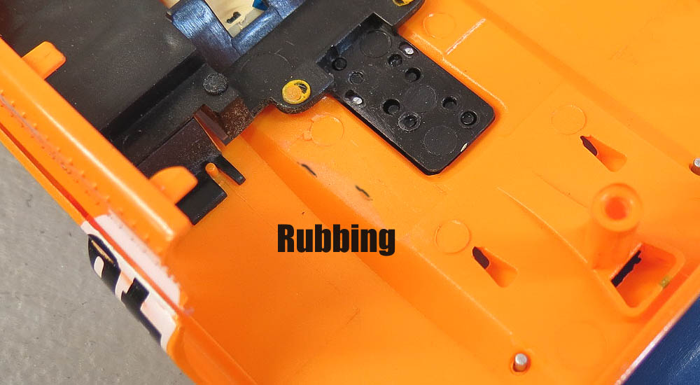

2 - In this specific car (CA26a), we've discovered one minute too late that, when loosening the motor pod, the motor touches the inside of the body. This was due to bad communication with the factory. The car runs still well, but this is not desirable and has been fixed already for the McLaren CA26b (Led Zeppelin car) and the white kits. I suggest, for this car, if necessary, to place a small washer under the rear screw pillar.

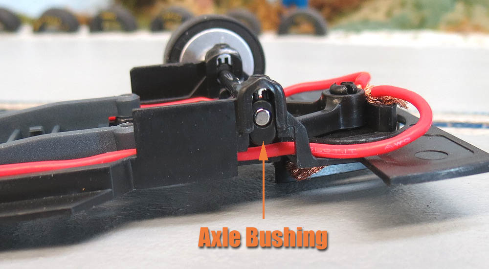

There are oval shaped bushings with an offset hole that hold the front axle. Twist and remove one of the front wheels and you can see them.
The photo above should show you what happens when you flip them. The bottom shows you how high the axle can bet set and why the tires are rubbing the body. In my view, the stock setting is fine. But those that are racing old Scalextric, NINCO, or other track with slightly raised rails then you might want to flip them. I would just sand the stock tires to reduce diameter or purchase tires as already discussed to help reduce rubbing.

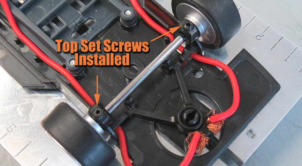

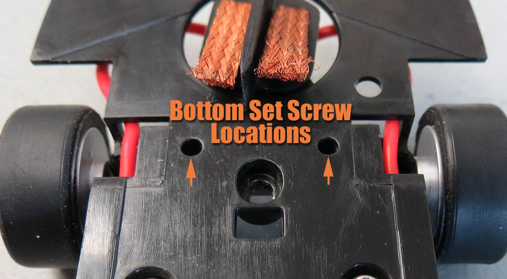

In my opinion these bushings are not my ideal approach for setting the front axle. I prefer to remove them completely and utilize the set screw method. WHY? Because these bushings are sometimes difficult to set inside the chassis correctly. They are precisely drilled and the slightest angle will have the front axle binding. That is one reason why you hear reports of the axle not spinning out of the box.
I like this method as it makes it easier to set the ride height of the axle for the track surface I am racing on. Plus when you set it correctly, the front axle spins freely every time. Just use your setup block to make sure they are as evenly adjusted as possible. If you do not have any spare screws then it's time to order some. I like using the SCC screws shown here. If you are going to start tuning with Slot.it models or using aluminum wheels for projects, having these screws on hand is almost mandatory.
The second issue Slot.it reported is the motor rubbing the inside of the body. I used a black magic marker and heavily coated the top areas of the motor and then pressed the chassis back in place. I moved the pod a little back and forth and then removed the chassis. The ink rubbed off a little exposing the areas. I used a paint tool to enhance the locations where contact is made.
Best advice is to do what Slot.it suggests. Use small washer on the body post to raise it a little higher. Most scale enthusiasts are already complaining about the low height, so this will help fix that easily enough and it does not raise it that much so it would extremely effect performance.
Do not try to sand the body. It is so thin that you will quickly ruin the body with a nice hole in top if you go too far.

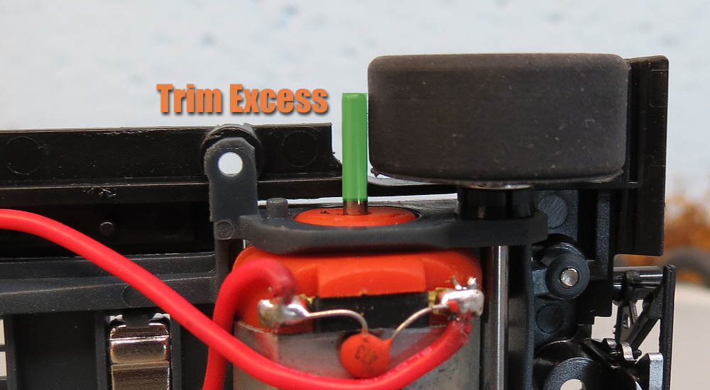

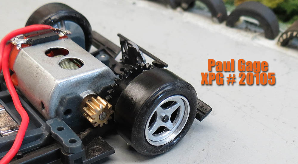

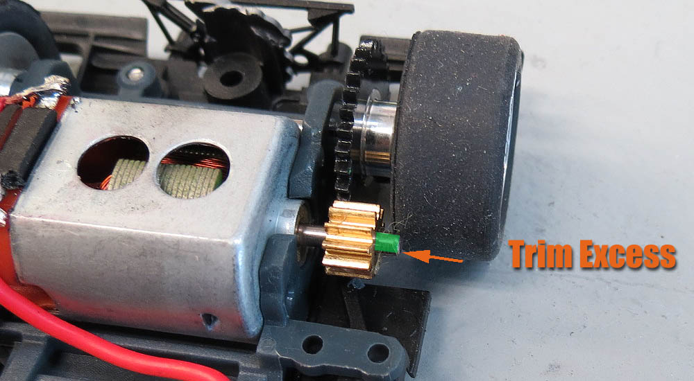

A third issue for me is the motor shaft. It sticks out quiet a bit and is visible from the sides. It also is VERY close to rubbing the tire. Too close for me anyway. You do NOT have to perform this as it does not rub. This is just MY PERSONAL view and sharing it with you.
Solution is easy. Using the standard cut off disc in the Dremel, trim the excess away.

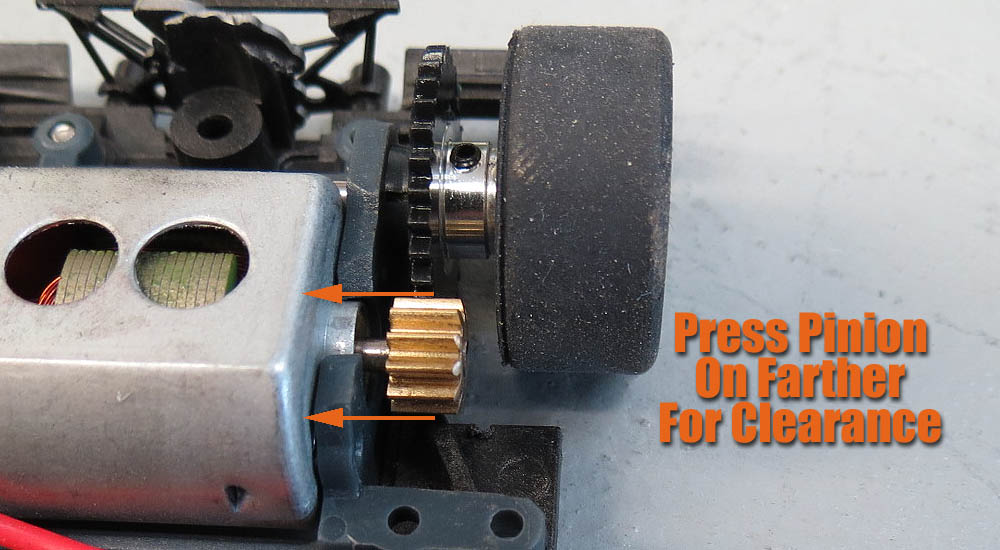

I also noticed the other end could use some trimming as well as the pinion could be pressed on a little farther. The gears mesh ok, but it appeared to me that it could use a little more to compensate for wider tires if you decided to install them.
The tires I chose are the stock size and they fit perfectly. You can try other sizes to suit your taste in width/height.
