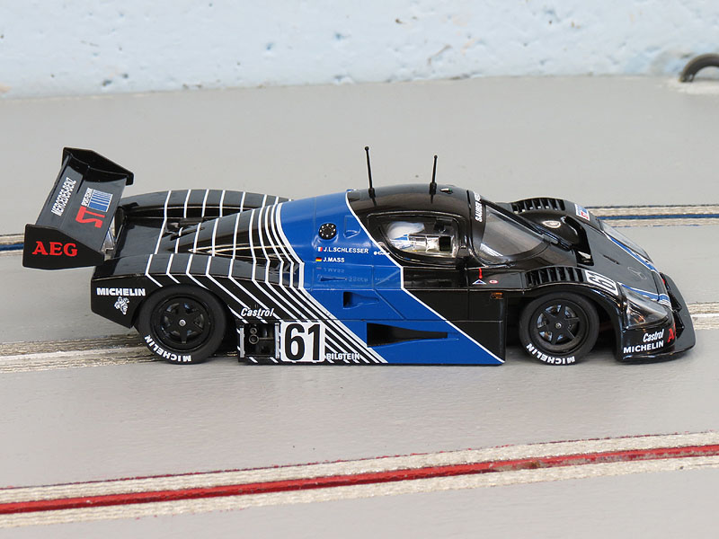

Now that you have done your research, what do you think about the 1/32nd scale effort here? Overall fit and finish of this slot car is about as good as it gets in our hobby. Clean markings as well as an equally clean clear coat seal this model nicely. Maybe the colors do not attract you, but I think it makes the car very appealing.

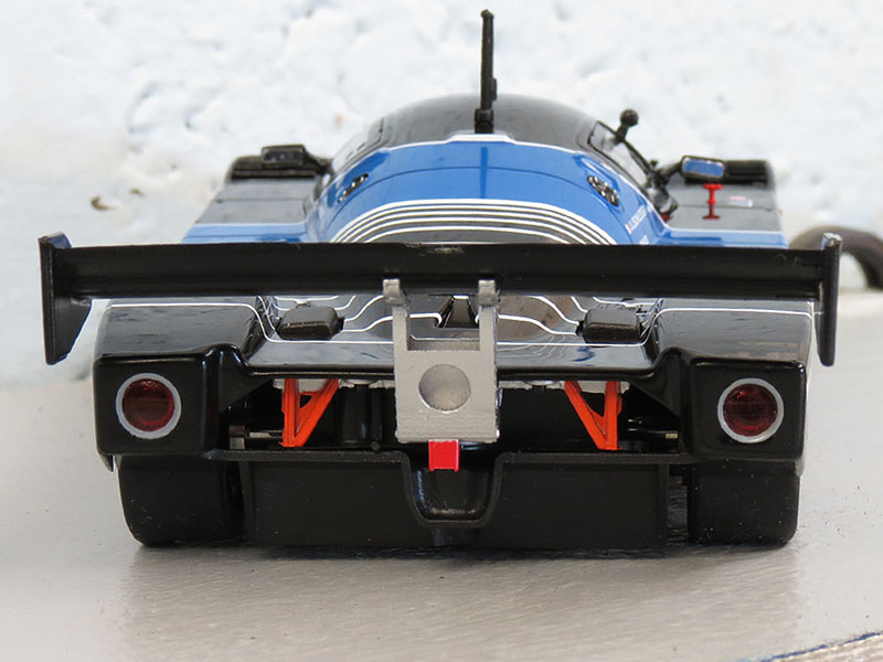

Hopefully the photos allow you to decide if Slot.it has created this model in scale well enough for you. I know they have for me. Easily. The detail level is more than enough for me. Also the little things like the spare wing under the base that adds value to the car. It is plain black, so you could just swap it out for racing and leave the painted original for show time.
That may not seem like much. Until you break a wing and do NOT have another. Maybe you are lucky and you can actually buy one, but sometimes even that is no option.
Wing will take a few good hits, but will break eventually. Spare is provided under the base.

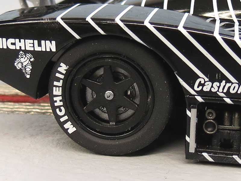

Wheels and tires are standard Slot.it fare. Plastic wheels up front and aluminum in the rear with detail inserts. Rear tires are the C1 compound and work well on surfaces like NINCO/SCX and Scalextric Classic that have an abrasive surface. For your track you will likely choose your current favorite brand.

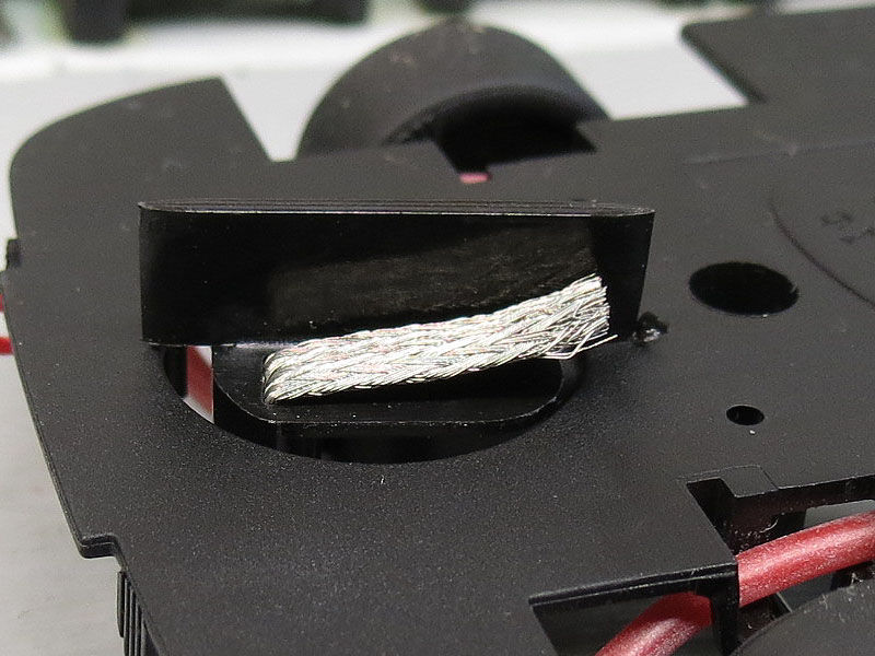

Up front we see the newer guide and it uses the set screws to secure the wires in place.

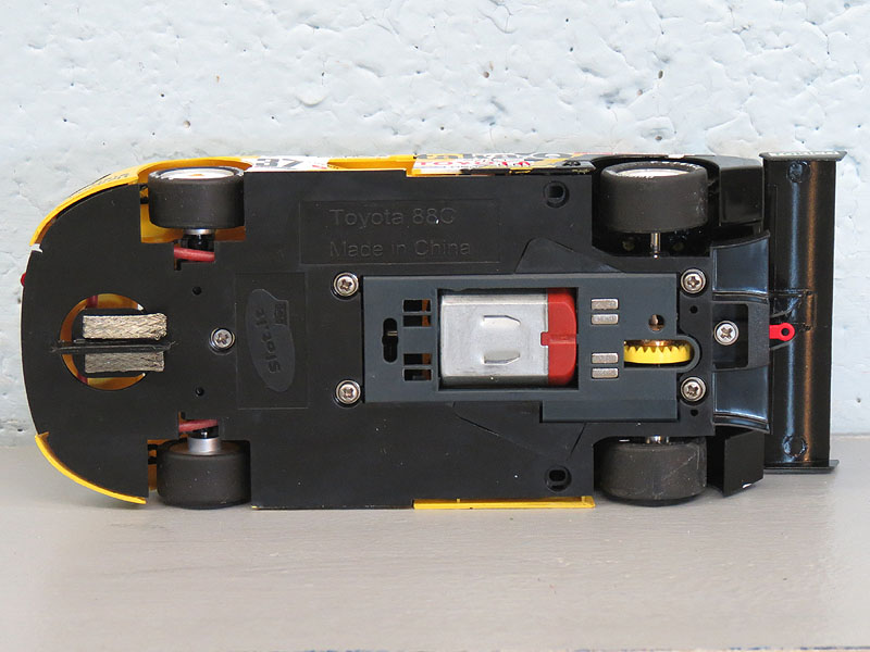

Removing the 2 screws that secure the body to the chassis, we see the rest of the model. Everything here is standard components for this series. MS06 motor with a 9 tooth brass pinion turns the 28 tooth crown gear. The pod is 0.5 MM offset meaning the motor is slightly recessed.
The front axles is adjustable in height if you add the grub screws top and bottom. These are standard features found on most Slot.it models.

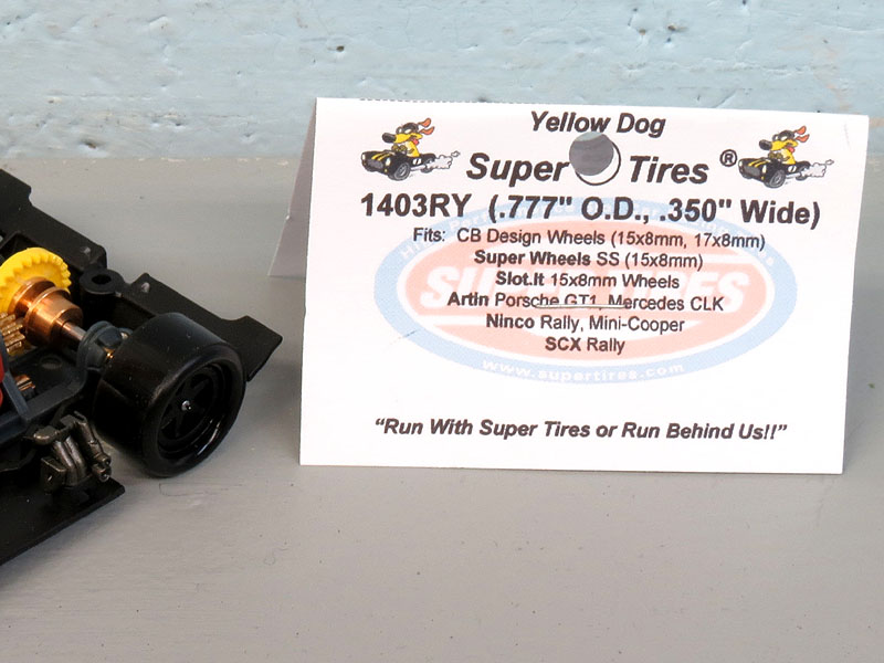

After these initial runs it was time to do a tire swap. On these cars I chose the new Yellow Dog 1403RY (.777" O.D. .340" Wide). I like Urethane based tires better as they can be easily sanded and contoured to my liking.
After the tire swap things improved of course. Lap times for both car now dipped into the 3.630 ranges. I had a best lap with the Mercedes of 3.611 but then I almost tied that with the Toyota with a lap of 3.613.
