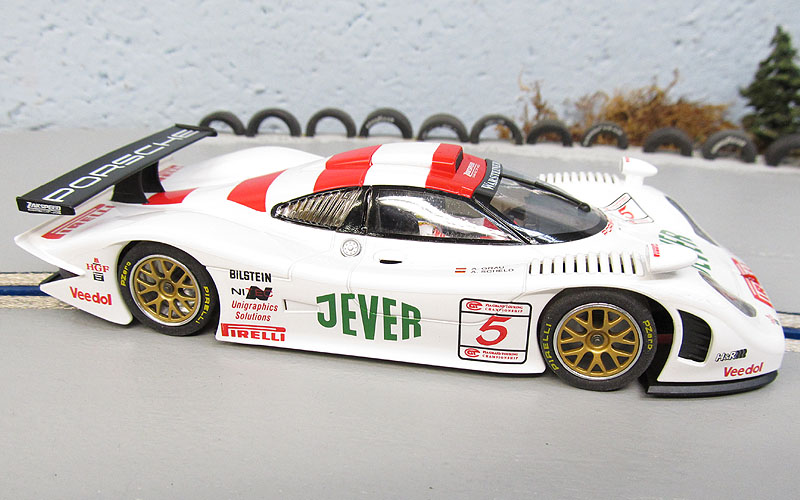

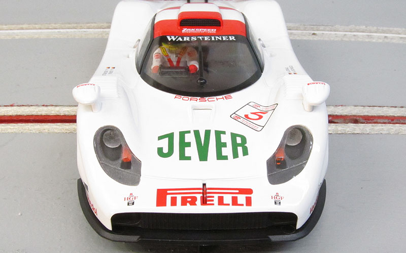

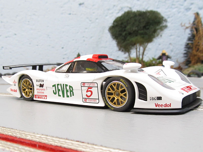

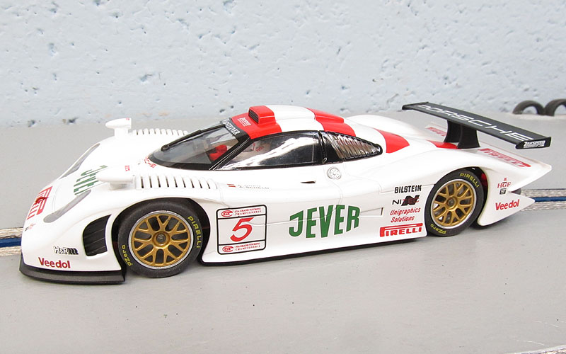

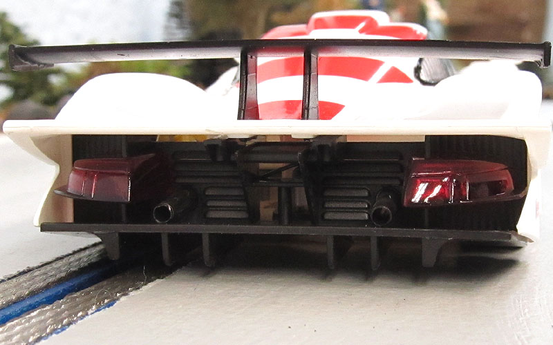

In the scale department it is well done. The prototype police who are passionate about this car will see a few liberties of course. So to nitpick it, it looks like the entire greenhouse is a little on the low side. The rear wing is also slightly smaller than photos of the 1:1 show, although not by much. Finally the distinct fender curvature is again somewhat flattened as compared to the 1:1.
Not that it bothers me. Remember I am just trying to be critical, attempting to see things the pure aficionado would see right away. The fact is I am NOT a Porsche expert. I can only go by photos and using my own interpretation.
In the overall finish departments it gets high marks. Markings are all very opaque and clean. There is a clear coat here but it appears a little dull in the center of the car. It could just be my eyes of course. This body is also very light. In some areas it is half the thickness of the comparable Fly model. This weight advantage is just what hot rodders like to see.

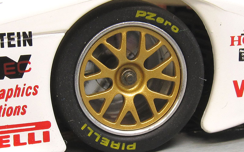

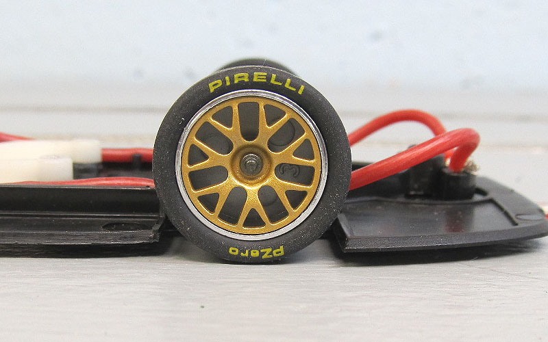

Wheels and tires are also high quality. It has the Pirelli markings on the tires which adds scale appeal and the wheel inserts look great.

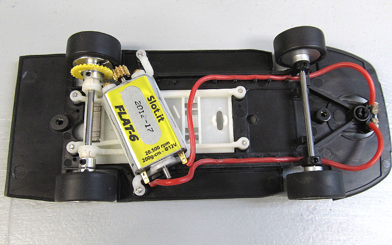

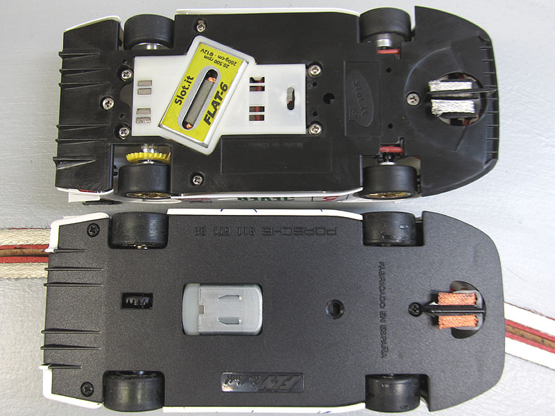

The chassis design now utilizes the EVO6 1.0 mm offset anglewinder system as a standard. There are all sorts of performance advantages to this system but I am not an expert on them. Here is a guide that Slot.it released that relates to this design. It is a couple years old but it applies and hopefully gives you a good understanding of this system. You will need Adobe Reader to open.
I have also included a link for the other technical data here. I think this should tell you all you need to know.
The motor is the same FLAT-6 as we have seen in prior releases. There was some confusion if this motor was the same as others before it that had different openings and wrapper. According to Slot.it it is the same motor on the inside:
"To clarify things, ALL the production (box stock) anglewinder cars, Slot.it and Sideways, are of the MN09 type (yellow) type. Regardless of the sticker, they are all MN09. Early Lola had a MN09 with a bigger hole on both sides, but inside it is always MN09h: in other words the Lola had a MN09h with simple yellow sticker. In production cars, you may find a completely yellow sticker, or the standard MN09h sticker, but it is always the same motor. Now we have unified all MN09 motors into one: MN09h+MN09c = MN09ch, which is the 'yellow' open / closed motor being used now on all production cars. Available as spare really soon now with MN09ch code."

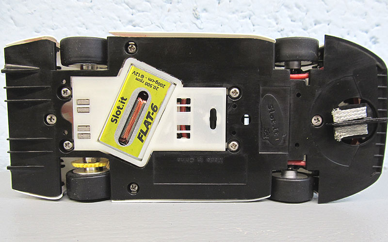

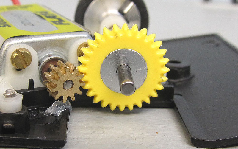

It has an 11tooth pinion that turns the 28 tooth spur gear and gear mesh is very smooth. The motor can be raised by flipping the plate located on the end of the motor housing as we show here.

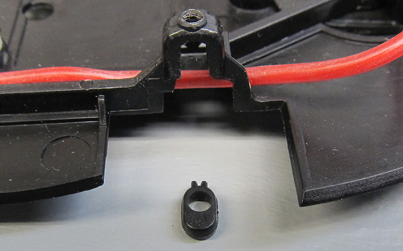

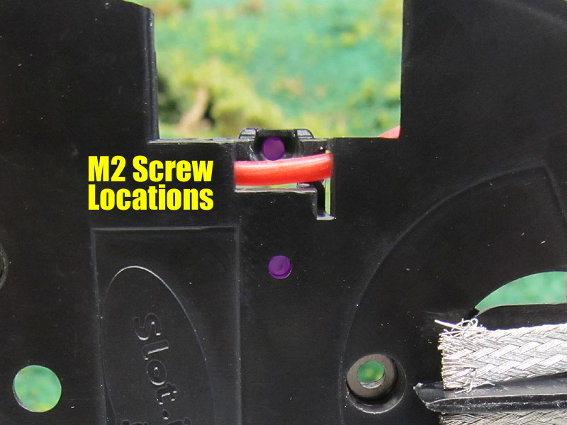

The front axle system is adjustable, but you will need additional M2 set screws. You can just twist off one front wheel and pull out the assembly. Once remove, you can take a toothpick and gently pop out the front axle spacers. Then install your screws top and bottom and begin your adjustment.

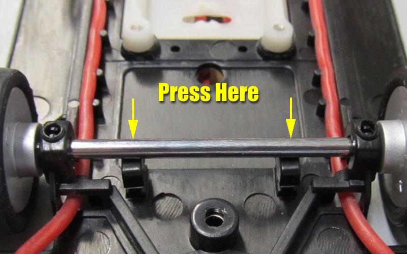

In stock form it sets almost perfect for our track. Sometimes you just need to press down on the axle to make sure the caps that cover the bottom adjustment are fully seated. The guide, along with it's placement allows this car to sit very low.

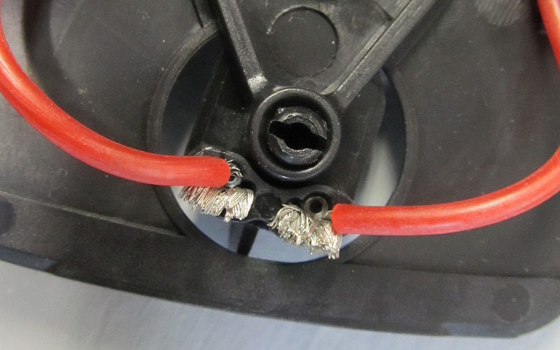

The guide is the snap in type with set screws holding the wires in place.
It is natural for veterans who have the old Fly models to see comparisons. But you experts should know that in the performance department, there really isn't much to compare. In stock form this new Slot.it is a country mile ahead of the game.
This isn't to say the Fly model was a bad car. I liked it a lot. You had to tune it like any other model out there and once you did, you had a very good running car.

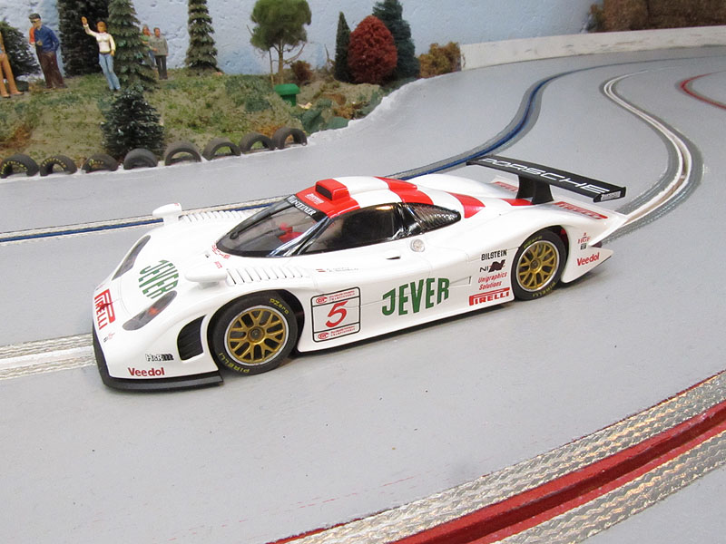

And let me tell you, operation was just as I expected: Smooth, quick, and responsive. This Flat 6 motor isn't a bad powerplant and it works well enough for our smaller home layout. In fact it could easily take a milder motor and still be one of the fastest models on the shelf.
Most advanced racers will do a tire change, but I think that is all you will need to do to match this car to your track surface. I was easily into the 3.6 second ranges and after getting dialed into the handling I even cracked the 3.5 barrier. That is hauling the mail around here.
