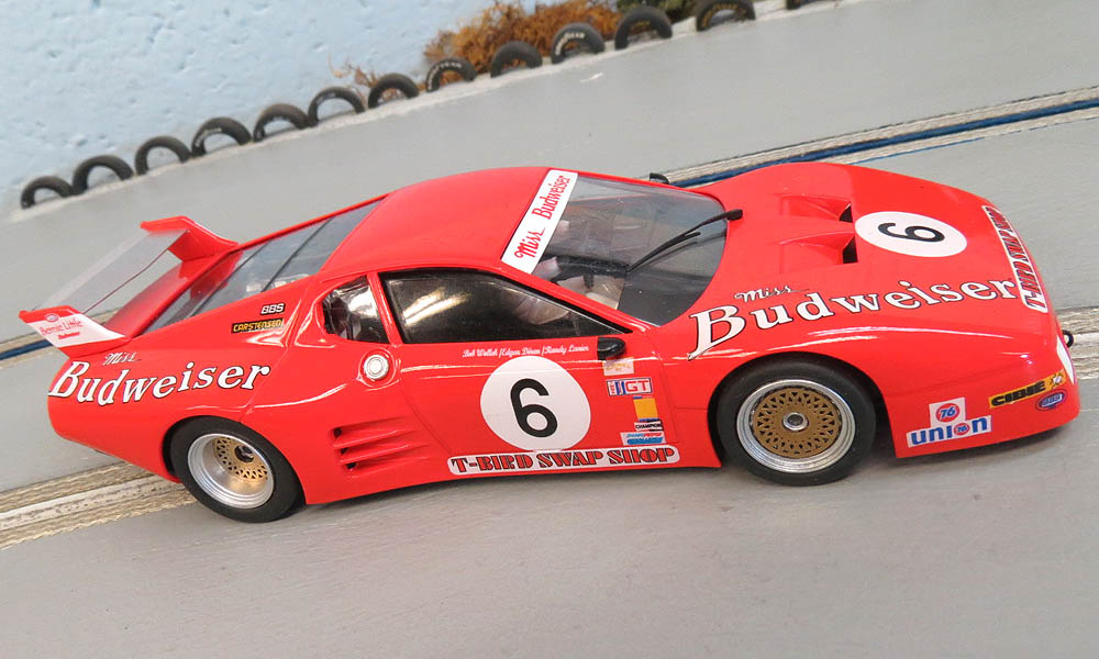

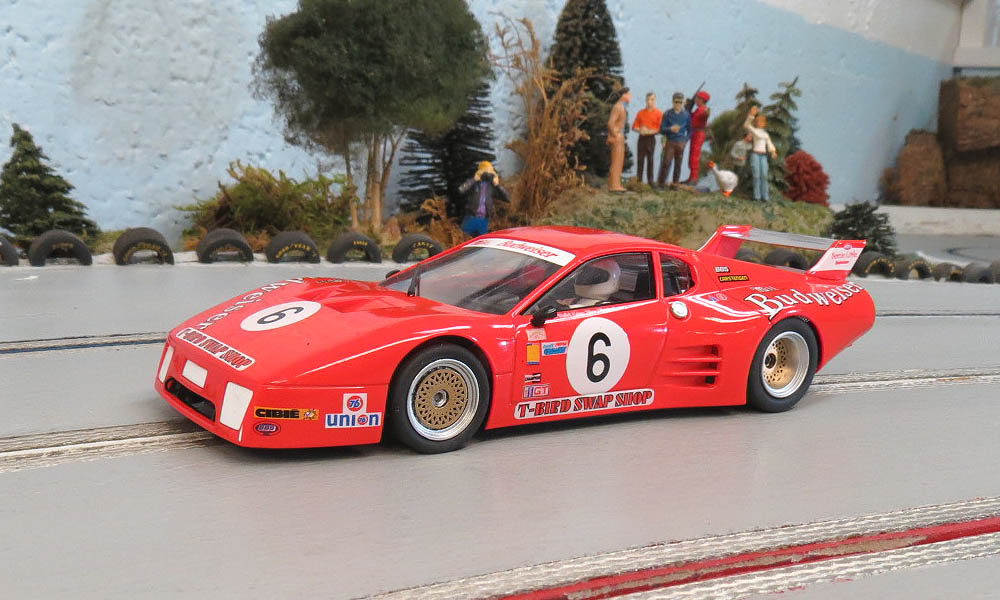

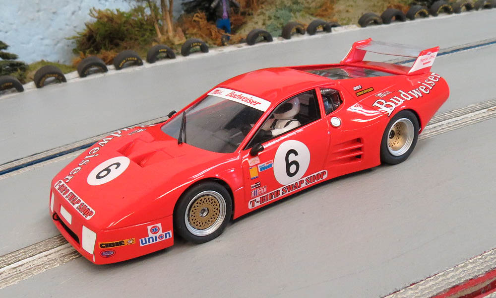

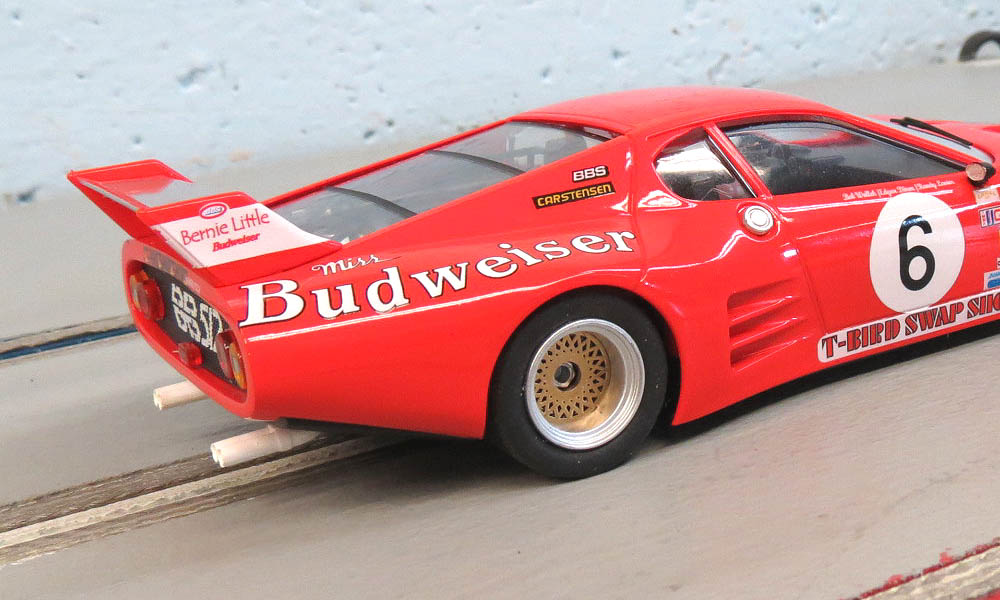

Doing a search on this model tells me that they have done a fairly decent job in our scale. Nothing is ever perfect of course, but not a bad molding in my eyes.

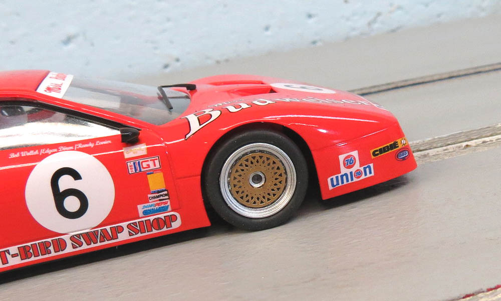

Paint seems a little on the light side to my eyes. It is hard to determine from older photographs but I do not remember Ferrari red or even Bud red being this light. Perhaps it is just my older eyes.

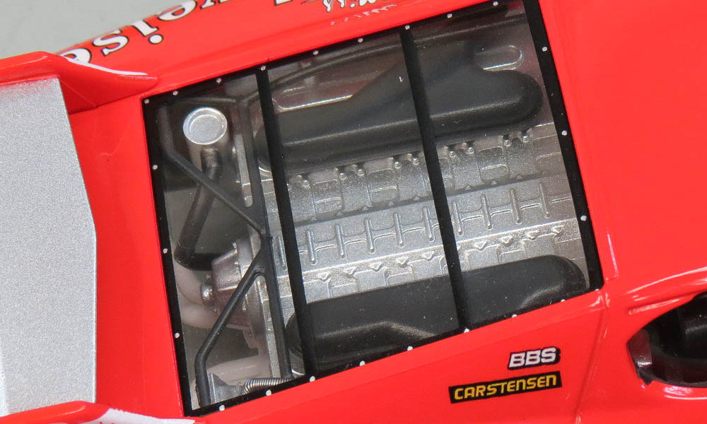

Detail level is very nice all around. Interior is well done although our driver is fairly bland.

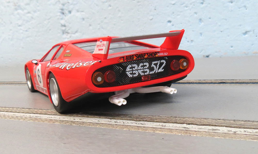

Markings are crisp and clean for the most part. Some slight orange peel can be seen on the roundel up front, but nothing that really takes away from the model.

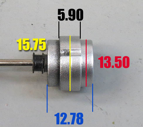

Wheels and tires seem pretty good. Although the front wheels seem shallow compared to the prototype. Markings on the tires are absent. Tires seem fairly soft though and I was happily surprised with that. Of course nowadays you favorite aftermarket tire will find it's way on here rather quickly.

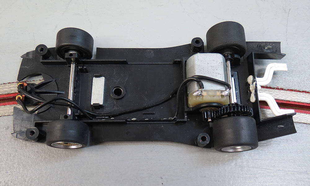

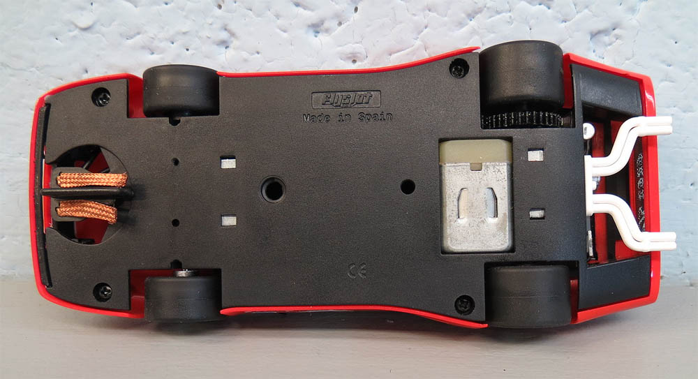

You can see 2 bar magnets in this chassis plus the sidewinder configuration. We also see the FLYSLOT logo and Made in Spain.

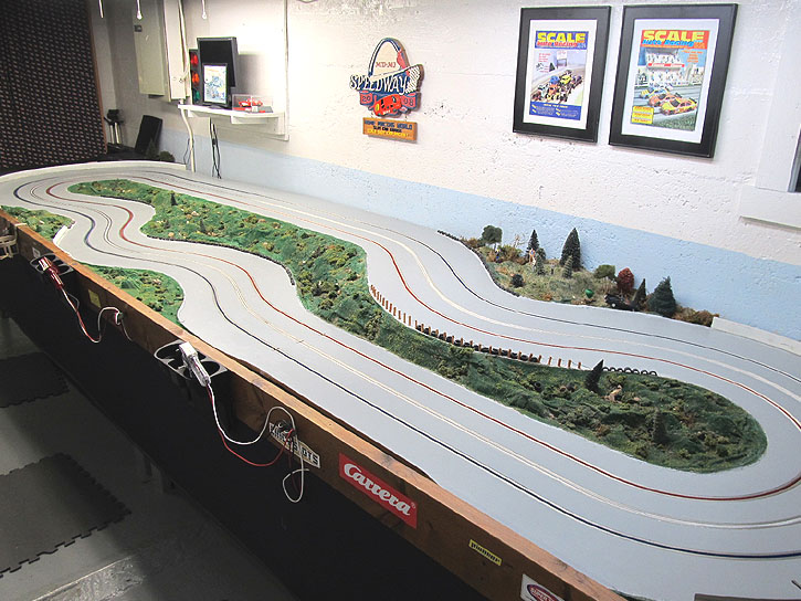

MIDMO
International Speedway
SCC Braid/Flush Mount - Pyramid PS26KX Aftermarket Power @12 Volts
2 Types Of Control For Testing - Professor Motor 2110 Controllers/Parma 25 OHM

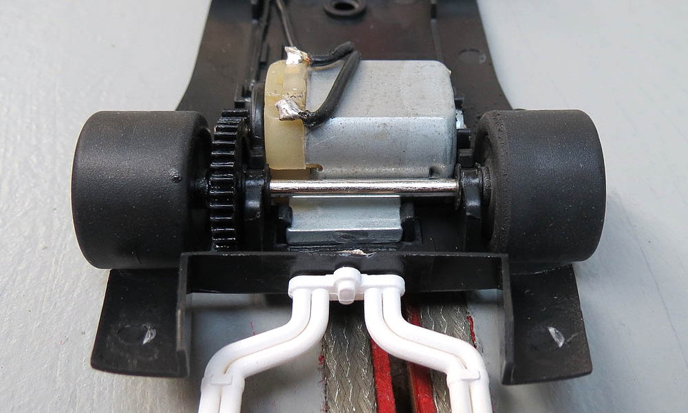

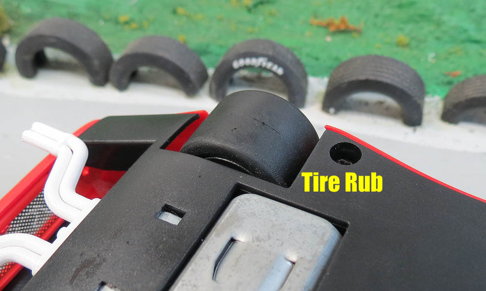

The car moved a few feet then I noticed it seemed like it was binding. I lifted the rear of the car and could clearly hear it struggling. I let it run a few seconds and then noticed the issue. Seems the inside of one of the tires was rubbing somewhere.
Sound familiar?

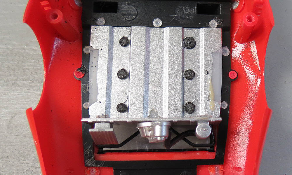

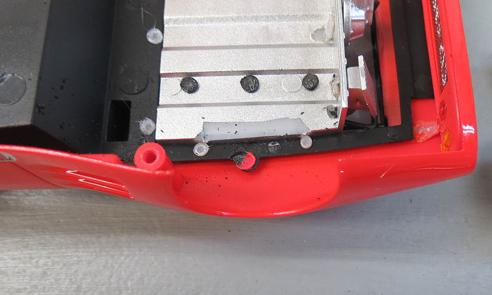

Well, time to take off the body. Removing the 4 screws we get inside and I noticed right away the people working on this car realized there was an issue with the tires rubbing. This is evidence where they have sanded parts of the engine detail/interior tray to prevent it.
You can see the tire particles on the left.
I will give them credit for recognizing the issue and trying to correct it. I realize some of you will feel differently, but just to see an effort made is more than I have seen in the past.
Since we are inside, let us take a closer look. Gears are plastic with a 11 tooth pinion and 35 tooth spur gear. They likely chose the 35 instead of a 36 so the diameter is less and would help prevent the gear from dragging the track once the tires were sanded. The motor appears to be a stock Flyslot motor. There are no markings, but the performance of it suggest this is the case.
You can see the rear bar magnet placement a little easier. While we had the body off I tested the running gear and yes, the bushings spin in the chassis. You will either want to glue these stock bushings in place or wait until you change out the running gear.

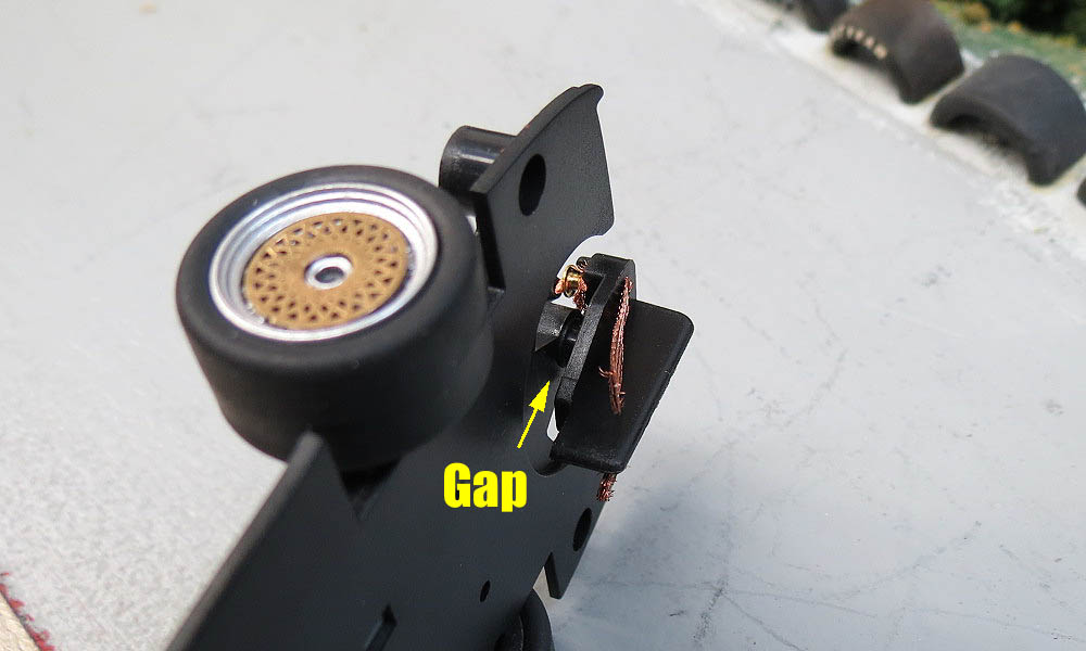

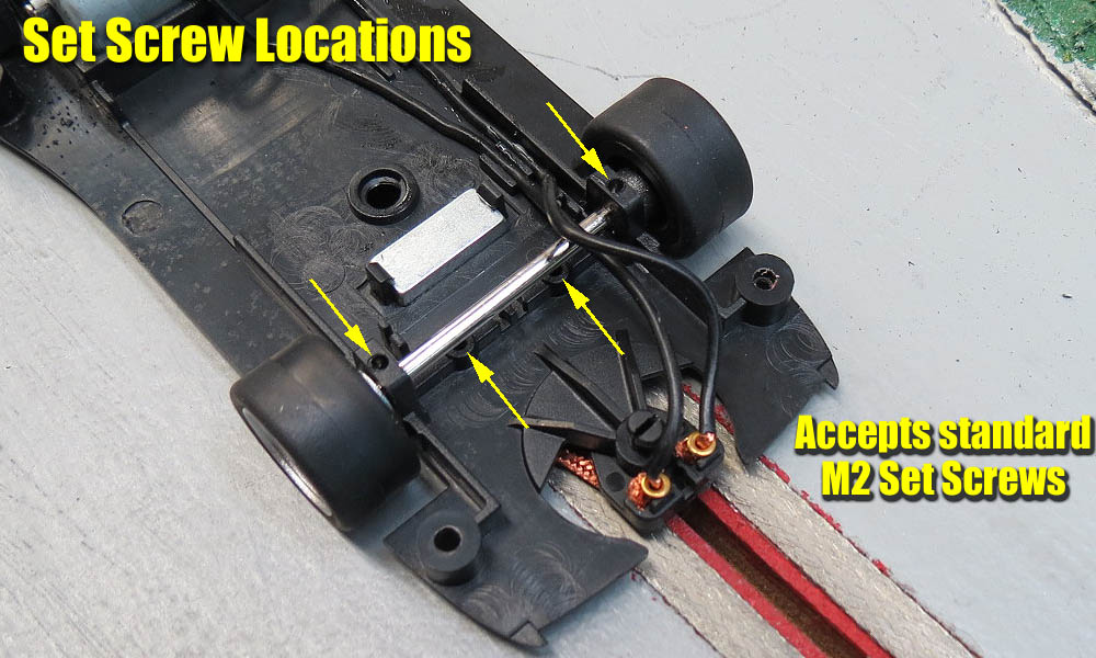

Up front we see they have included an adjustable front axle configuration. Reminiscent of Slot.it and early Spirit models.
What frustrates me is the absence of the set screws to utilize the system. In my eyes there is no reason to force the enthusiast to provide these. There is basically no added cost and we could then begin adjustment without having to order them. Yes, I realize most advanced enthusiasts have them already. But what about the newcomer? Perhaps I am being very critical, but if you are producing a model that has this feature, then at least provide the screws to use it.
Not that it would make a difference in out of the box performance. Because the front guide has not only an extreme amount of vertical free-play, the guide fits so tightly in the mount that it takes a fair amount of pressure just to turn it. You will likely need to remove the guide, which is not that easy given the tight fit, and then use a rat tail file to sand the inside of the mount hole.
However, if you plan on converting it to a Slot.it guide, don't bother. Those guides fit perfectly. And that is really what you will want to do rather than stacking a lot of shims on this one.
Once the tire rub issue was solved by lightly sanding the inside of the tire, it was back to the track. The tires gripped decently but most racers will do a tire change rather quickly.
