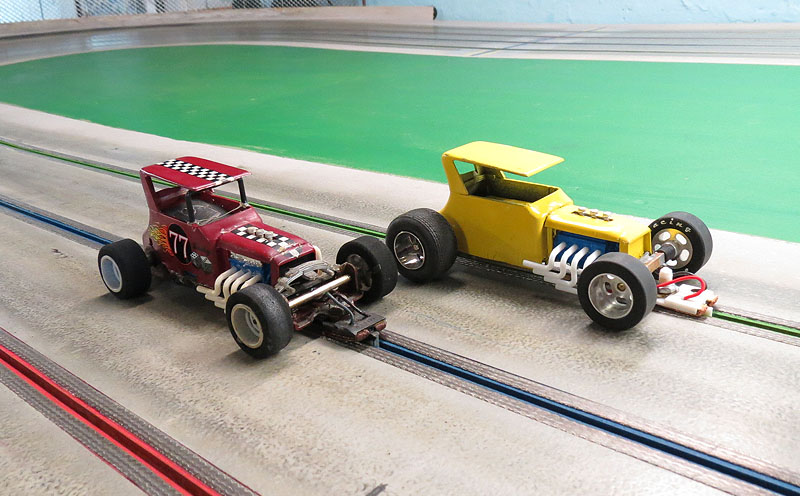

Postby DixonJohn » Sat May 04, 2013 12:24 pm

Postby HomeRacingWorld » Sat May 04, 2013 12:36 pm
Runs pretty good too :)

Postby RazorJon » Sun May 05, 2013 8:13 am
I am building that same car

Postby dreinecke » Sun May 05, 2013 9:38 am
This is going to be good! Looks great so far Jon.

Postby The Blue 7 » Sun May 05, 2013 3:11 pm
Lookin' Good. :clap:
I'd like to see the frame. :geek:
Who's tires ?
Thanks

Postby DixonJohn » Sun May 05, 2013 7:50 pm
Did some testing and I must say it runs rather well. Already has some track rash as the paint is still wet but do you think Harry gonna give it an easy run??? Blue7, the tires are Paul Gage. Motor came from a Carrara Mustang and the chassis is some 3/32 square with a JK F1/Indy motor bracket. The front axle tube is 5/32 square. Gearing is 9/29. Had to go to the 29 tooth to clear the inner body work.
