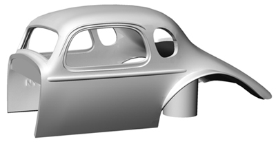

That '35 Chevy Coupe is something I drew from scratch of a specific race car, it is not a scan or anything, and it will be 3D printed. Currently I also have a '37 Chevy that is in the works that will be more useful.
I may just 3D print one body at a time as needed, or as you say, print a single master and pull a mold to knock out resin copies - whatever makes more sense as far as quality, durability, convenience, and cost are considered.
Any subject, any scale is certainly possible.

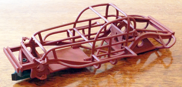

I revised/scaled the proto-chassis 102.8%. This bumped the wheel base another 2.5mm, so it would be closer to the actual car in strict 1/32 scale.
Here is the print with a shot of Krylon primer.
CHASSIS VERSION 1.1-
The first one was delicate - I deliberately went right to the bleeding edge of the printer. I wanted to see what would happen at the limit of fine printing. It worked but it was delicate. I did bust it up running test laps, and it was too easy to 'torque' and 'torsion'.
UNPRIMED UPSIDE DOWN-
I extended the 'guide plate' to the midpoint crossmember, and I thickened all of the roll bar tubes about 30%. They look a little thick to me know, but I think they will pass (I may take them down 10% from where they are now in the next iteration...).
Anyway, the increase in strength significant. I had added small tubes that spring steel or piano wire could be run up through for added structural strength, but I see that will not be necessary now. Apparently all the triangulation and structure of the full cage really stiffens the whole setup with the added thickness of the bars. I also changed out the guide mount/position to be more discrete and 1/32 friendly.

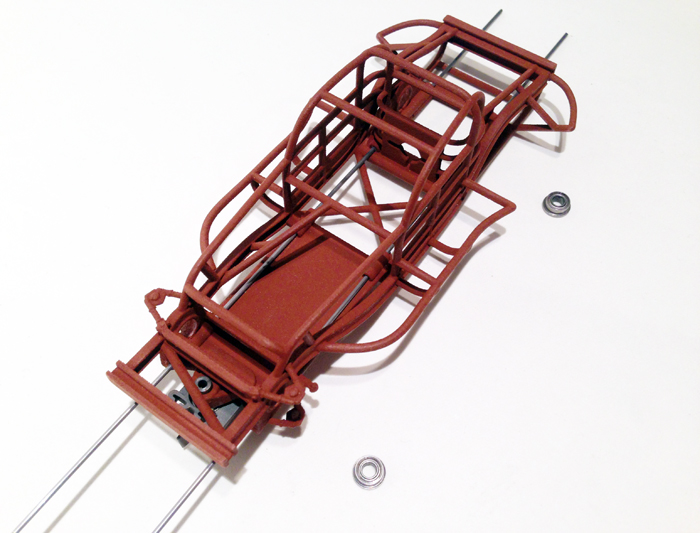

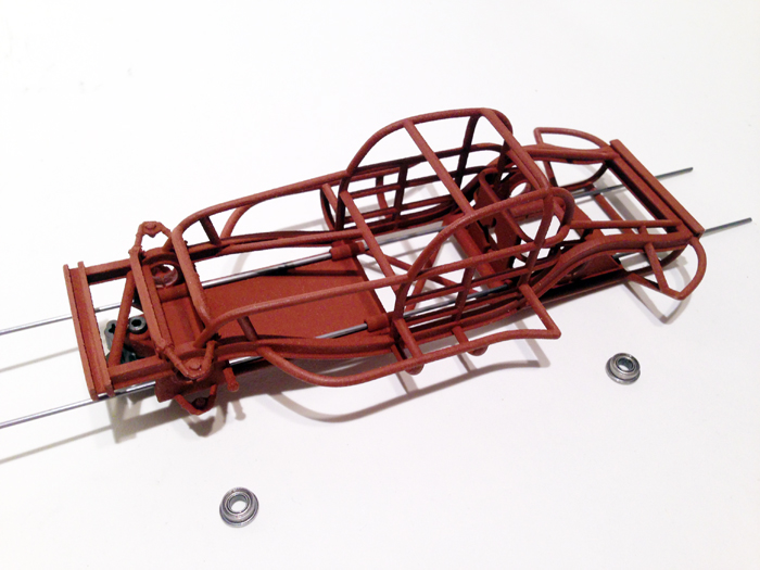

I designed up the "version1.1" chassis with tubes/supports 'cast in place' to accommodate reinforcing .047 spring steel, in an effort to add some stiffness to the all-plastic chassis.
The system works well, and if the car is built up with wide urethane tires, or grippy foams on a lightly glued track, I suspect the added rigidity will help make it a better runner.
LONGITUDINAL "TORSION" BARS-
Naturally I will trim them to size, and they are optional I suppose, but they slide-in firmly and definitely add integrity to the structure. They don't look out of place either, as the real car - the Jarzombek Coupe, used a Chrysler Torsion bar sprung front suspension setup...
GETTING MY BEARINGS-
I set up this chassis to run standard Parma 1/4" diameter oilite bearings for both the front and rear. These are common and are available for both 3/32 and 1/8 axles, which allows options. This setup should guarantee a nice solid quality setup for excellent running/racing. I am going to use flanged ball bearings on this one. They also fit the 1/4" boss/bung perfectly with a nice press-fit.

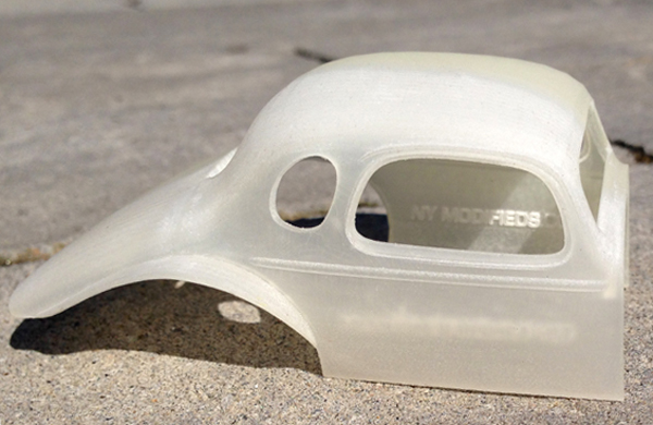

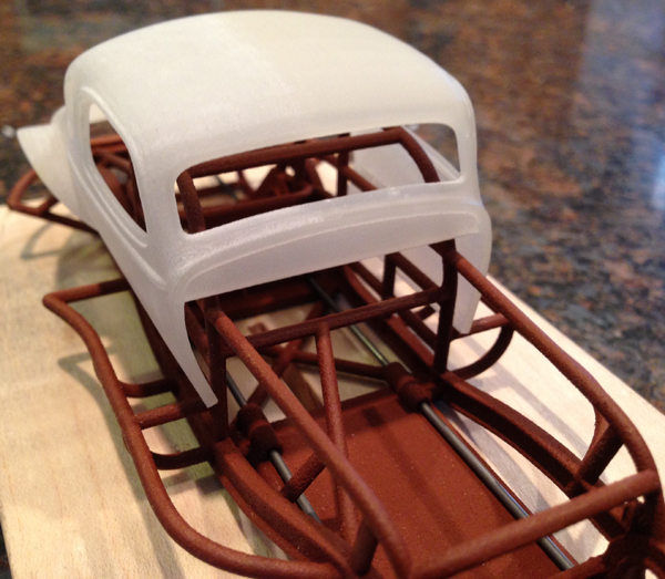

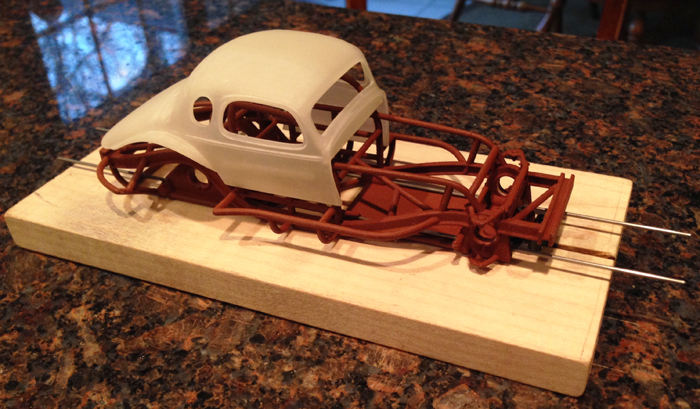

I have the printed body in hand and I am very pleased with the quality.
This is what it looked like right out of the printer with no sanding/finishing.
3D PRINTED BODY SHELL-
The body has pretty sharp detail and fairly smooth surfaces. There is a slight translucency to the material. I even added embossed "nymodifieds.com" lettering/identification to the inside surfaces of the coupe.
I placed it on the chassis and it looks to be an excellent fit.
BODY ALMOST ON CHASSIS-
I have to notch the Coupe to fit the bars/cage here and there, but remember this is version 1.0 - the first body shell printed.
Here is another view.
BODY CONTOUR 3/4 VIEW-

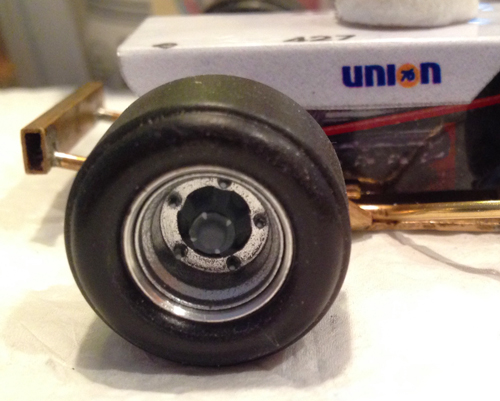

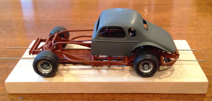

UNIQUE WIDE FIVE WHEEL INSERTS-
Here is another item from the same printer pass. I made these up in an effort toward creating a true-to-scale wheel/insert.
They fit inside the smaller Pro-Track sized rim. Again these are unfinished 'first pass' pieces, but so far I threw on some paint and they are looking the part. The tires are smaller hub Paul Gage pieces.
I put a little primer on it.
PRIMED FOR ACTION-
Still no bodywork - I just put some paint on it and let it sit way up high on the chassis for now ("the arms aren't drawn in yet").
I can see the inserts, and the overall look, and using the 'imagination ray' I can almost see where this is going if I squint my eyes just right.
