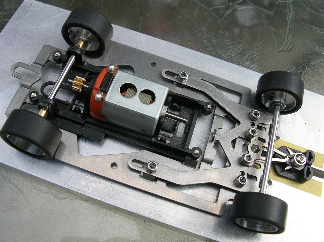

An inline Slot-it pod installed for demo purposes,...the chassis will take Slot-it/Racer/Scaleauto pods, in any configuration.
**** Note the long length slot at the back of the chassis...this will accept varying body post locations

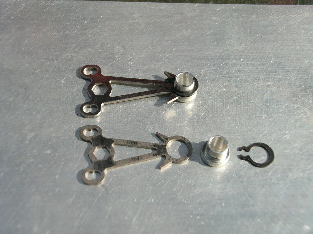

Also note the "Hex" hole on the guide tongue, just behind the guide......more on this in a minute !!
While each individual tongue has 2mm of adjustment, there are longer tongues available....the kit comes with the shorter tongue.
The guide post holder is secured to the tongue with a "C" clip. and the close tolerances result in imperceptible movement.
The kit comes with a guide post holder for MRSLOTCAR/Slot-it guides....a post holder for Scaleauto etc. is available.
One cool thing here is that the post holder rotates in the guide tongue (with almost no play)....so, the guide can be securely screwed into position, without any filing/sanding needed to achieve a very consistent/free rotation.
The "Hex" hole at the rear end of the guide tongue is the positioning point for the raised "hex" machined into the body post insert.

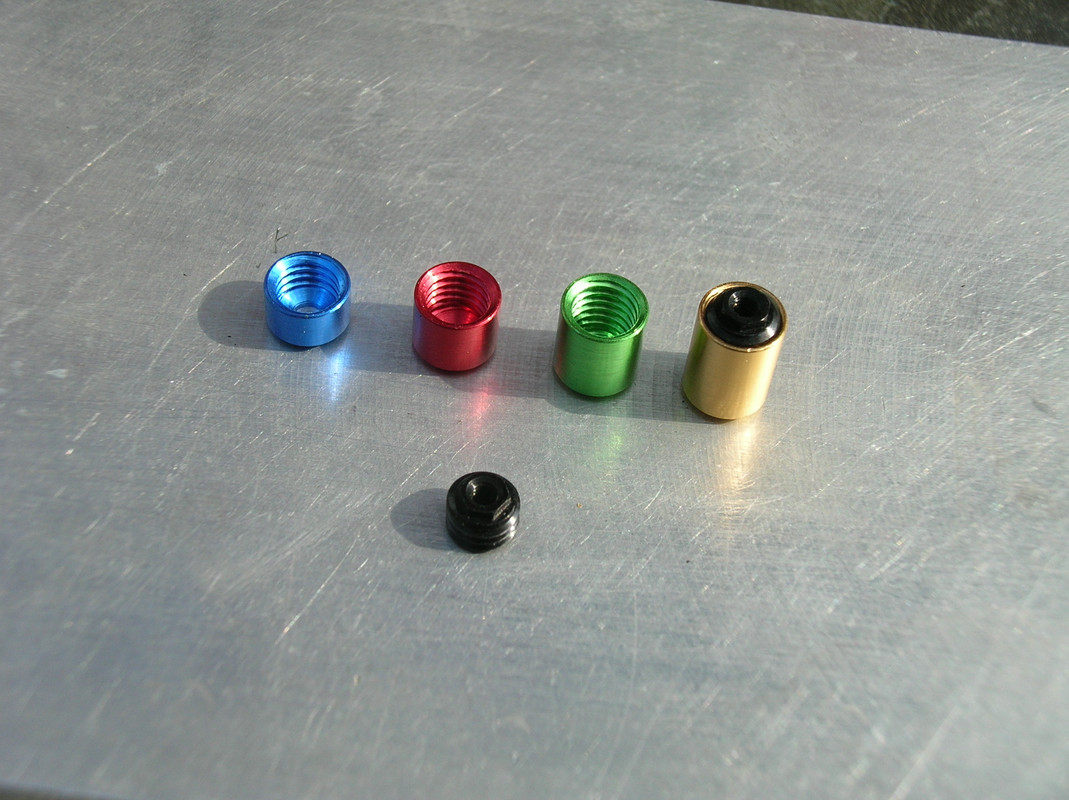

These are the anodized aluminum spacer tubes that allow for chassis/body mounting..they come in 4 lengths (in the kit), so that the chassis/body clearance can be adjusted.
You will also notice the black anodized aluminum bits that thread into these spacers....it is a bit difficult to see, but, these black anodized bits are machined with a raised "hex" nut shape on one side....these "hex" nut shapes fit into the hex shape cutouts on the chassis to 1/position the body, and 2/ to ensure the inserts to do twist/move in the spacer tubes when the body mount screws are attached /removed.
The supplied body mount machine screws (included) hav been treated on the ends with "blue" locktite , so that the screws will not vibrate out. (This locktite coating will not obviously last forever, so at some point these screws will need to be re coated,...either with locktite or a drop of ShoeGoo etc/)

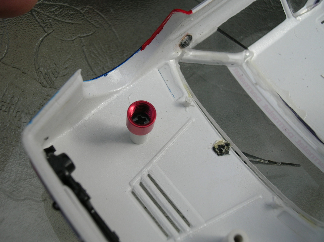

Just for demo. purposes, I have attached a spacer tube (it just screws on) ) to an existing body post...then the little black "Hex" piece is threaded into this tube and .....the body screwed to the chassis. (Final body mount screws are also included with the kit. The black anodized aluminum "Hex" inserts allow for very fine adjustments in body ride height,
