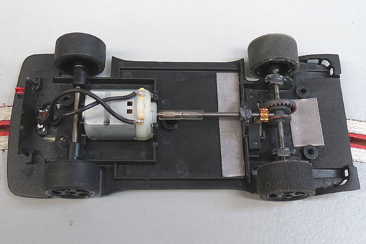

As silly as this sounds, I never would have thought to trim that side of the motor shaft. That's an excellent tip!

That's exactly how I do mine. I just hook the motor up to my power supply, and run at about 3 volts, take the Dremel with a cut off wheel, and slowly cut through the motor shaft. Makes a nice neat finished end on the shaft. :)

Well finished it off. Not much more in mods here. Just PG tires. Wheels were straight, just needed a good truing session.

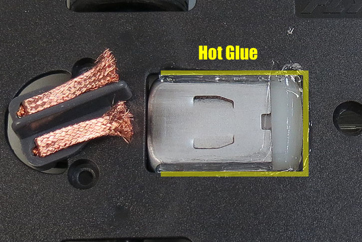

Used hot glue to secure the 3 bushings. Used flexible tubing for the new motor shaft connection. Little of my break-in "stuff" on the gears and things are pretty smooth. Not looking for these gears to last a long time (gray) but so far it is all right.
Used a little hot glue under the motor to keep it secure and stop the rockin' :)
All in all it was fun working on this old ride.

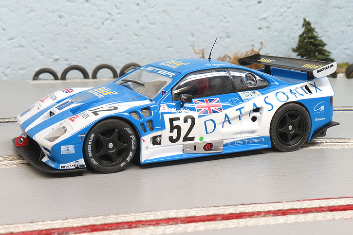

Funny. Even though these are older models, you would be hard pressed to find better detail. Fly really did a decent job.
