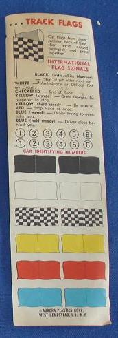

Bibbster - I never had the budget for the anything other than these as a kid:
I had about a million of them at the time though as they really dressed the track up!
