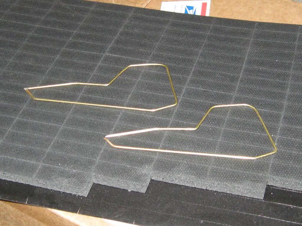

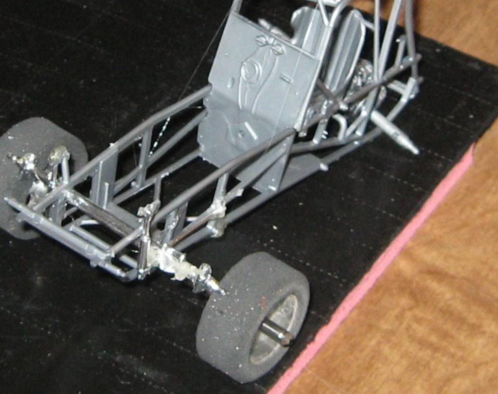

The first thing I did was put the model frame and drive train together

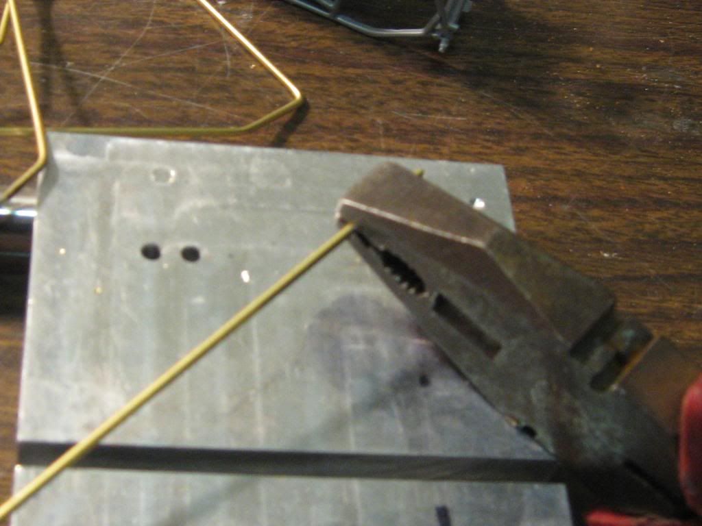

I made the sides of my frame next, I just used .062 brass rod and some cheap old pliers to make my bends
I placed the rod on the side of the plastic model frame and copied the bends

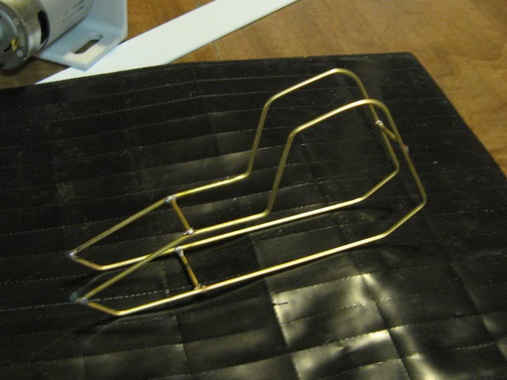

With my sides done I connected them with cross rails

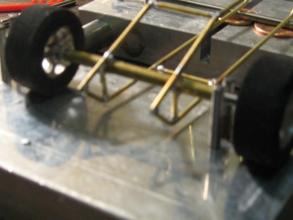

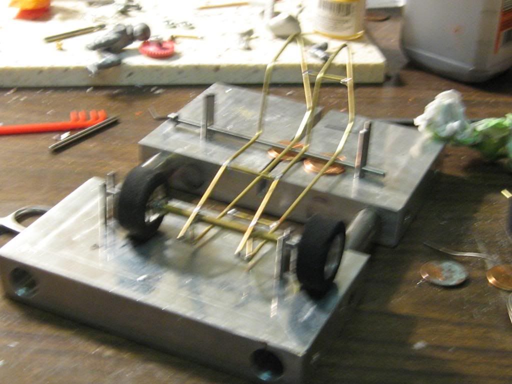

I then used the model to set my jig. I added some up-rites to the frame and attached my front axle tube
I used 4 penny's to keep the frame off of the jig
thats all for today,
