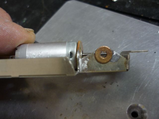

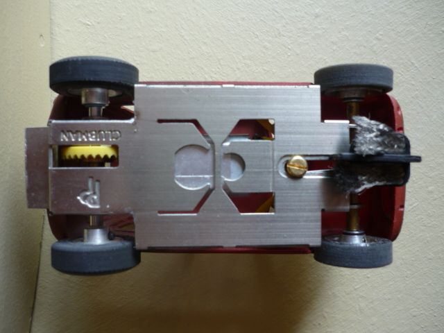

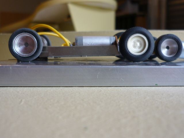

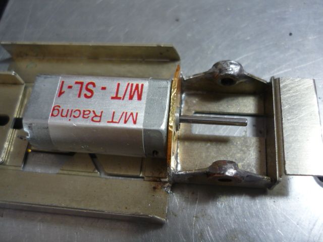

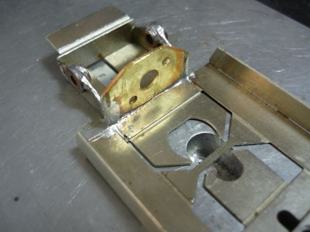

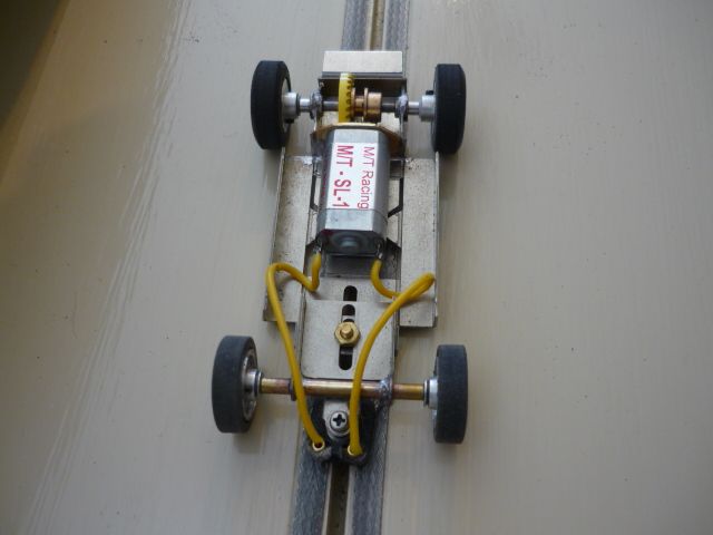

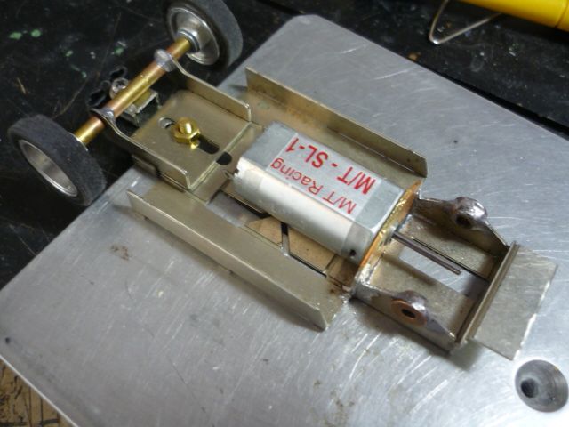

This is a small chassis designed for small saloons. It is intended that a FC motor type be used but I have put an FF motor in. If the motor uprights are left flat the FF motor sits down and meets the axle nicely. A motor plate needs to be made up first.
I have never used a PP chassis before but this runs smoothly and quietly. Next I need to sort out a suitable body.

Nice build! with that adjustability, any body should work great!
Re: Penelope Pitlane Clubman chassis with FF motor
Postby HomeRacingWorld » Thu Oct 30, 2014 6:35 am
Never worked with this one, well done showing how you altered it. Smart thinking with that adapter.

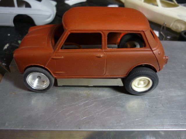

Would this one fit in a Mini?
Looks as though it might.

After looking at an airfix Mini body and the chassis i would say yes it could be made to fit.....if you could overcome some issues.
To my eye the main issues would be the rear "kick up flat" of the chassis would have to be taken off. The slot in the guide tongue would need filing back so the guide could retreat just a tad and the lock screw underneath would have to be very flat or removed if you used 13" rims and tires.ie the chassis parts would need to be soldered or glued together. Chassis width is no problem as there is another narrower line that the chassis could be folded to.
