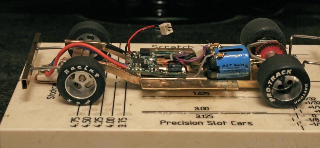

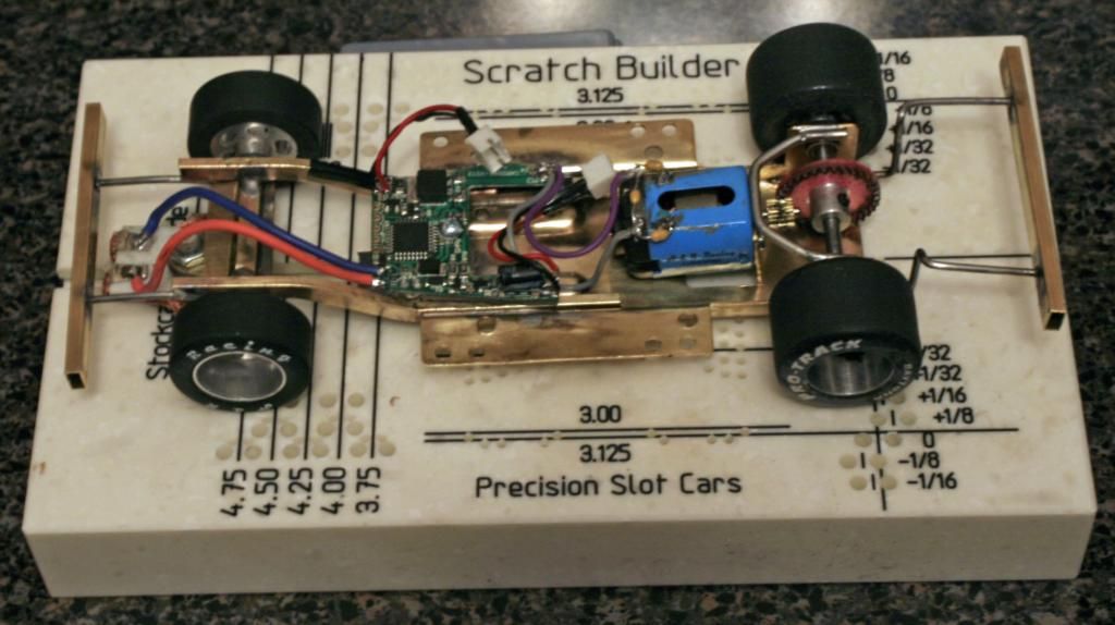

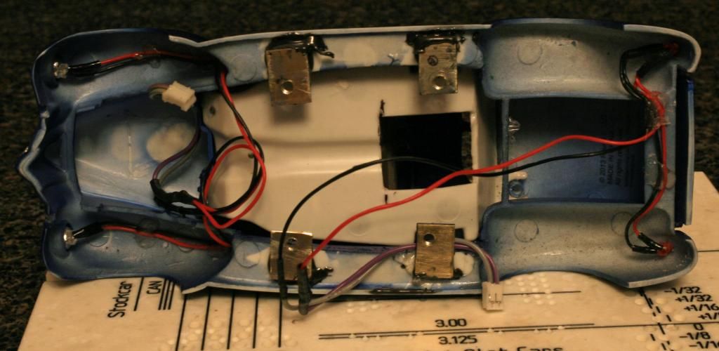

Postby KD11 » Mon Jan 26, 2015 12:45 pm
I have attempted my first scratch build chassis. I am running a Carrera digital 132 Oval, so I knew I would be adding the Carrera digital module. I had purchased a 1940 ford coupe AMT model for the body and had purchased a H & R chassis. I could of used the chassis as is but decided to follow Harry's instructions the best I could to build the front rails. My first attempt was ok but I didn't bend the chassis rails straight, slightly bent off to the right. I decided to solder them in anyway and boy was my soldering ugly!! I soldered on the front axle tube and guide mount. Now I had to figure out how to mount the digital module as it is to wide to set in between the rails. I used some double sided tape to hold the module in place so I could test to make sure it worked and the car would activate the lane changers. I temporarily mounted the body and tested the car. All seemed to work ok but I needed to redo the chassis rails and clean up the ugly soldering job. With the chassis rails fixed and chassis cleaned up I then added a piece of brass to permanently mount the digital module. I used the original car interior and mounted the body using brass tabs that I tapped and screwed onto the chassis. Then I glued the body to the body mount tabs. Tested the car again and it seemed to run ok but the H & R tires did not have any grip so I purchased a pair of Pro-Track silicone tires from our local shop. These are better but I will purchase a pair of PGT tires in the near future. Next was to paint the body, this turned out to be real pain. I thought I would learn how to use an airbrush and use Acrylic paint. As it turned out it is easier said that done. I have lots to learn about using an airbrush as the paint still isn't dry. I guess on put the paint on too thick or didn't let the previous coats dry. Anyway I decided to add the LED headlights and tail lights. All in all I think it turned out ok and I have begun the learning process of finding out what works and what doesn't. Thanks to all of you that provide such great information for us newbies.
