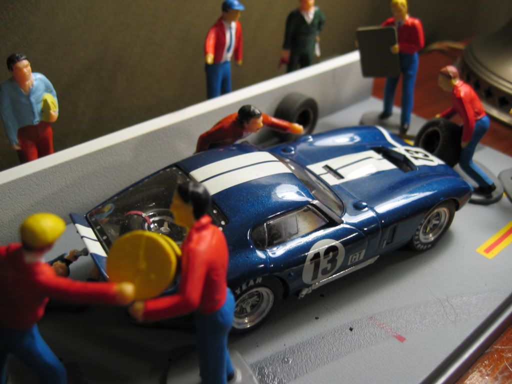

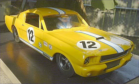

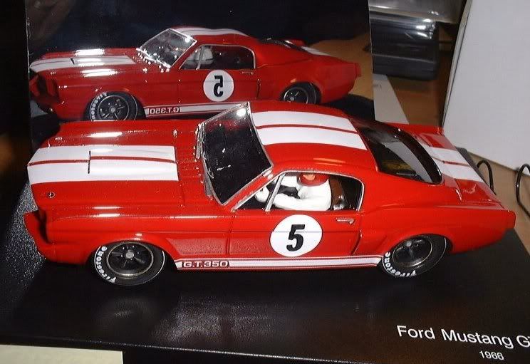

Postby Jesla » Wed Jan 01, 2014 7:33 am
You can get just as good a finish from a Rattle Can as most can do with an air brush.
Just read and follow the directions on the can. If you don't like the way it came out
out then strip it and do it again. I re-did one car four times before I got what I wanted.
This is a Rattle Can paint job....
As is this....
and this...

Postby Audi1 » Wed Jan 01, 2014 10:46 am
Thanks Jesla,
How to you do the detail around the windshield and windows; for example the silver outline on the red Mustang GT 350? This is a challenge that I know I will face after painting the body color on the #7 car. Is it done freehand or do you mask if off and re-spray?
Re: Adamowicz Porsche 911S
Postby Jesla » Wed Jan 01, 2014 12:13 pm
I use a silver paint pen, you may have to trim the tip. Take your time.
Also I clear coat before the silver, it makes fixing mistakes easier, and
final clear coat after the silver and decals.
