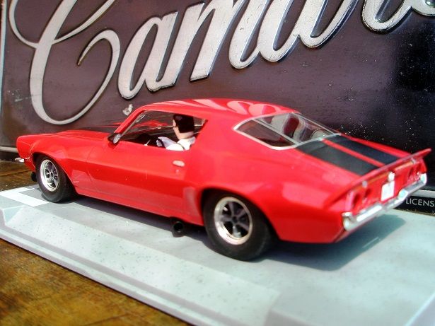

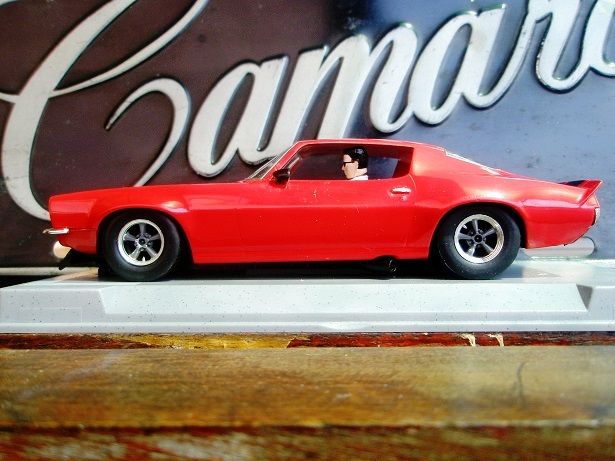

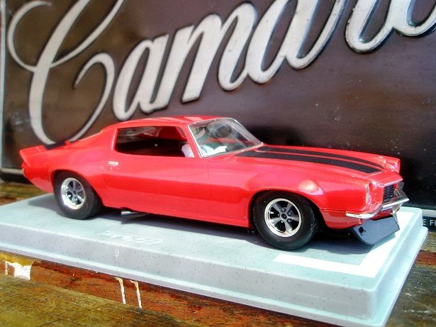

Ok, I think I've been stuck in a rut. I've been building a small fleet of Trans Am Camaros.
I like Camaros, I can't get enough of them, but rather than a Trans Am Camaro, I've built a street version. (So not a huge departure from My usual)
Wheels are from the Orange - Black window Challenger from a F & F set, they are nice wheels and even have valve stems.
paint by Dulux and Stripes from Pattos. Hope you like it.

Postby Reslotted » Mon Mar 24, 2014 10:21 pm
Thanks for the comments guys.
I've given up on the fancy paints, that's just el - cheapo hardware store enamel.
I gave the car a quick sand with 800 grade and left the rattle can in a jug of really hot water for 5 minutes and just went for it.
You've got to keep the car on the move and really light coats because it comes out really thin.
A word of warning tho' - don't use decal set anywhere near enamel, because it doesn't like it, just soak the decals in warm soapy water and they mould right in.
