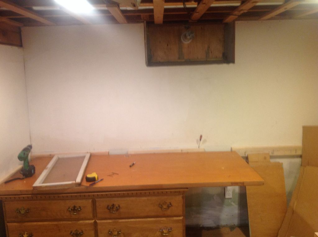

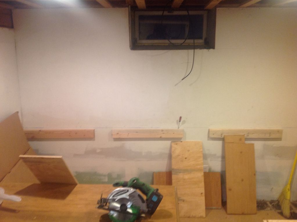

Make shift bench and window replaced.

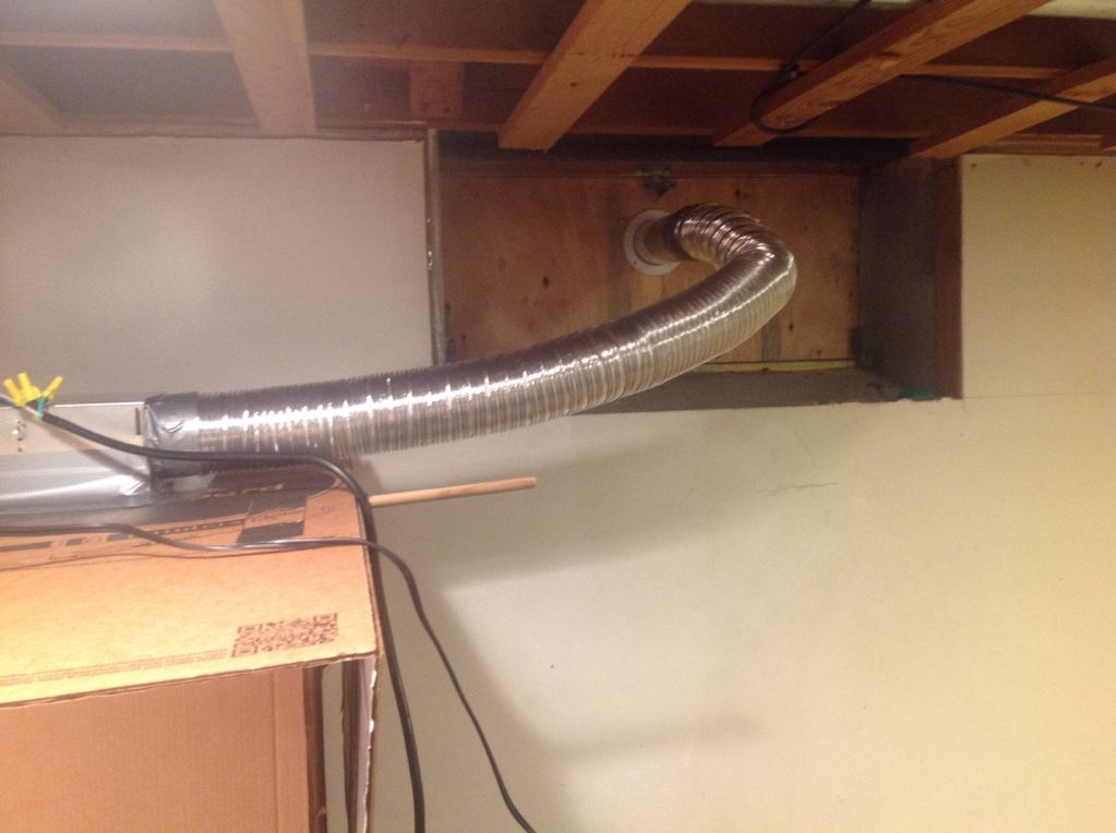

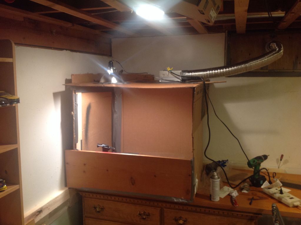

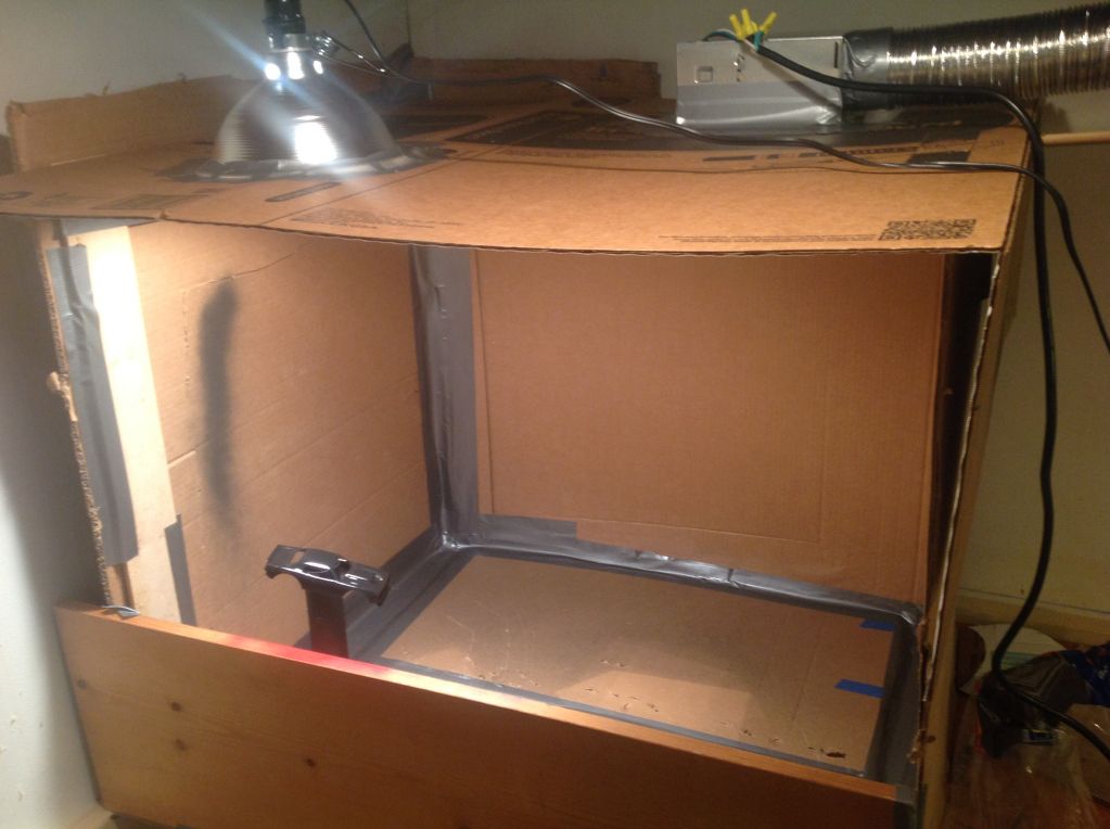

You are correct! I've been painting without one and it stinks up the house. Living in wonderful mn the weather stops you from painting outside for almost 9 months. I had to build one with all these fun runs coming up needing bodies painted :)
Now let me warn you this thing is UGLY!!! But it works and I was going for paint booth on a budget.
Bath fan $13 buck
Cord for bath fan $6
Light and bulbs $10
Roll of duct tape $5
Exhaust pipe $3
Cardboard boxes $0 ya baby
Total $37to build a paint booth. Pretty good in my book
Now here the beast is lol
I took the hinges off the window and installed them on a piece of plywood cut to size
Putting primer on my sportsman cuda body..... Just had to test it out :)

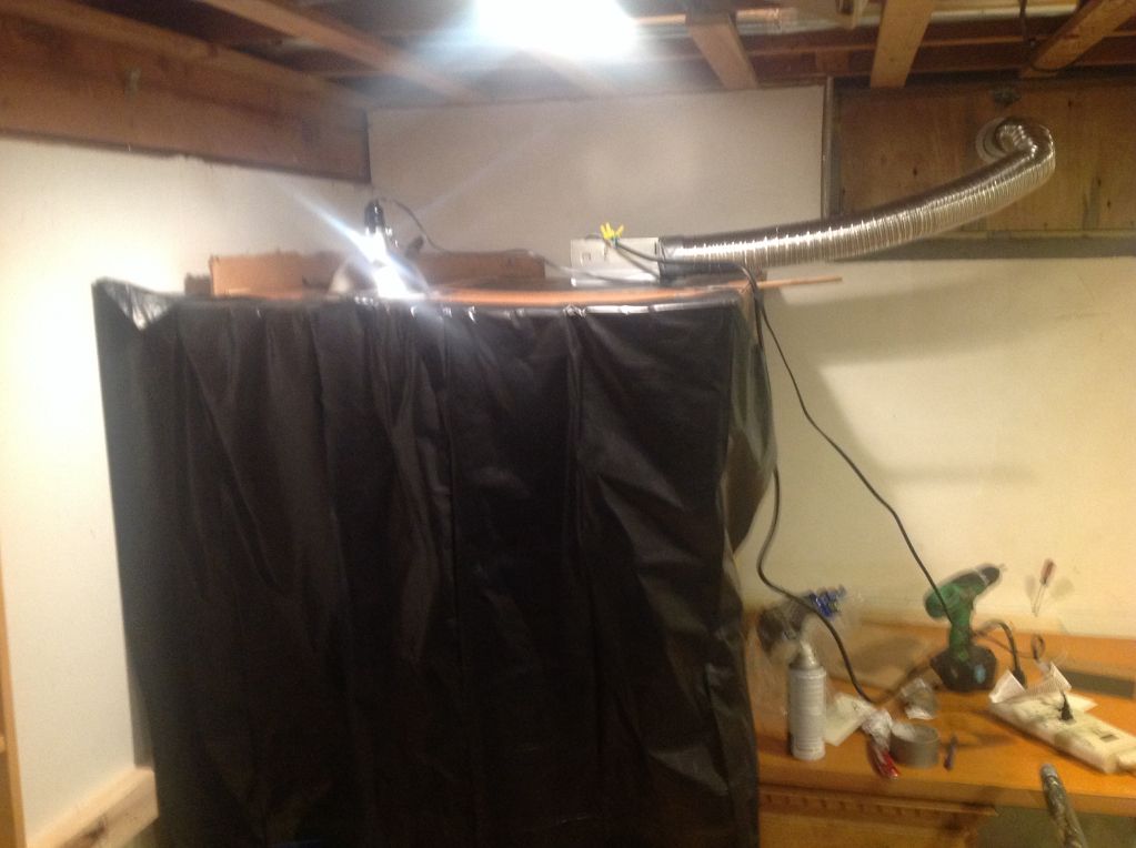

Added curtains to keep the heat in
