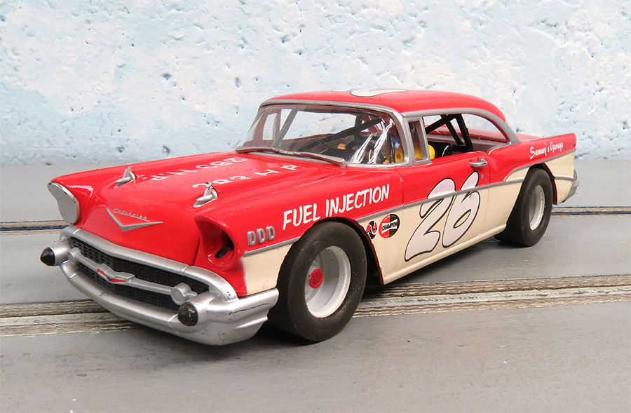

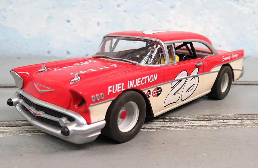

Not the greatest shots, but here is a quickie example.
This photo was taken with Ap setting of F8.0
This one taken with F2.7
As you can see, the bottom pic begins to get blurry as it moves away from the center focal point, whereas the top pic has better depth of field.
Like I said, not the greatest shots but hopefully it helps understand it. Dave K and JESIV have helped me a lot.
