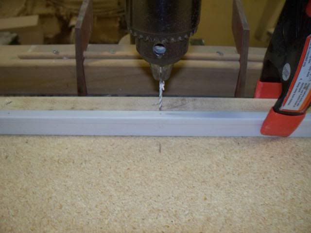

This is my first using a flexible routing guide...So I got a 12' stick of plastic trim and made a quick drill jig for it..Image
I drilled 5'' spaces using a nail as a stop that registers off each hole...

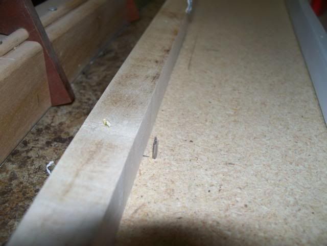

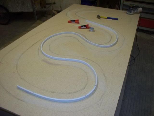

I tacked the strip down the center of the lanes for the happy medium in tight corners....
I had some scrap 1/8'' baltic birch plywood that I ripped down to 1 1/4'' strips... I then ran them through my drum sander to take the thickness down a smidgen so they would slip into the routed slots as a router guide for the other 2 lane slots....

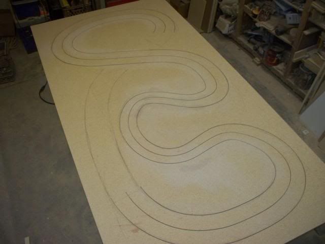

I started this yesterday...moving along....
