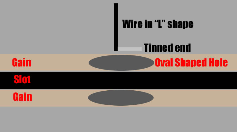

This is very rough drawing of what we talked about.
Then run the wires to terminal block and install your pigtails again.
Anyway, if you can go braid you know my answer :)
