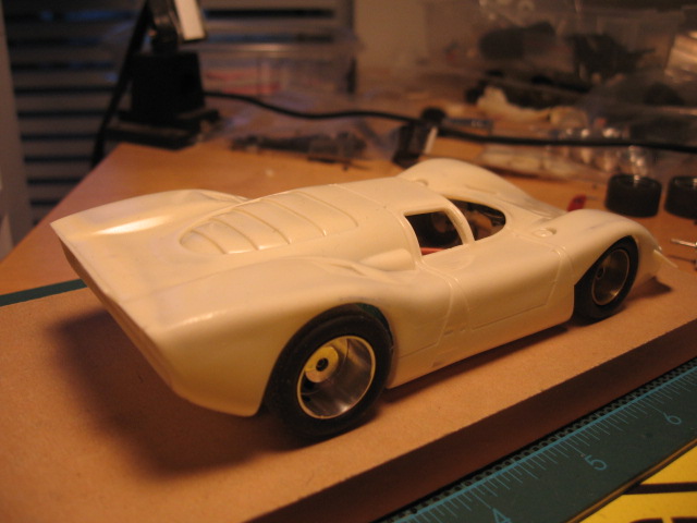

Friend has this simple and slinky-looking Ferrari 312 P Coupe body of unknown origin. I rather like the look and he was receptive to lending for molding and casting.
First cast came out well.
Chassis-wise, still undecided on going to my inline adjust-o-wheel base hybrid chassis or a sidewinder hybrid one with a Slot It motor pod.
Dan

Postby VTECFOUR » Tue Jan 15, 2019 6:34 pm
Parts assembled for a sidewinder hybrid chassis.
Going with a 3DRon (our club's 3D designer and print whiz) slimline FF050 sidewinder motor pod.
Fortunate to have a local club guy with the knowledge, expertise and hardware to create high quality 3D printed slot car items. You should see his car bodies.
Dan
VTECFOUR

Postby VTECFOUR » Thu Jan 17, 2019 6:06 pm
Chassis's assembled and rolling on 15 x 8 Slot It wheels up front and 17 x 8 CB Design rears with PG tires all around.
Mocked the body on.
Won't be this low but close.
Dan

Postby VTECFOUR » Sat Jan 19, 2019 7:17 pm
Drivetrain's installed and running. Power's a Scalextric Sport 25k FF050 green motor. Gear ratio's of 3.6:1 with Slot It gears, a 36t 19mm spur and 10t 6.5mm pinion.
Body's mounted single post, front and rear.
Weight's at 90 grams within my preferred range of 80 - 90. Though paint, an interior tray and wheel inserts will bump that up.
Runs well so all is good.
Dan
VTECFOUR
