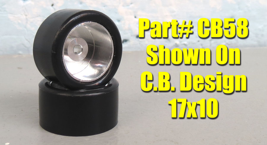

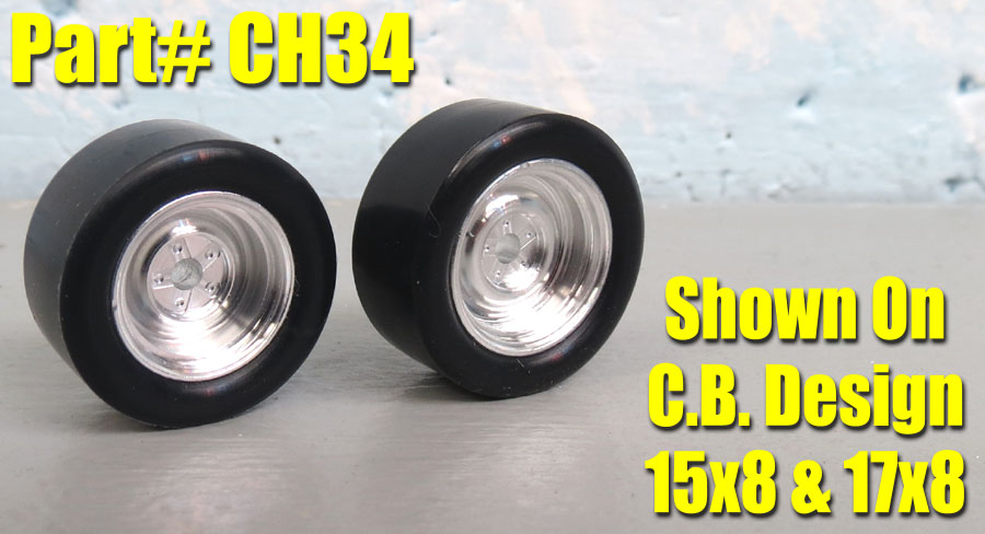

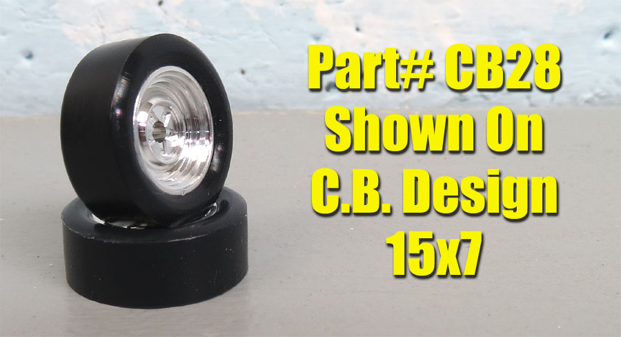

Here are the following sizes I tested. Each one fits the wheel very well. I was VERY pleased how the tires stretched slightly to fit a 17 sized wheel.
Your basic classic tire. Although not designed for it, it fits a NINCO classic wheel nicely with only a hint of crowning. Sanding the inner rib down a few thousandths had it sitting flush.
These are the hot ticket for the racers. As you noticed in my testing grid, they also fit the Slot.it wheels perfectly.
This tire also fit the 17x8 nicely on the Racer 512. Just a slight overhang but it fit the wheel and the car with no rubbing.
Since they are designed to stretch a little to fit both wheels, the fitments on the smaller 15 sized wheel is not as tight as you might be used to. They still fit, and worked fine for me during testing. I do have to suggest gluing them for competition. Of course I am preaching to the choir on this, but need to mention it. If you are going to glue them, use the CORRECT ADHESIVE. For these tires it is the same for other silicones: IC-2000.
