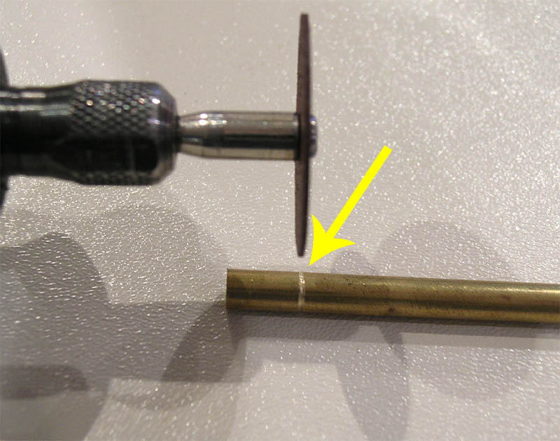

Round Stock/Tubing
1/ Measure/mark your required length with a Sharpie
Remember that the cutting disc may be wider than your sharpie line, so, if you cut in the center of your sharpie line, the piece may be a fraction too short. It is better to err on the long side. You can use the flat side of the cutting disc/files to trim to the perfect length. You may choose to wrap a piece of masking tape around the tubing, and then mark with the sharpie.
2/ With the dremel on high speed (don’t forget to tighten the Dremel chuck), hold the Dremel in one hand, and the tubing in the other.
With the Dremel steady, touch the tubing to the disc, and rotate the tubing in your fingers, making a score line all the way round. Continue rotating/scoring the tubing until the complete cut is made. You can just slice straight through the tubing, but, on larger diameter tubing there is the distinct possibility that unless you attack the tubing at a perfect 90 degrees, the disc will bind, and break.
3/ Clean and finish the end with a file/sandpaper
You can take an old Xacto blade and insert the tip into the end of the tubing and twist to remove any internal burrs. This looks a little more finished and if you are inserting an axle into this tube, this process will ensure the axle will turn freely.
*There is really no need to hold tubing with pliers when cutting. The walls are generally thin enough that they cut before heating up too much and excess plier pressure can easily crush the tubing. Besides, without a few blisters, you really can’t call yourself a scratchbuilder-:)

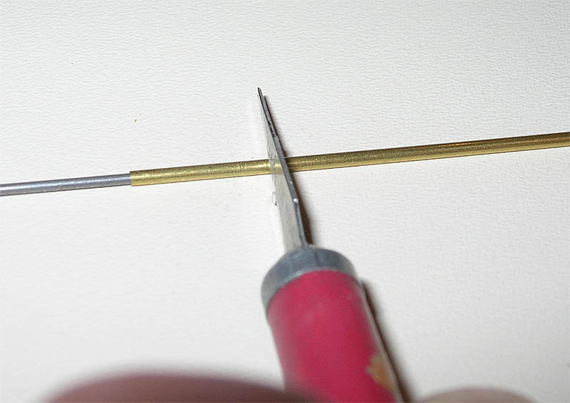

Cutting thin brass/aluminum tubing with an Xacto knife
This procedure works great with small dia (up to 3/32) brass and aluminum (up to 1/4) tubing.
Find an axle/piece of piano wire/brass that slides snuggly into the tubing you are planning to cut. Find a hard flat surface (counter top), and while pressing the Xacto, (use an old blade) roll the tubing back and forth a half a dozen rolls and presto!
While this does not improve the life of your blades, it is a very easy way to cut small dia. tubing. And an old blade should be good for many many cuts, preferably only the tubing!

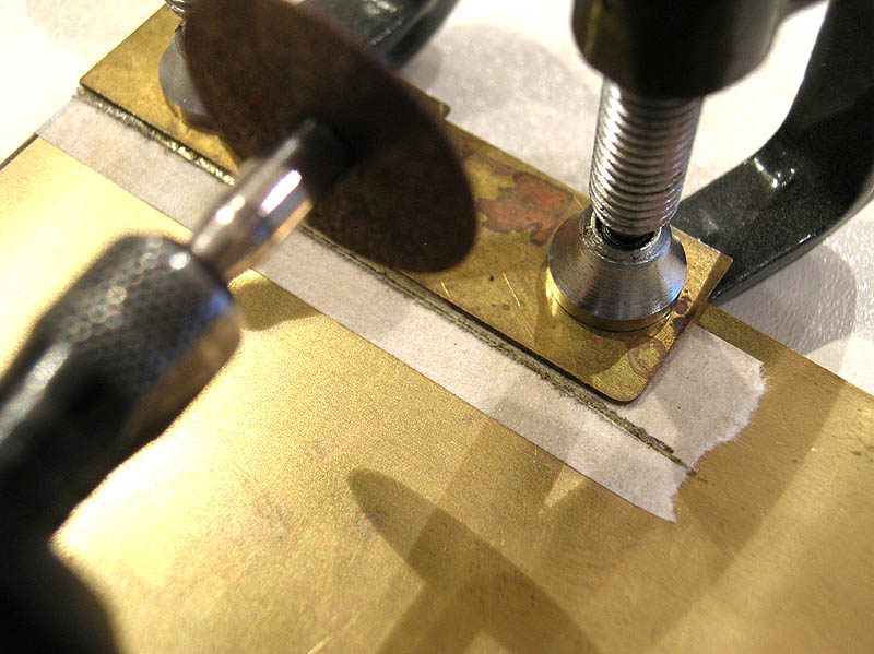

Flat Stock
As most of the flat stock you will be using is relatively thin and therefore flexible, it has a tendency...no, I should say it definitely will flex when you cut it. This flexing will grab the disc and? Right. Another broken disc. The longer the piece you are attempting to cut, the better chance you have of this happening.
So a slightly different approach is advisable
1/ Cover the piece you are cutting with a layer or two of masking tape. You will be using pliers and/or clamping on another piece of brass to act as a guide/fence.
So the tape prevents: Marring from the pliers/clamps. Is easier to grip with pliers than the bare metal, and is easier to mark with the sharpie.
 2/ Mark the cut lines with a sharpie and again, remember, it is easier to remove a sliver than add one.
* If you need to make a cut that is a couple of inches long, I would strongly recommend that you use the C clamps to attach a spare piece of metal along the cut line to be used as a guide/fence.
If you go this route, you can hang onto the C clamps while cutting, and don’t need the pliers.
3/ Make your first cut a shallow score, with the dremel smoothly and continually moving down the fence/cut line, and repeat with additional shallow cuts until done. With practice you will quickly get the hang of it, and will be able to increase the pressure/depth/ speed of the cut.
4/ File and sand the edges…
