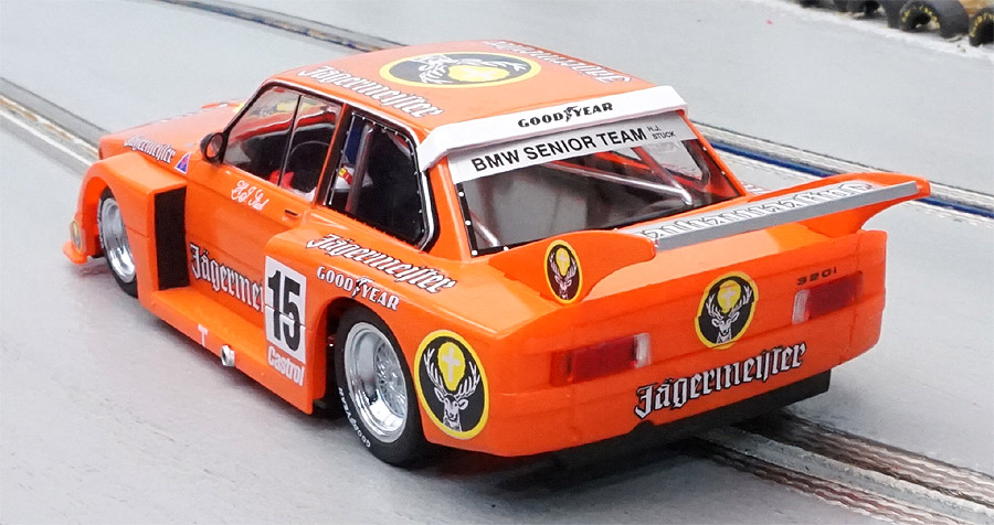

In any event, this new BMW arrived safe and sound from Cloverleaf Racing as usual. Judging by the prototype photos that are plentiful around the web, it appears Racer has done a good job overall. Of course we all have our own tastes in scale accuracy and only you can determine if Racer has produced a model well enough for you.
Driver and interior detail are an ideal balance for me. How about you?

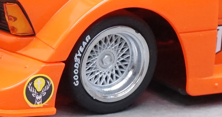

I feel this Group 5 Sideways series achieves a good balance of the Scale/Performance ratio. Others of course disagree. The wheels are the focus for many enthusiasts, especially myself. I am not a diehard "one size fits all" fan, but I understand the approach.
They utilize wheel sizes that have already been established in our hobby and for many that makes perfect sense. The molds made to cast the wide variety of aftermarket tires is one of the leading advantages. And then there are spare parts which again, are already well established in our hobby. In some cases this means the appearance of the models are not quite what some of us hoped. Although I want accuracy as much as the next enthusiasts, I also want quality and easily attained parts for tuning.

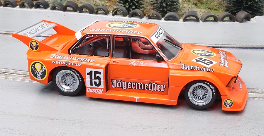

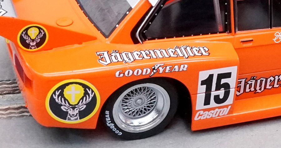

In the case of this BMW, I think they work very well. It's a compromise that for my home racing is easily accepted. Is it for you? I did notice some flash molding areas that appeared to be trimmed away rather hastily. The above photo should show you all you need to know.

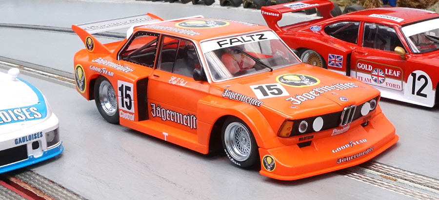

On the outside, this brand has been reasonably consistent in pleasing the scale enthusiasts in the past. Excellent overall finish with clean and crisp marking are usual traits.
However this release is not at that level. The markings and colors appear to be fine, but the lack of a clear coat to seal and protect them is non-existent.
This is disappointing for me. I expect a little more quality control from this brand. Yet, mistakes happen.
On the other hand I can and will address it myself. A couple coats of acrylic Pledge FloorCare and a good buffing with wax will take of this easily enough. Yet I should not have to and hopefully future releases show improvement.

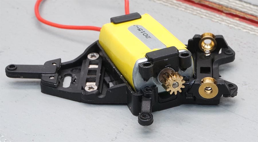

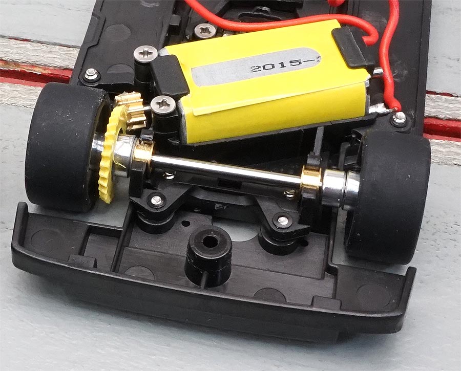

The real news on this release is the introduction of the new and improved pod system. This new pod has addressed the weak area in the rear of model that has caused some issues with racers. One item it addresses is the now familiar "AngleWinder Hop" or chatter. Many of us have resorted to using tape and even custom supports to help strengthen the rear as well as dampen the movement of the pod.
Standard Flat 6R and 11/28 gearing.

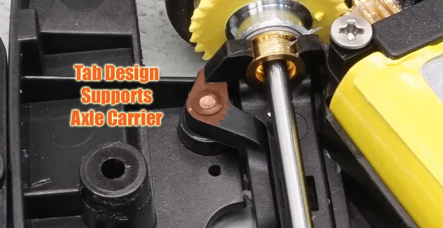

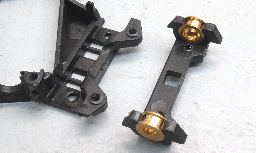

The new axle carriers have a notch type design that is also supported by the pod. This strengthening measure is something I have seen many racers comment on and is very welcomed.

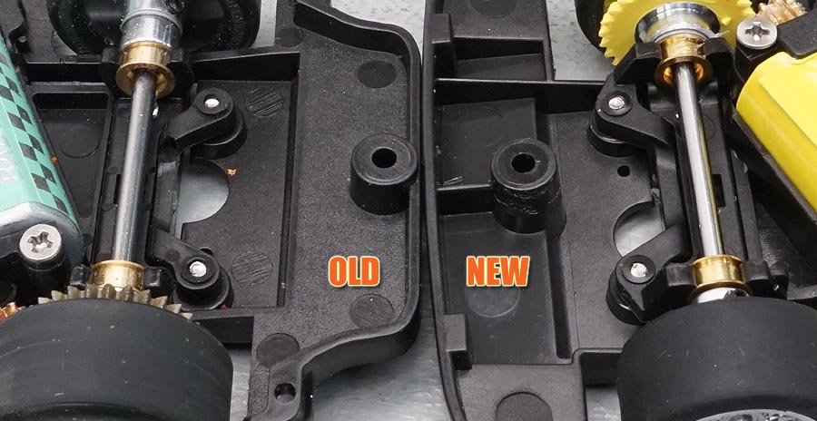

This view above shows how the new carriers fit into the pod cradle.
On the left is the latest Porsche with the old style system. On the right is our new model.

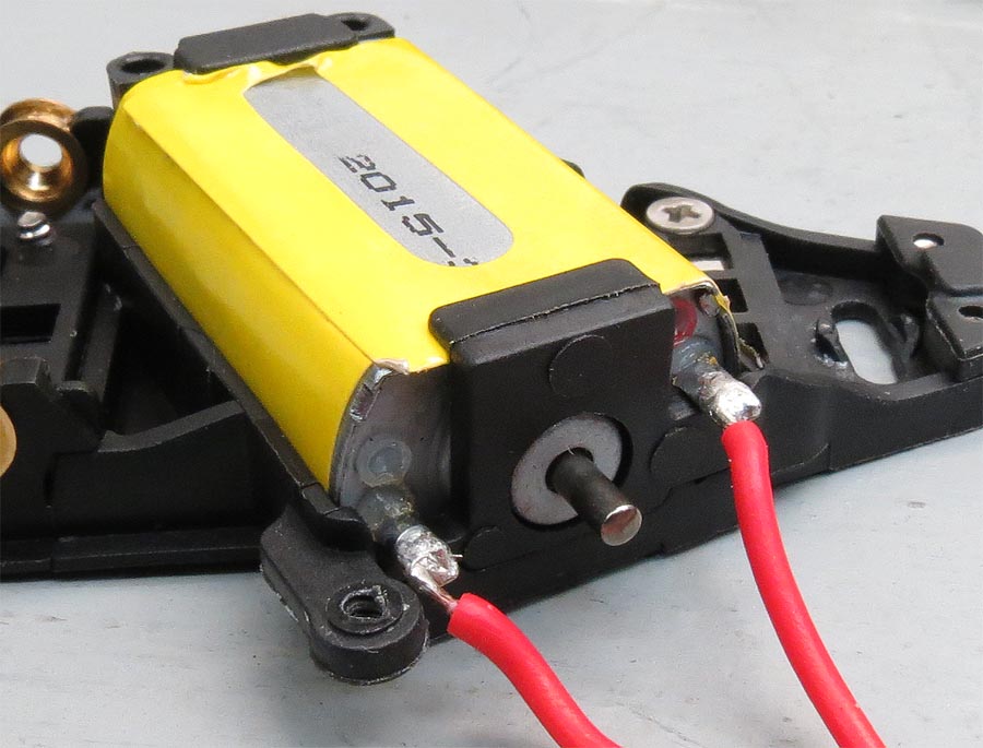

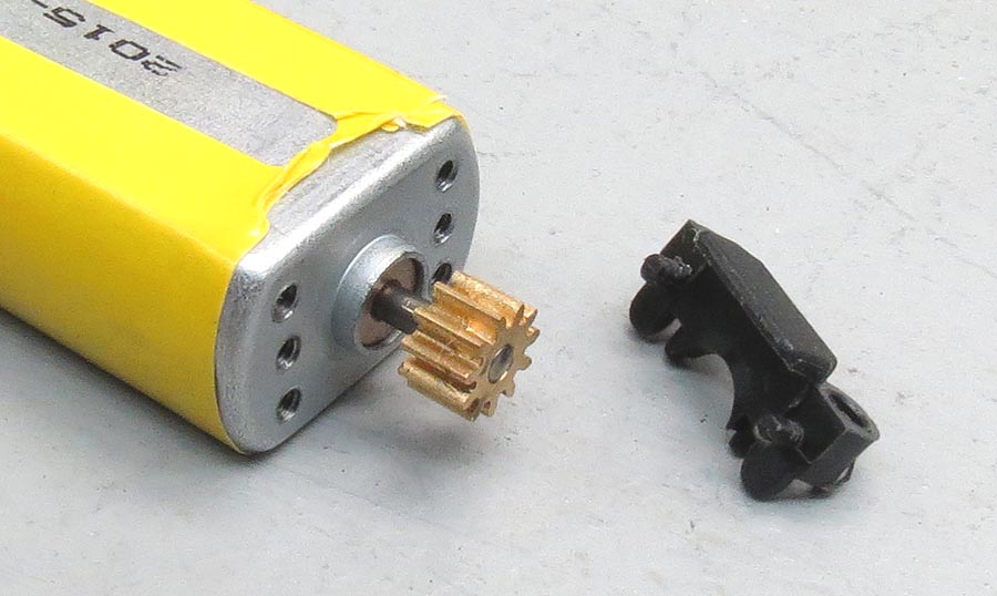

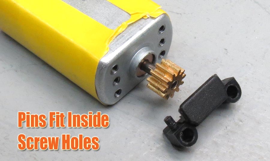

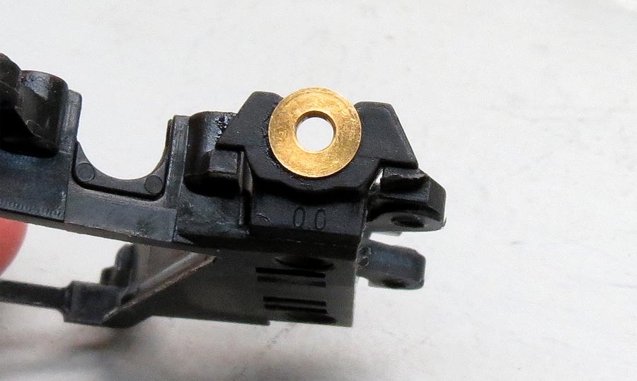

Another area it focuses on is the motor mount itself. The new mounts help address the movement of the motor.
Each end now has tabs across the top as well as a dual pin design in the front mount.

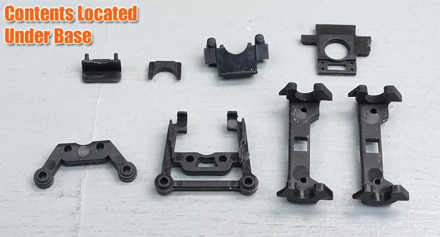

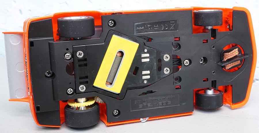

Underneath the base you will find the bag that contains the additional parts. There new designs for the axle supports that allow you to change the offset of the car as before, optional front fork to replace the single post design that model comes with, new motor tabs, and even a new front fork assembly that allows this pod to be used in other chassis such as Slot.it.

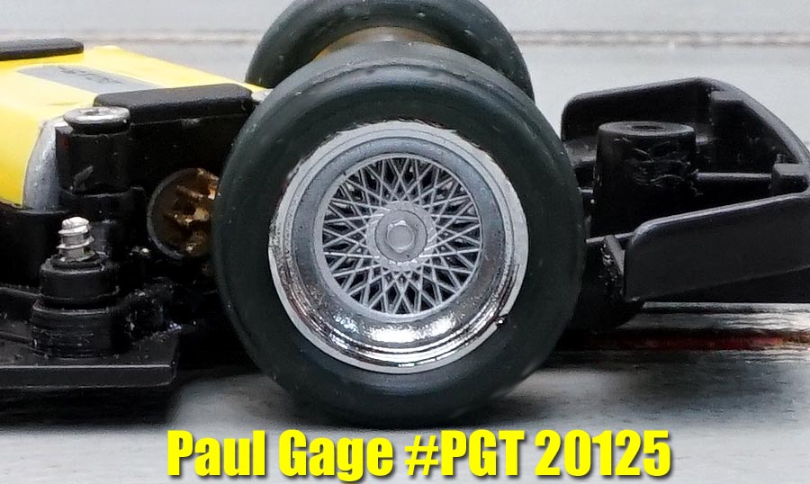

Of course aftermarket tires will find their way on these cars. The top 2 brands in the hobby are Quick Slicks and Paul Gage. Each tire size I chose fit very well and provided much improved performance over the stock tires as expected.
