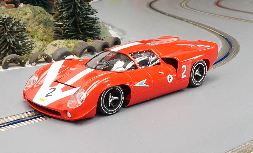

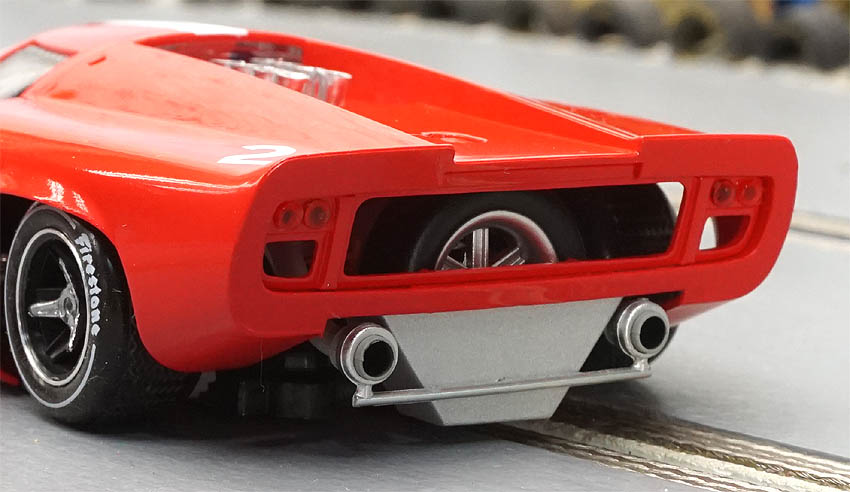

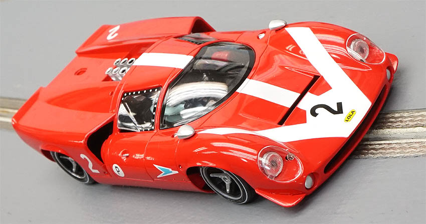

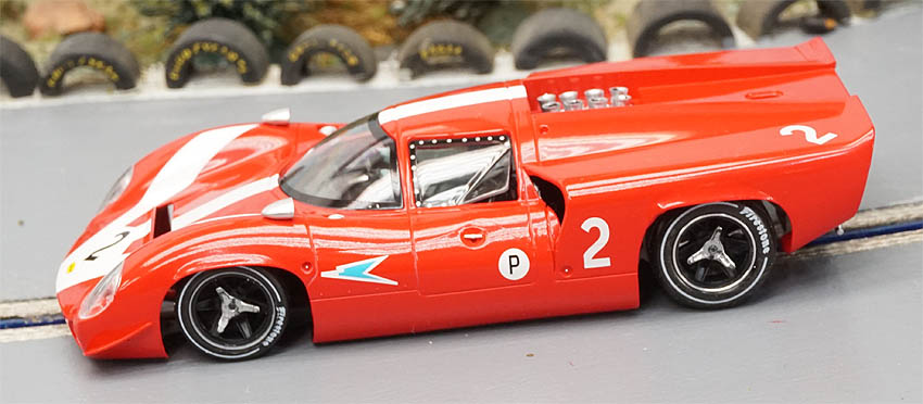

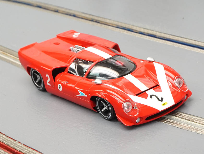

On the outside, the model certainly won't impress the scale enthusiast. It's not perfect and again I didn't expect it to be. We appear to have a slot car that is trying to achieve that balance of scale detail and performance. From my seat in the stands it accomplishes that. Veterans of Fly Classics know this view. Most of them were not perfect in the scale accuracy department either but it didn't stop us from enjoying them then and honestly won't stop me today on this model.
This slot car though isn't trying to hide anything. The very low body stance and undersized wheel/tire appearance are what most scale enthusiasts will notice first. Personally I do not care for this look that much, but some of you do. You might want your car as low as it can go regardless of appearance. If that is so, this model should please you.
So there are some liberties here such as the greenhouse is a little off and some "generosity" near the rear fenders. But I am not going to count rivets here. I'll leave that to the aficionados of the car to debate.
The quality of the paint and markings appear just fine to me. In fact I am impressed by it. There are some companies that are actually going backward in the fit and finish departments and I am pleased to see Thunder Slot is not one of them. Regardless of scale issues, what is here is covered well.

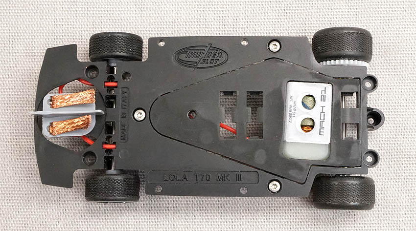

The first views of the chassis likely tell you a lot about what you are getting.
Photos show car without bracket installed. See below as it has been installed for testing.

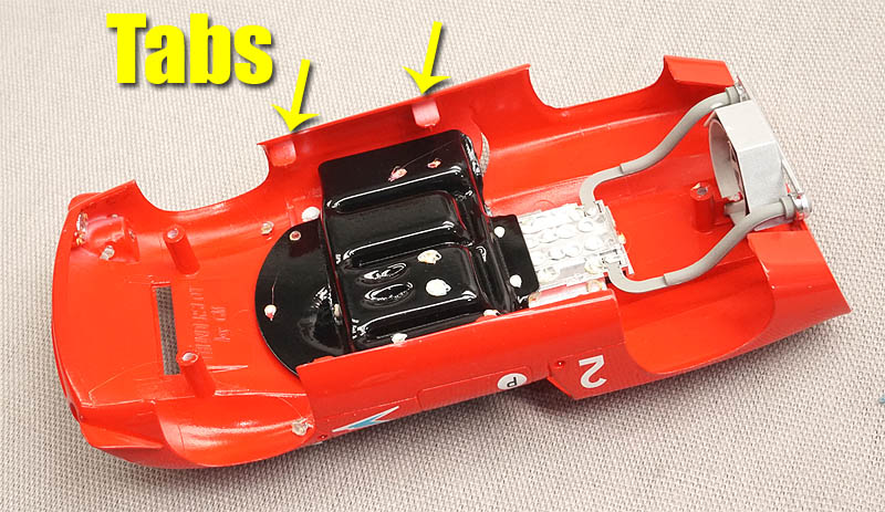

The chassis has 2 set screw access holes on each side. It allows you to add these screws to adjust the body height.
They make contact with the tabs inside the body.
The problem is they are not included. This is a unnecessary inconvenience in my eyes and they should have been included.
There are magnet pockets in the event you want to add one. Remember this is a non-magnet car out of the box. The absence of a magnet might also be a mistake to some racers. Not everyone races non-magnet style. However, the intended audience for this model is for non-magnet use so in fairness I cannot view this that harshly.
The standard chassis and pod is very flexible. I can easily see some wood track racers opting for the harder compound chassis options, but out of the box it ran well enough for me.
The rear pod assembly is a triangle design with 5 mounting points. This chassis is designed to accept a suspension kit as mentioned earlier but simply loosening the screws gives adequate float.
As mentioned at the start of this review, the rear support bracket is missing. I was fortunate to have mine included in time for this review.
The configuration is sidewinder. Sort of. It is at a slight 2.5 degree angle. The motor is held snugly in place with 2 screws. The motor itself is standard "S-Can" can type and rated at 21500 RPM.
I bench tested this motor on our laser checker and pleased to report the ratings are very close. You have to give a few hundred RPM here and there with these motors but mine was reading 21,560 consistent. And as I already stated, I like the performance and will keep it in place.
As with some cars of this configuration, the pinion is very close to the tire. You might need to push it on a little further to avoid rubbing. My car was not effected.
Make sure to check the other side as it is very close to rubbing the chassis.
This side can be adjusted using shims. There are shims present in stock form.
The gearing was sort of a surprise as it is equipped with a plastic pinion as well as spur gear. Perhaps this was to keep the initial entry price a little lower, but I can't confirm that. Regardless of the material, the mesh is smooth and responsive. And given that I have models 10-15 years old with plastic gears that are still going strong, I'm not really complaining.

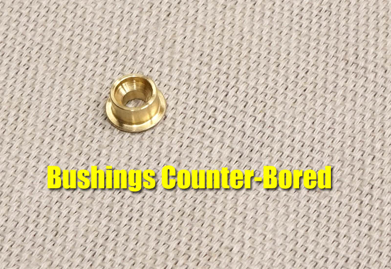

The rear single flanged bushings are a very nice fit to the axle and press in place. I imagine gluing these in place will be an option many will accomplish. The important part is that precise fit to the axle.
They are also counter-bored. This reduces friction at the axle and bore acts like a "well" of sorts for holding lubricant.

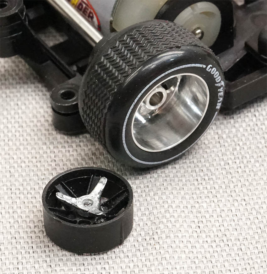

The rear wheels are aluminum and have the "air gap" design to them such as NSR as there are only 2 narrow ribs supporting the inside of the tire. These ribs are smaller in diameter as well and not like the NSR. I personally didn't think we needed another new wheel as any standard sized version would have worked fine.

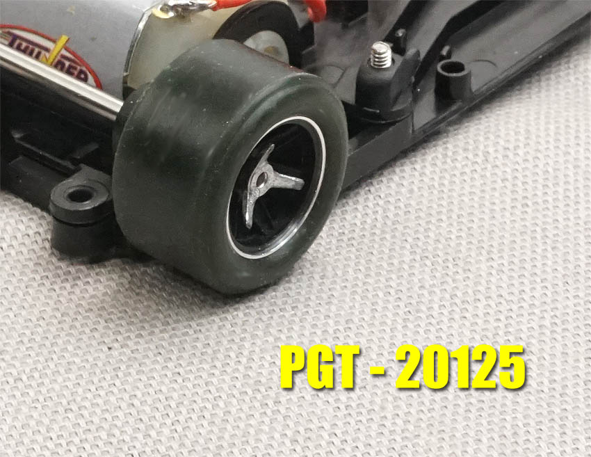

And with this new wheel comes a challenge: Aftermarket tires are harder to find. Most silicones I tested simply cup and have a low center due to being unsupported. For most advanced enthusiasts on this side of the pond, that is not a good thing. A alternate approach is to simply change the wheels out to standard ones. Of course we are adding more cost, but at least getting different tire blends and sizes would be easier. Until someone makes a tire for the originals that is.
I did manage to fit a Paul Gage #PGT 20125 tire with very minimal distortion. A light sanding has it nice and true. You will have to glue the tire for best results, but you will want to that with the stock rubber as well.
All of this might mean nothing to you if you prefer the tires that the car comes with. Since they feel much like NSR tires, I imagine many of you will keep them.
I do like them as they grip our track surface very well. In fact I may not bother to replace them and just keep these models in stock form. The fitment could be a little better and there are some obvious flash mold areas that will need attention.
Sanding the tires to get a smoother contact patch was the answer for our track surface.

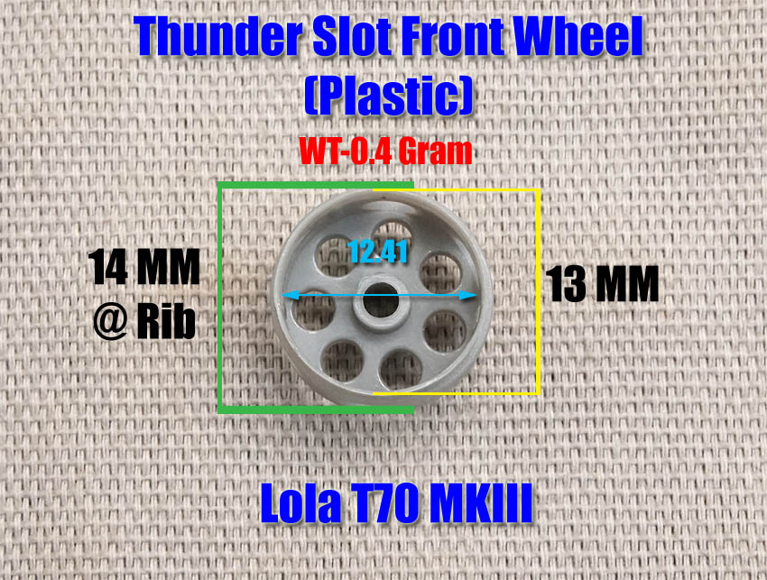

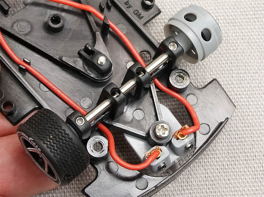

The front wheels are plastic and press on easily. You might want to glue them before racing. The size is common but the inner rib is very shallow. You should be able to use the front tires as is by sanding and coating them for zero grip effect. Personally I won't go any lower diameter.
And seeing the plastic wheels doesn't concern me. Round is round. These are about as good as it gets in plastic.

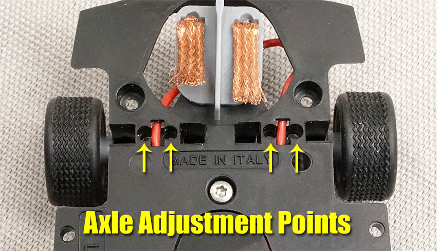

I was pleased to see the front axle adjustment has the screws you need. I was concerned these would not be present like the body screws, so I am pleased to see them.
It is also interesting to see that you can convert this model to independent fronts thanks to the added set screw supports up top and access points in the bottom.
The front guide is an interesting design. From the blade shape to the wire connections. I would have preferred a little thicker blade for wood track use, but the guide works well enough. As with most things, it can be easily changed to suit your track/preference. The set screws provide a very good connection. Turning the guide all the way to the left or right gives you access.
