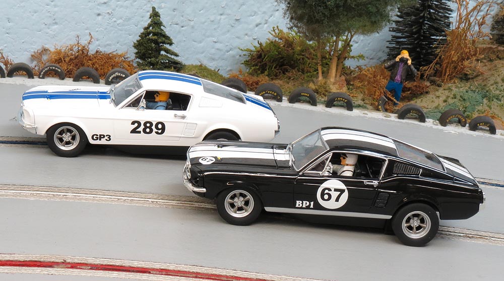

Both of these cars are adorned in a fictional type race livery which I do like. All you need are some basic designs and a few numbers and a plain old street car is transformed into a weekend racer. I am not a hardcore street car fan when it comes to slot cars. I like them and have a few that we enjoy taking out and running from time to time, but my taste leans more towards race themed models.
With that said I am not that pleased to see this hot rod type chassis used. It does look good; it is just not my personal style. I was one of those enthusiasts hoping for a model that I could easily tune and make it into a SCCA type race car for our home series. With the amount of rake and large tires in the rear, this will not be easily accomplished.
Well, for me, it's a Mustang and if you know me, you know I like Mustangs. While I'm not a huge fan of the combination of SCCA livery and the 'ready for the drag strip rear end', it's another model made for my stable. I will say though, I'm surprised that we don't see ladder bars printed on the sides of the chassis.

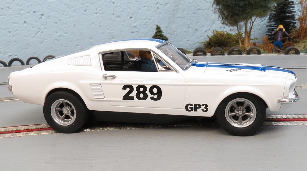

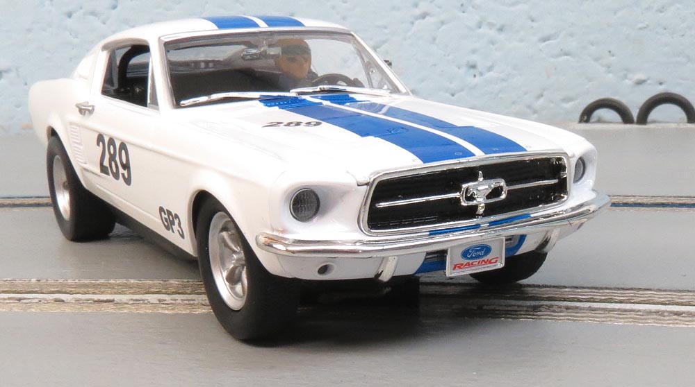

Although the hot rod chassis is not my favorite style, this paint scheme is a plus. The overall finish is very well done on my model. Crisp markings and a clear coat make it very eye appealing.
And with this digital version (the lights are a plus, both head and tail), the finish is that which we've grown accustomed to from Carrera, nicely done. While black models are generally hard to see when running on black plastic track, the white stripes and bright white gumball give you all the help you'll need to see it speed around the track.

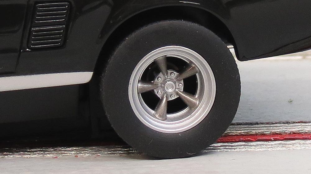

Wheels are new to this model and they are nice looking for what they are. Tire compound is softer than I expected too. I am not sure if Carrera has changed anything in the tire manufacturing department, but it appears these tires have a little more grip. Both of my models seem to be round and true for the most part. There are always some slight improvements to make with plastic wheels, but these are pretty good and should not need a lot of work.
Can you say Torque Thrust? I was glad to see these wheels for obvious reasons; I mean a racing Mustang just has to have them. While the argent paint isn’t carried over to the center hub, a quick glance says, Torque Thrust. That's good enough for me! Like Harry said, the tires appeared to have a bit more grip than previous tires, though I found that on plastic track there was less than on my wood track which has a latex finish. Still, nice round tires with some extra width in the rear and only a slight bit of flashing on one wheel, not enough to cause any bounce though.

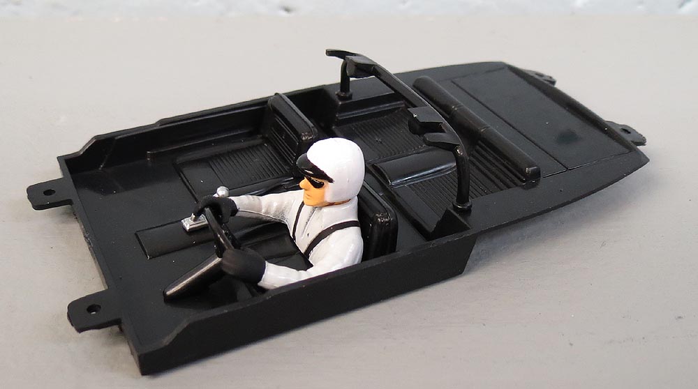

The interior is the other new part of this release. We now have a race-type theme with driver and a little roll bar detail. This is appealing to me as well.
I've not been a fan of half
drivers and such, but over time they've grown on me. Let's face it, when you
look through the window, you couldn't see the drivers feet anyway because of
the dash and steering wheel. And speaking of the dash, there is one in this
model and it is just like the 1:1 dash. The Grant steering wheel is also a nice
touch on this racing model.

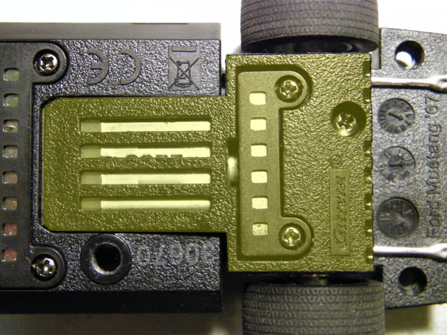

So let's remove the body, one screw at the front and two at the rear (removal of the two magnet screws for the front and rear magnet are not required). You'll notice a fifth screw close to the driver side rear tire, just leave that be for now. Note that when removing the body from the chassis, I had a little bit of trouble. The LED's gave a bit of a hassle but they finally let go, literally. The front LED assembly popped out of its carrier but no big deal, I just popped it back in. Reassembly was a bit of a struggle, again, due to the tight fit. I tried installing the front first then the rear, and vice versa, and ultimately, the rear had to go in first and I had to flex the chassis to get the front in, and I had to apply a bit more pressure than I was comfortable with, especially with delicate LED assemblies involved. I’ll be modifying the body/chassis to alleviate this problem. Watch for a post on how I do that soon.

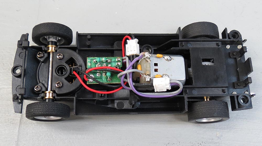

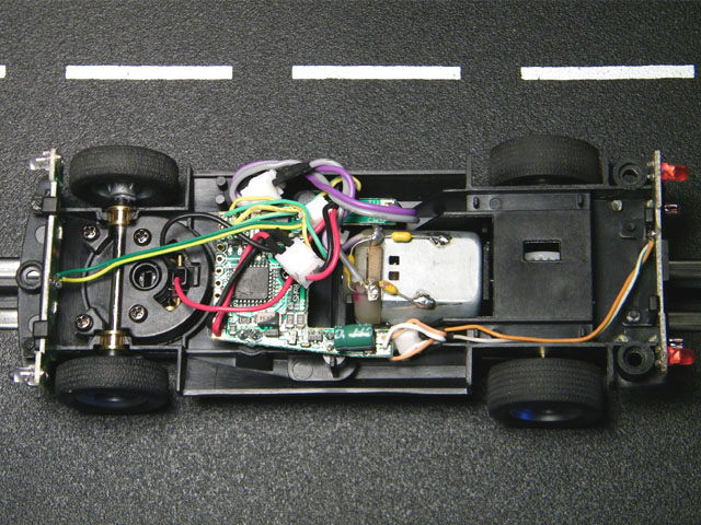

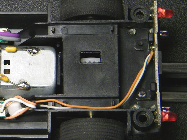

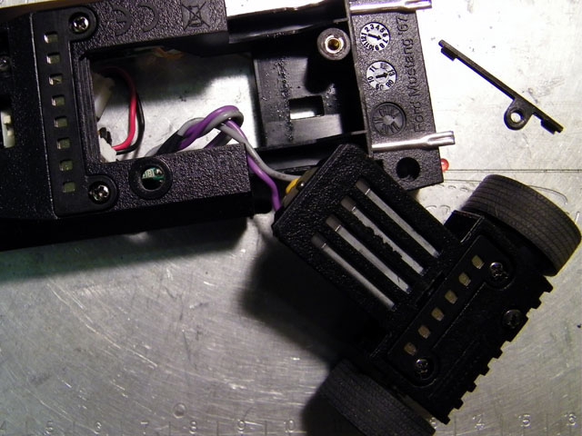

Here you can see the internal workings of this model. Now where did they put that crown and pinion gear? It looks like it's covered by a top plate but it isn't. We'll get to that in a bit. The wiring, while tightly compacted, is routed well and doesn't interfere with the interior or running gear. The guide is the same as we've seen from Carrera over the past couple years.

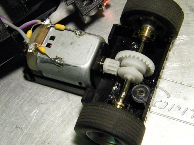

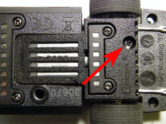

This chassis posed something we’ve seen in the past with Carrera cars, a ‘pod’ assembly of sorts (highlighted in yellow below). I wanted to see the gears in this model and the only way to get to them...remember that 5th screw I mentioned? You'll need to remove that from the bottom of the chassis. Once you do, the 'pod' will come loose.
With the screw removed, you can now lift the 'pod' assembly out of the chassis. And if you didn't notice, you dropped the small spacer that you see in the upper right corner of the photo below. I'm no engineer, and I'm sure it serves a purpose, but I reinstalled the 'pod' without the spacer and couldn't tell that it made any difference. It looks as though it may be to keep the 'pod' aligned left to right, but with the screw tightened, I found no movement in any direction.
Flip the 'pod' over and now we can see the gearing used in this model; 9 tooth pinion, 27 tooth crown gear, a good combination. When reassembling the 'pod' to the chassis, notice that the front of the assembly has a notch that marries up to a tongue on the chassis. Make sure you get it inserted properly. And a tuning note here, once you have this pod put back in place, you'll want to glue it with some hot glue so that it doesn't shift during racing causing unnecessary vibration and binding.
