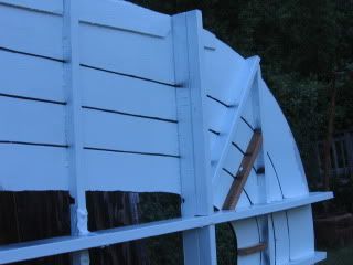

Postby Nor Cal Mike » Tue Nov 06, 2012 10:09 pm
I agree with David, heavy is not necessary. This track is one I built a few years ago. It 4X8 is made of 1/4" plywood over 1X1's on 1X3 ribs. The slots run all of the way through the sheeting. I cut them with a saber saw rather than a router. It is currently leaning against my garage wall. I can carry it and load it on the roof rack of my car by my self. It is 4 years old and still going strong.
