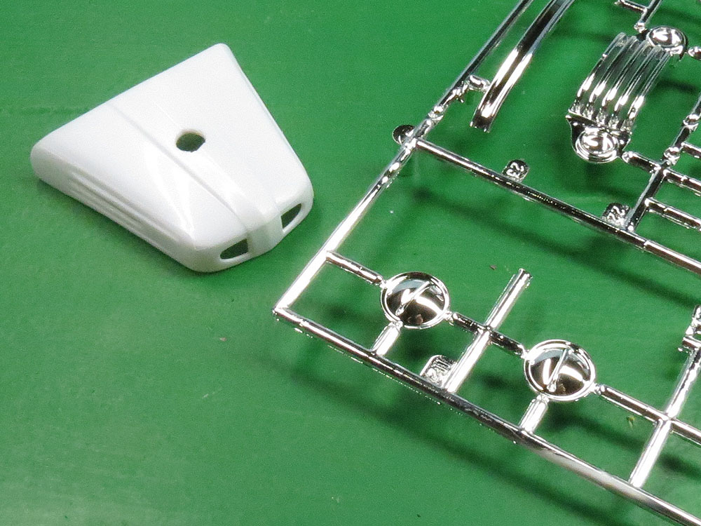

I am behind the times but at least getting things started.
The kit to start with.

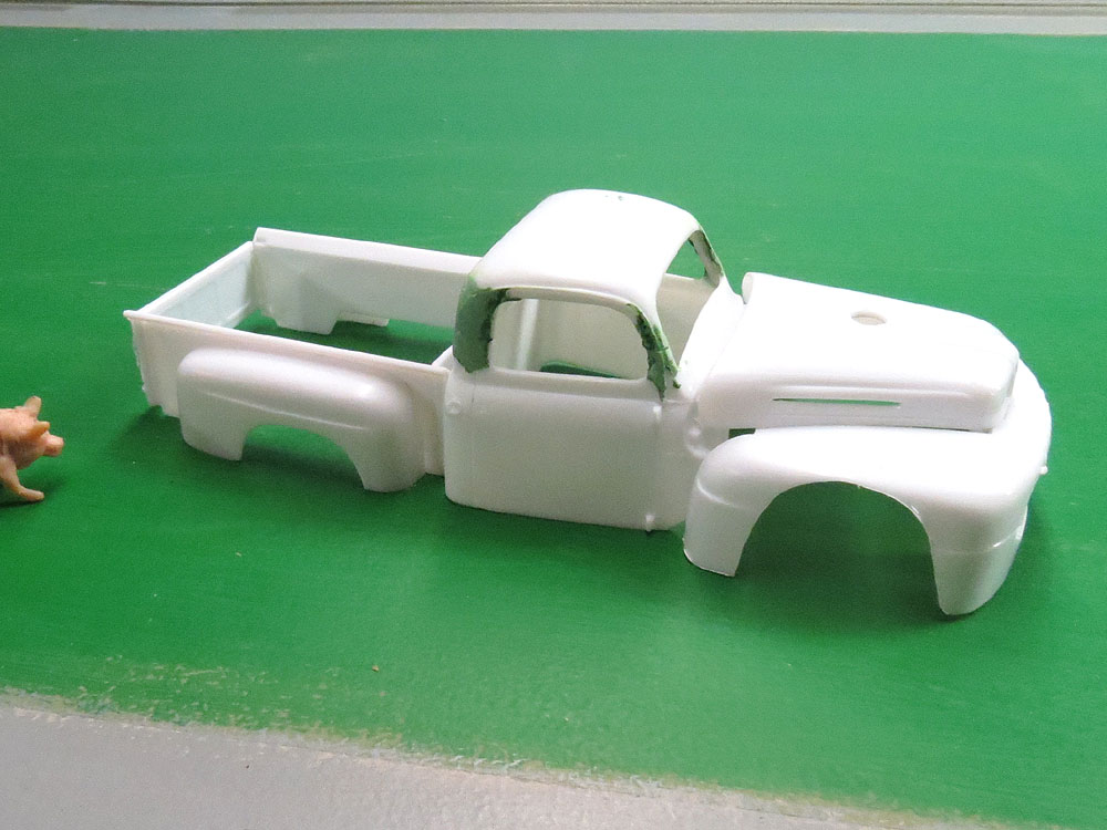

The front clip is a separate piece so I had to strengthen it with some scrap styrene.
Roof chopped and time to start bondo :)

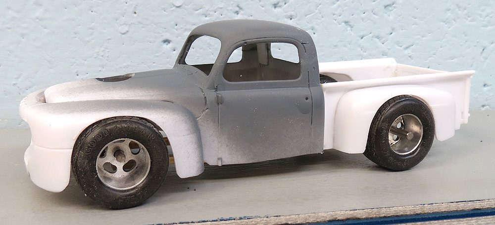

Still in mock up stages, but getting a good idea what I am after. I think :)

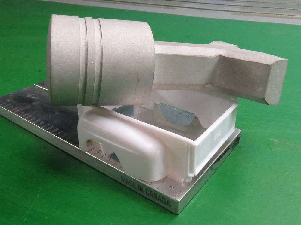

How to take a tweak out of a pick up bed. Use your Piston Cup trophy on top and use a blow dryer to cook the frame and presto!

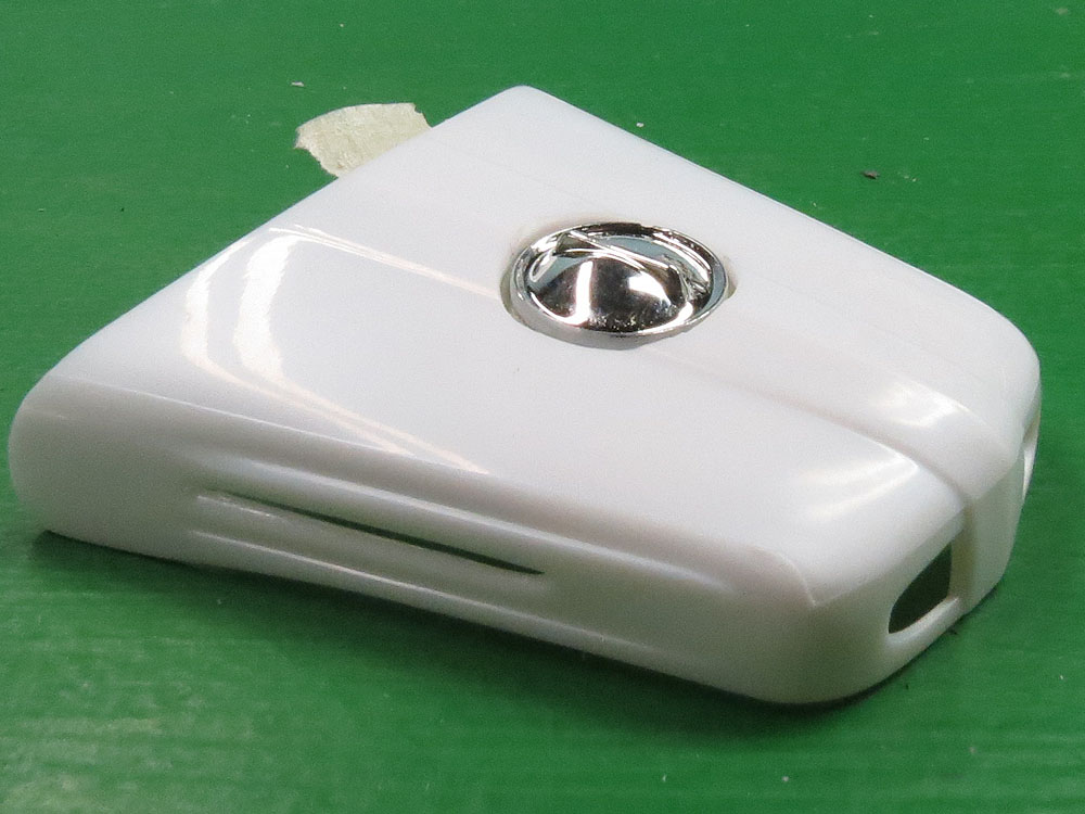

I want an air filter. Hmmmm...these hubcaps look pretty cool.
Yes, that looks pretty good to me.
Just getting to the chassis. Front end will be cut off, but the rear bulkhead is good to go.

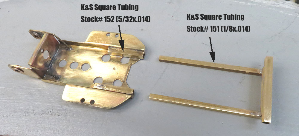

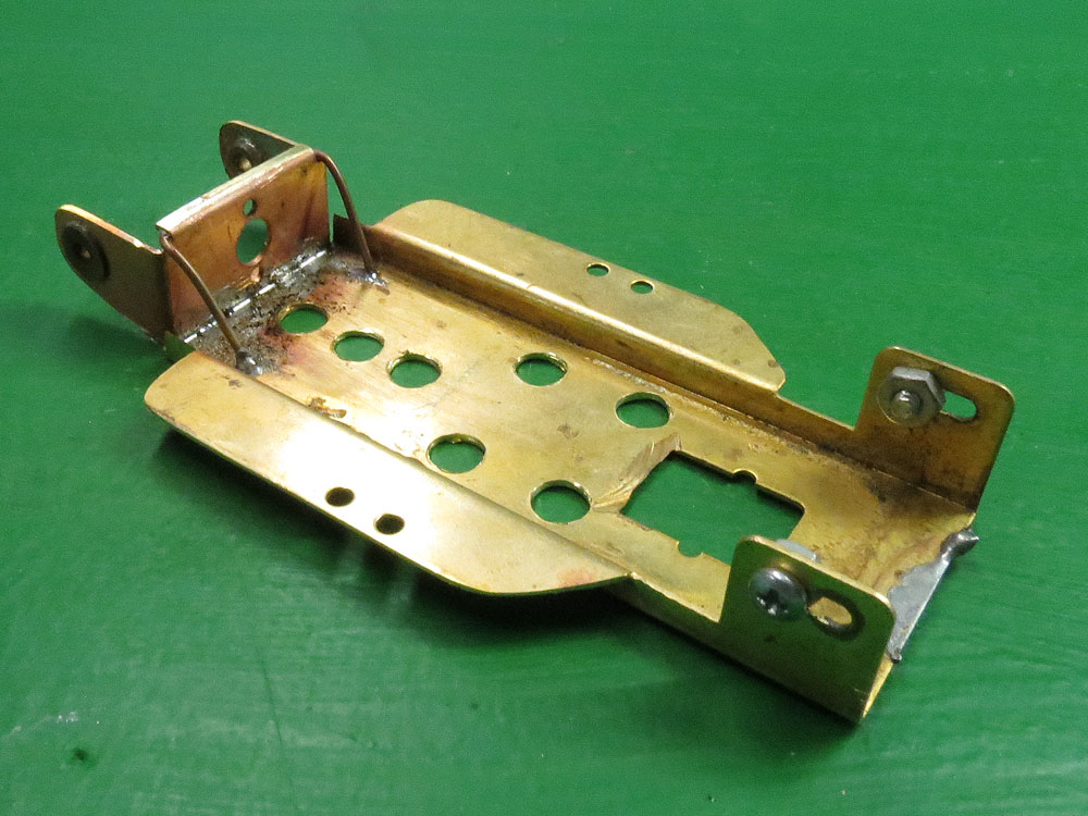

Here some progress on the Igor Chassis (ver 1.0)
Did some slicing on the pan and cut the side mounts to fit in the cab. Cut off the front bulkhead and created a slider type system from square brass tubing.
Works just fine. Just need to make the guide tongue now.

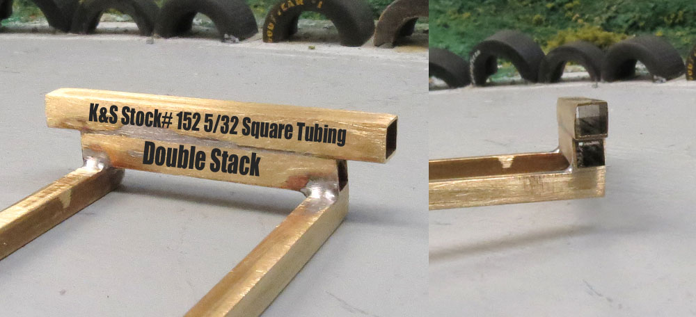

The front axle carrier is a double stack of the same size tubing. This made the chassis about as close to parallel as it gets for the Skunkworks.
Slide to adjust and it seems to fit ok.
A lot more to do, but making progress :)
