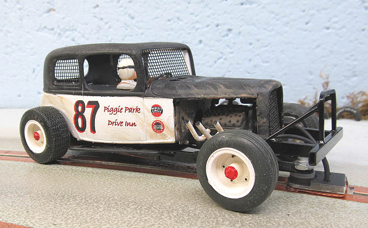

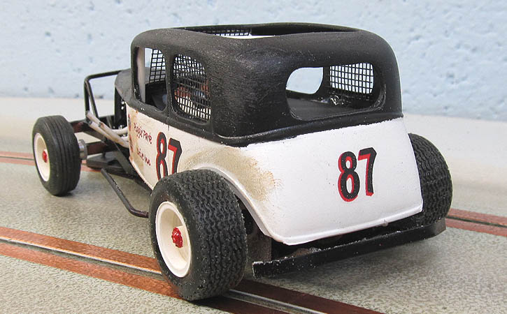

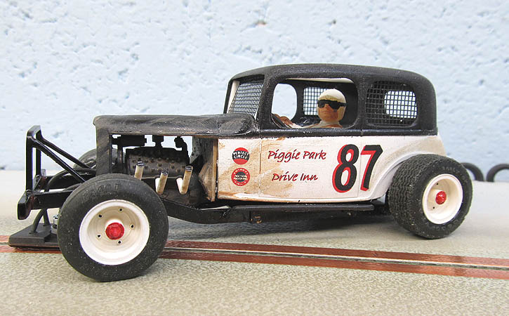

Well, been a week off from building but got it finished up this evening.

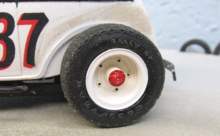

Tires are Paul Gage customs he made for me and will have for sale soon I am sure. After removing the foams, I sanded the wheels with medium grit sandpaper to remove any excess glue/foam and to give something for the adhesive to bite into. I used clear nail polish. This works great as it gives you time to move the tire around to get it straight and true.
Inserts are from Big Donkey Resins. Decals are from Heller I have had for a long time. Just mix and match, nothing fancy on these old beaters. Champion driver bust repopped in resin, card stock tray interior, and plastic screen to finish it off. And yes, I sanded the car with heavy grit on purpose and only gave it one coat of black for effect. I wanted it to look rougher than a cob :)
Hawk 18K motor and wheel width set at 3 inches. Runs great! Little sanding needed but not much.
All in all a fun build. Hope some of you join in and start Jalopy building too.
