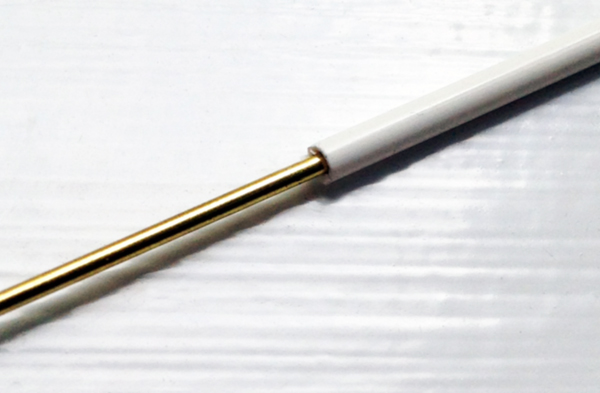

Anyway here is what I did here. I just put a thin brass rod inside a smallish diameter styrene tube.
ROD IN TUBE -
Simple enough and these are pretty much off the shelf common items.

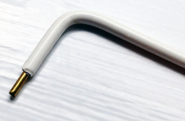

CUSTOM ROLL CAGE -
The nice part is how ever you bend it, the tube retains that bent shape. You can even leave a little brass rod exposed and 'pin' it into another roll bar with a small hole bored out with the tip of an exacto knife - and a dab of glue makes it look like a welded bead - sometimes things just work out!
