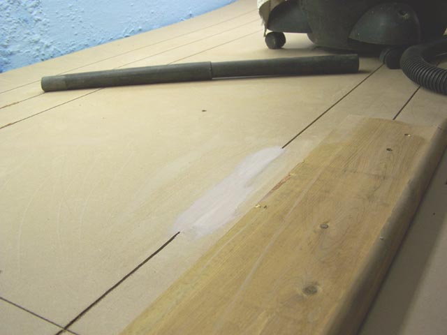

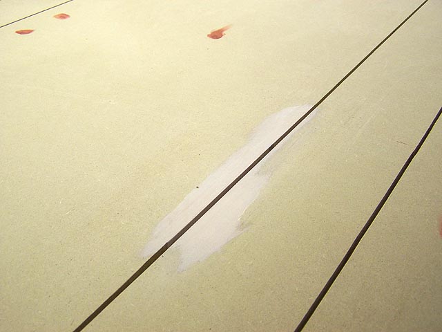

My 4 decades plus of woodworking makes me a fan to Durham's Rock Hard. But it isn't universal. For slot repair I go only to plain old Bondo, for the slippery surface left for the guide to bear on. Careful routing will make very gratifying results right through a Bondo repair, especially if you follow up with a #120 sandpaper wrapped around a plastic putty spade, the kind used for auto body work (Harry uses an emery board wrapped with #120). So, to reinforce a slot when you go into a curve, Bondo is great, and its smooth, making for a faster track, the exact same way as Harry is using to ease the joint in the slot for his track.
Like Harry says, this isn't news to a lot of us, but for anyone who is watching this thread for important advice, pay attention, because Harry is being inclusive of everyone.
Re: Rebuilding The Show-Me Speedway (Lake Show-Me)
Postby HomeRacingWorld » Mon Mar 07, 2016 8:24 pm
Thanks Rob.
Yes, I use Bondo for slot repair. I prefer it as it is smoother, and the drying time is very fast.
Fill the slot and sand the top flush.
And simply route a new one.
HOWEVER...some people do NOT want the smell/fumes of Bondo in the house :)
This is where Durham's works best. It's odor free, so you won't get yelled at for making the house smell like a body shop. :)
Shotgun Dave reminded me of that tonight and is well worth mentioning.
So either product will do the job.
