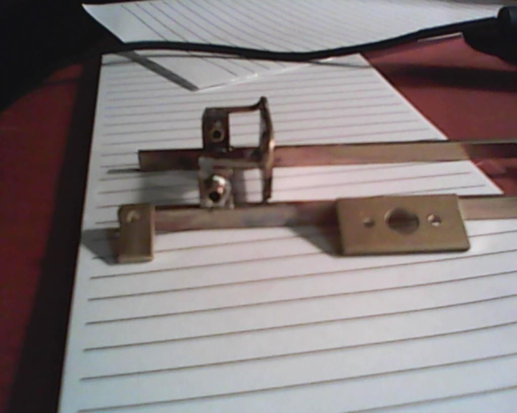

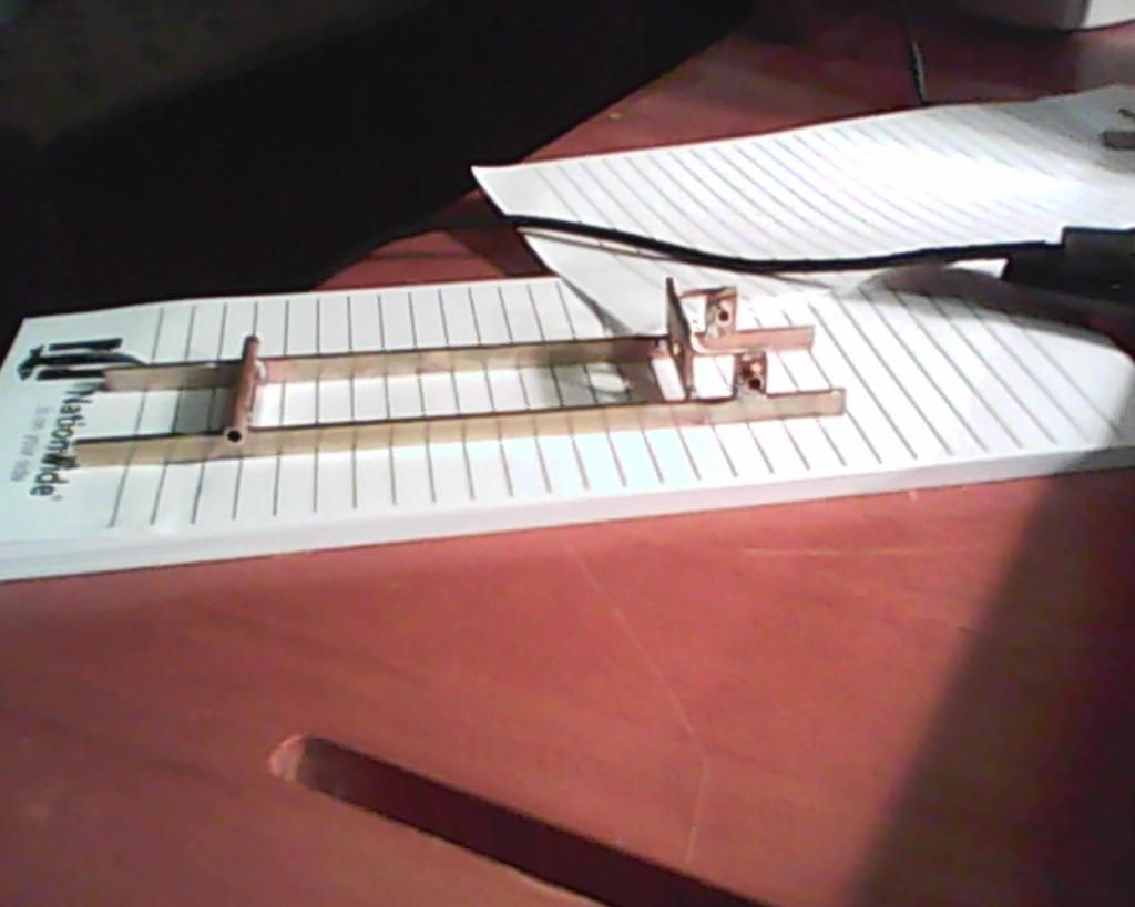

I went with a brass chassis and tried something new
First I got a 1\16" X 1\4" K&S brass bar and cut pieces 7\16" long drilled a 1\8"th hole 3\16 from top center of the 1\4"
Next was some 1\16" X 1\2" and drilled for motor mount
using a small ball end bit in my dremel I cut a slot in some K&S brass tube, the 3\32 X 3\16 for the1\4 tab to fit, connecting the 2 rails is some 1\8th K&S round tube for 3\32 axles
adding the motor mount I then bent some 1\16" rod to run along the top of the motor mount and tabs I then cut out the axle tube
still need to add my body mounts and guide bracket

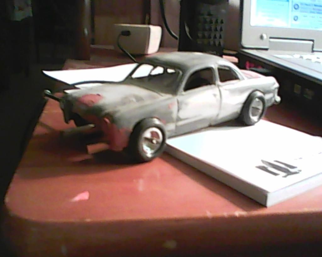

Well you are making a nice chassis there. Nice progress.
Re: 49 Ford Tuder
Postby btaylor » Sun Mar 08, 2015 3:26 am
That car looks great with the wheel wells opened up, Smooth chassis build to Jon, this should be a looker.
