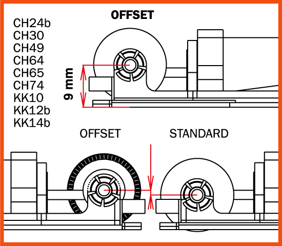

In testing the JK F1/INDY bracket, we know it has a .055" offset. I wasn't sure if an offset crown was really needed so I tested both a standard and offset Slot.it crown. After a few test runs it was clear the offset crown is the better choice. Much smoother gear mesh as expected.
Rest of the chassis is now completed and doing some final test laps.
I also put in a little offset to the motor, but not a lot.
Ok, back to work :)

The offset is the relation of the motor shaft to the axle.
So with this bracket, the motor shaft is .055 lower than dead center.

All of JK's 3/4" wide motor brackets (JK-D3F122)have this offset. Their 1" wide motor brackets are available both with (JK-D322) & without (JK-D321) the offset.
