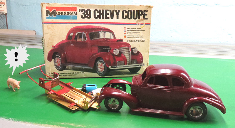

This kit has been around for a while :) I have avoided building it because it was 1/24 and I like 1/25 better.
But I want a bowtie for our new series and this one will fit in regardless.
This project is more of a challenge as I am using old spare parts. I enjoy hammering things back into shape to make them work. Curly is not too happy of course. He does not like some of his favorite toys taken from his yard.
But it had to be done. :)

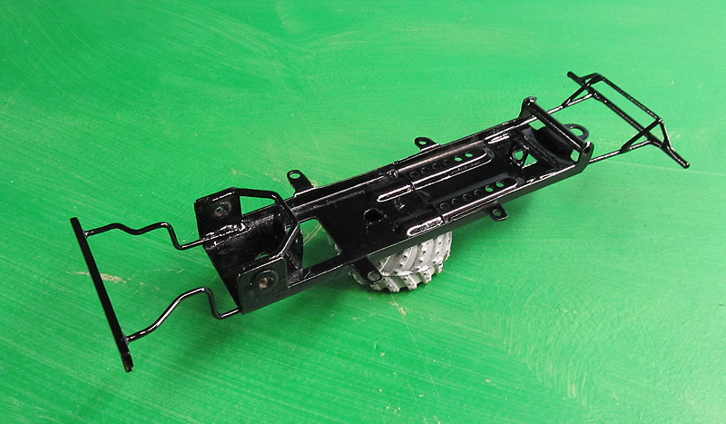

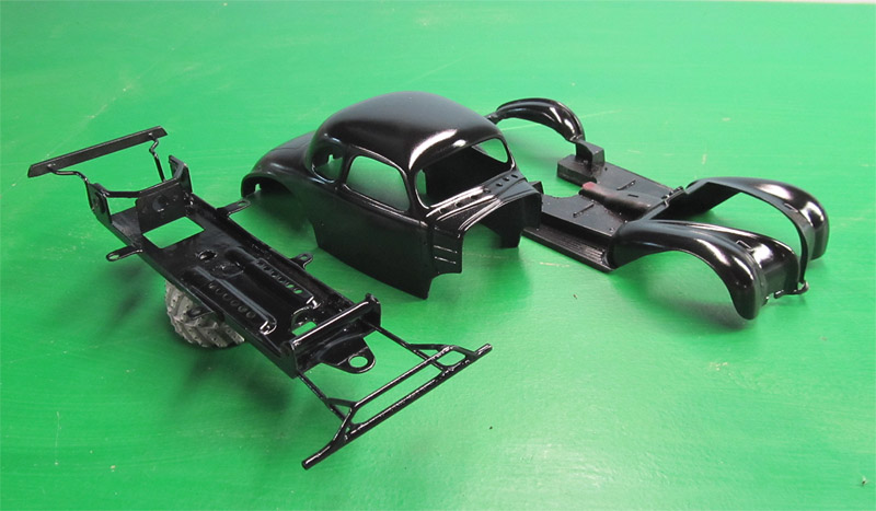

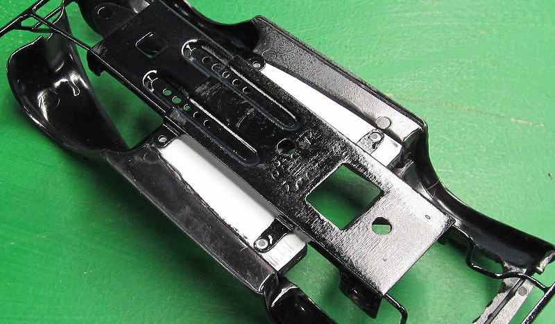

Chassis finished and model painted. Went with classic black. It helps hide my imperfections :)
The chassis was an old one that was cut for a modified so that is the reason for the small tabs.
Still works fine. Used basic rod for the nerf bars, they came out ok.

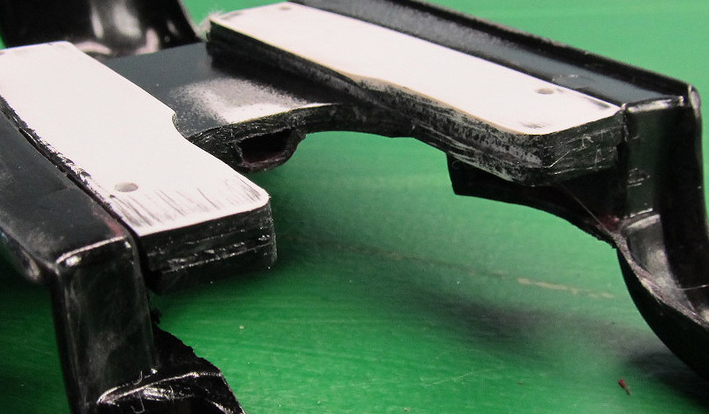

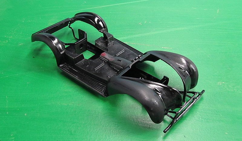

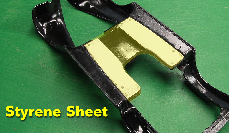

Used styrene sheets to build up the body mount. Since I wanted to keep the running board and fenders for our series, this was a decent way to do it and it worked well.
Took 3 layers. I used standard Testors glue and some mini-clamps.
I used a small bead of hot glue on each side to hold the chassis steady. Then using a pin vise, I hand drilled the holes. Once completed, just use an Exacto knife to trim away the hot glue.

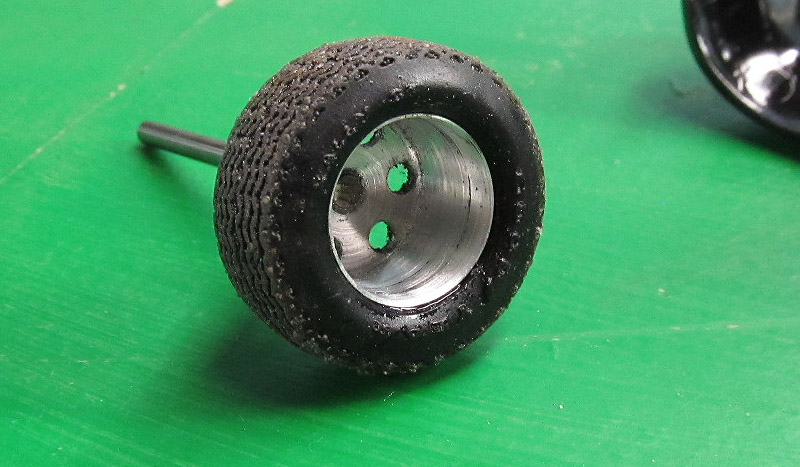

More recycling. Old Pro Track wheels with foam removed and sanded. Paul Gage Jalopy Series tires glued on. I coat the wheel with clear nail polish and then set the tire on and adjust it. Using the nail polish, it allows me time to work with the tire. You add a bead of super glue on the inside and outside edges if you want to once the tire is set.
Hope the mount system helps some of you thinking about building one.

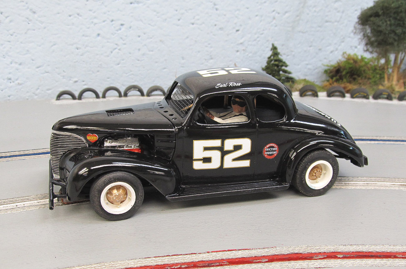

All finished.
Decals are from the scrapbook. Paint is Testors black. Clear is Future.
Big Donkey inserts and Paul Gage Jalopy tires.
Not as purdy as Dixon John's, but it will hunt :)
FUN FUN FUN :)

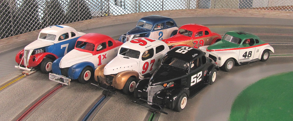

Well, here is a start on the line up:)
Missing a yellow and red car though :)

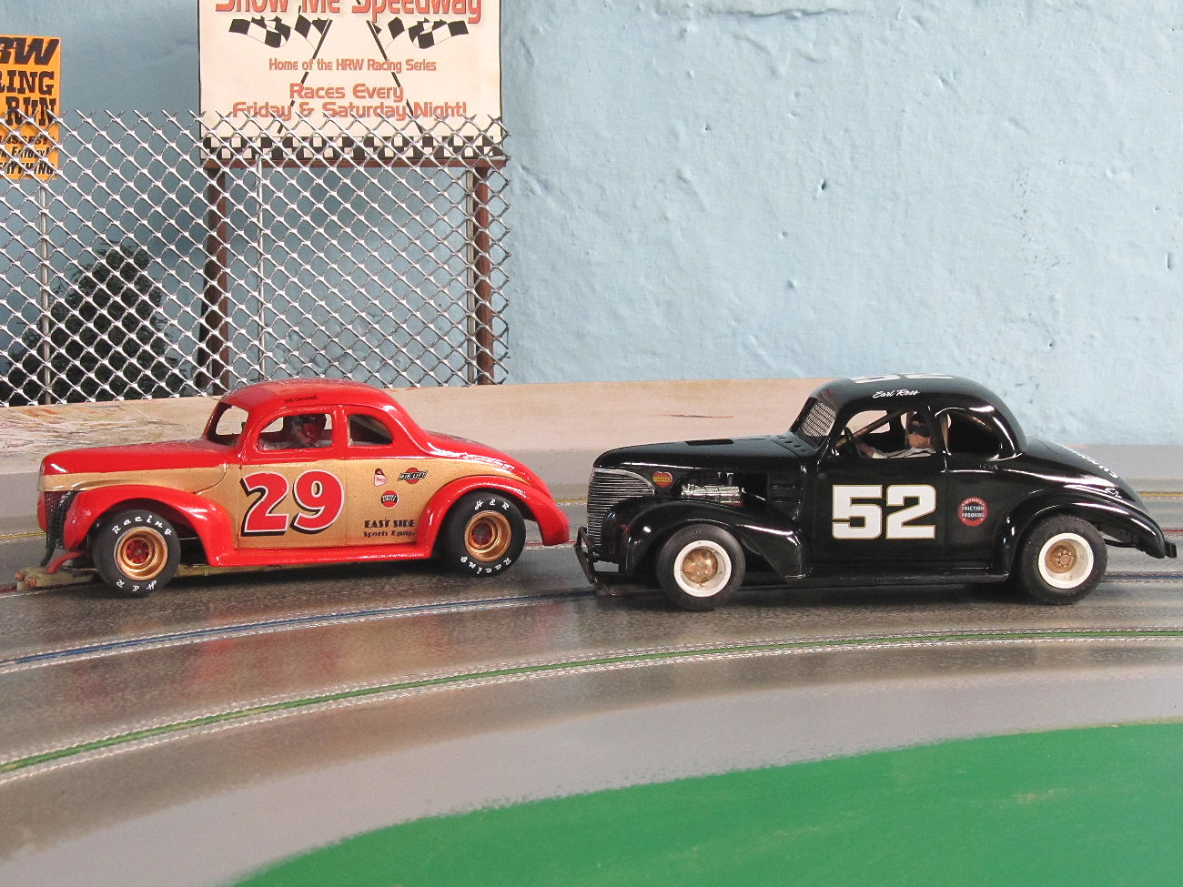

Postby waaytoomuchintothis » Mon Jun 03, 2013 9:00 pm
It made great progress today, Boss. Where did that old Plymouth come from? I don't remember that one.
Re: 39 Chevy - Big Bowtie
Postby HomeRacingWorld » Mon Jun 03, 2013 9:03 pm
Oh yeah, that is one Tom did a month ago. He did some final touches on it this past weekend.
And if course, it's the class of the field :)
