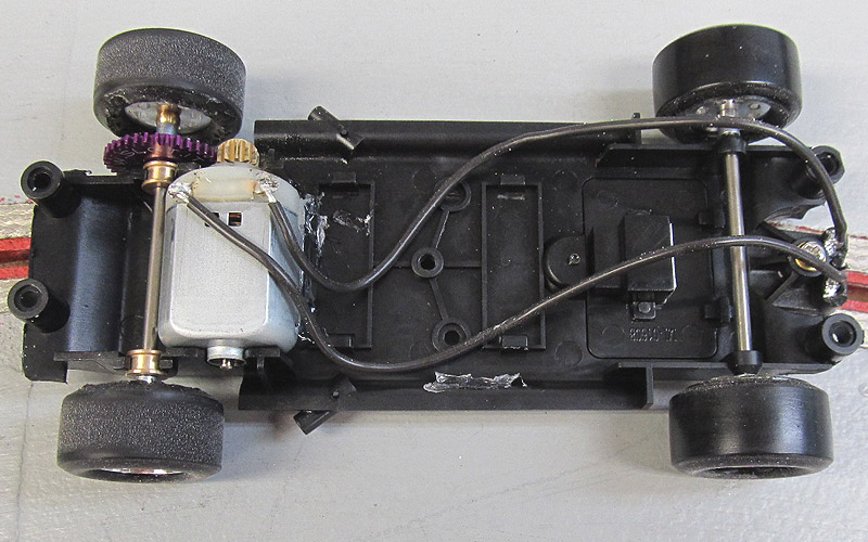

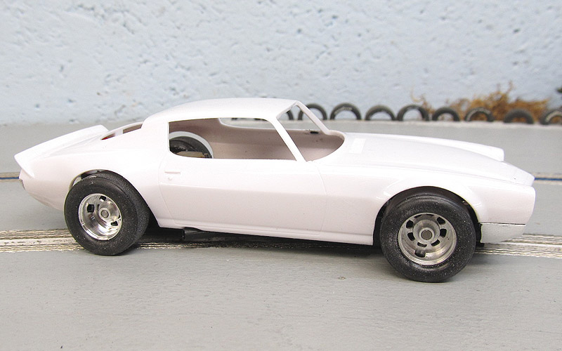

Finally time to work on this project.
Chassis is trimmed a little front and back to release the body parts and then re-attached to get some float action.
Slot.it 11T Pinion, 36T Spur. SCC bushings. Stock motor. SCC C.B. Design 15x8 F-1 wheels and Paul Gage 22125's all the way around.
B-Nova guide plate installed underneath, Slot.it wood guide and SCC tinned copper braid.
Not finished tuning, but we have a roller to work with.
At least we are getting somewhere :)
